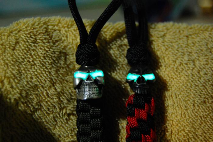

I have to use a tripod to get decent pictures of anything glowing - I took these when trying to show Dahlken's glowing eye beads -
