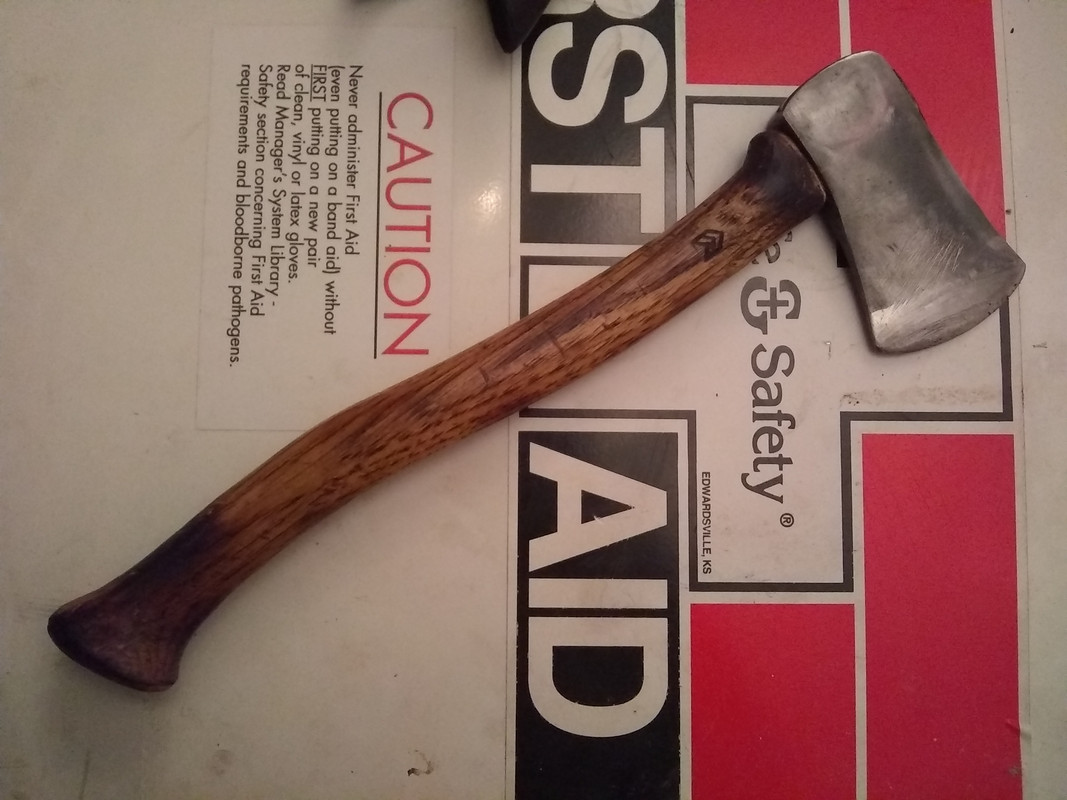

This is a small belt axe made by a friend of mine. It's patterned after the Ft. Miegs or Kentucky belt axe circa 1760 to 1820. The handle w/blade is 12" long and the head is 4 1/2" long by 1 1/2" tall.[im
g]https://i.imgur.com/HvWHmRK.jpg[/img]
Thanks, I think he did a great job on it. It was the first hatchet blade he made. I got the handle from a hardware store and whittled it down to fit. It will see a lot of use come hunting season.
