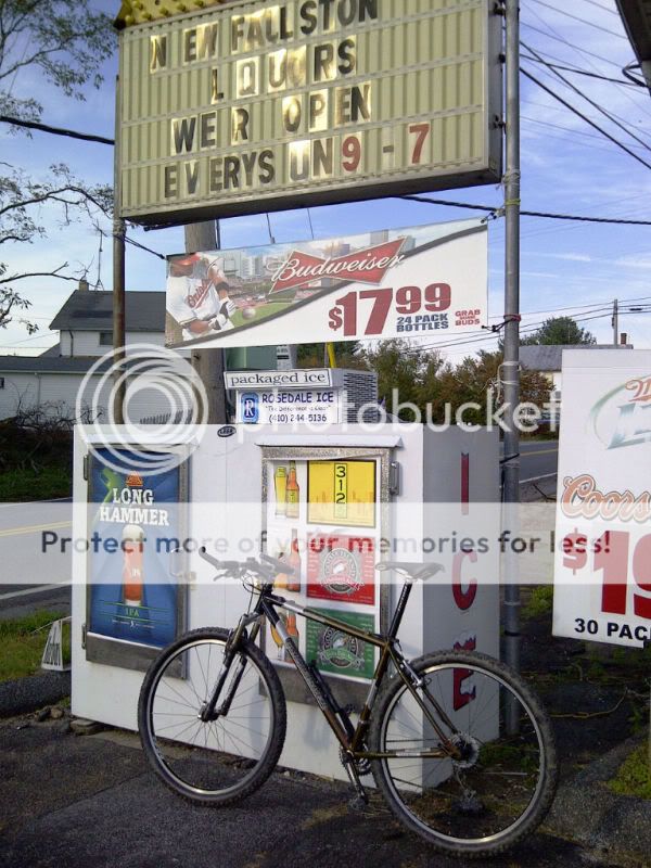

Cell shot of the new seat today.
Its not a miracle but its a lot better in a lot of ways. Satisfied.
That looks nice, what kind of seat is it?
I just wanted to mention that I see in the picture your seat has a pronounced downward tilt to it. While it is enticing to do that because of the perceived protection for your nuts and such, eventually you will feel like you are getting pushed forward onto your handle bars. It will become uncomfortable and will cause fatigue in your wrists/arms/shoulders. You might want to try making it more level. Of course since it's new, you'll probably end up making multiple adjustments (height, fore and aft, and tilt) until you find the optimal position.
Thanks guys. It is angled slightly down. The picture is very distorted though, its not as bad as it seems. Its the Selle Italia Max Flite.
I was riding with my old seat before I got the new yesterday. I was wearing three layers of shorts with my old seat to compensate, it was getting that bad on long seated rides. I think when I go and ride with one pair like I normally would have I will be able to angle the seat back up without all the extra layers getting in the way.
One thing about this seat that is really standout to me is the shape of it. I feel like I can pedal much stronger now, the seat is shaped better to the muscles on the inside of my legs. I don't feel like I am crushing the sides of my seat anymore. It is wider at the rear though. Its a good design. The cutout made a lot of difference too.

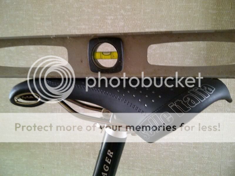

I watched a short video about fore and aft adjustment. It said knee above the pedal at 3 and 9. So I adjusted for that. I then used a level on flat ground for the angle.

Quick question to the guys in the know. Do I want the seat perfectly level to the ground even if there is a drop from saddle to handle bars?
The videos I was finding were very general.
Thanks

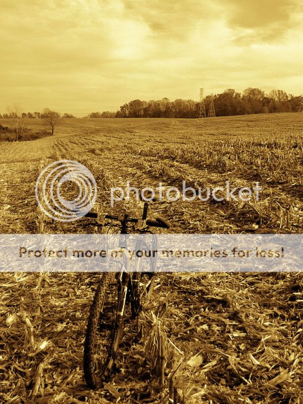

Another cell pic with a cheap cell app sepia effect :-p
Didn't have time so went for a mix of cornfields and road.
It is a major improvement over my old saddle.
Leveling the seat did not make it at all uncomfortable either.
