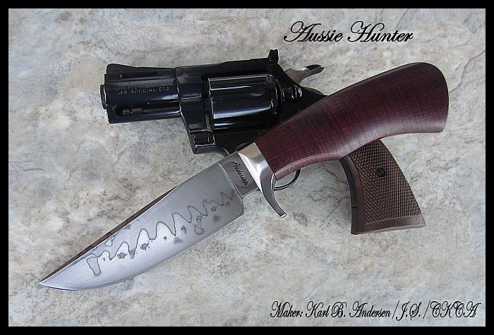

A couple of my better ones:

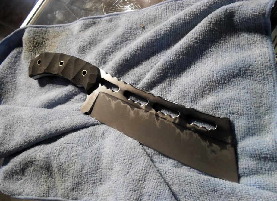

I've always like these hamon shots. This first one is interesting to me as it illustrates the difference between a water quench and a P50 quench.
These are very similar knives in all respects except for the quench medium.. The upper is water, the lower is Parks 50. Each has its own character.

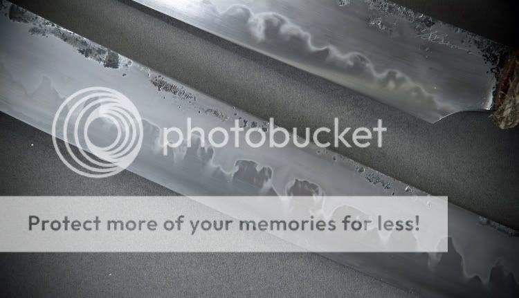

And this one I quite liked.

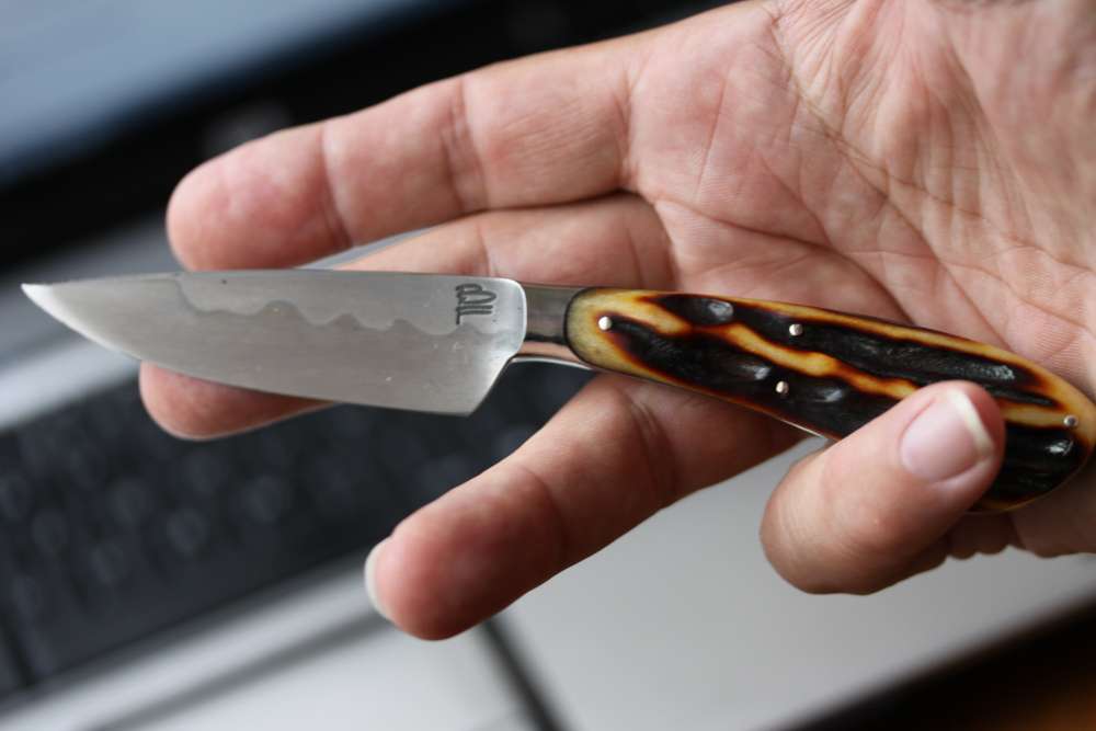

Here are some shots I pulled from my fototime account. There isn't a single one that I didn't feel could be better in some respect... but they still represent a hell of a lot of blood, sweat, and LOTS OF tears. ;) :)
some more...
BTW- just as an fyi, only one of these was water quenched--- the first big "brut de forge" camp knife.
