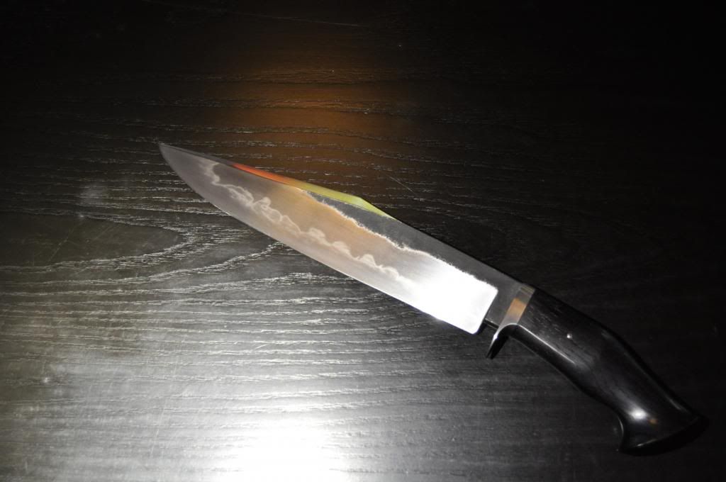

I have one of the knives Nick pictured above that he made for me and his Hamon's are outstanding as well as the heat treat. I have a couple from Matt Lamey that also have a really nice Hamon. Several other blades as well... but unfortunately I can't get to the pics right now. I'll see what I can find later and post them up here.

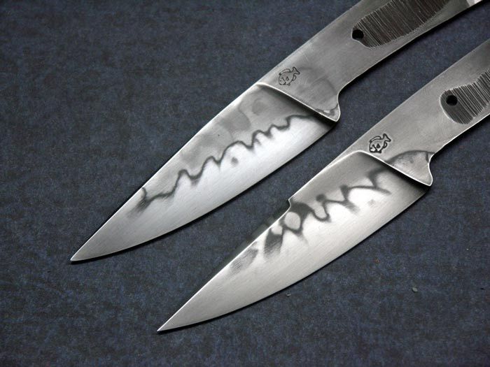

Couple Kyle H is working on now. Kind of weak I know, but cool all the same. ;)
And a couple ones from a few years ago I did.

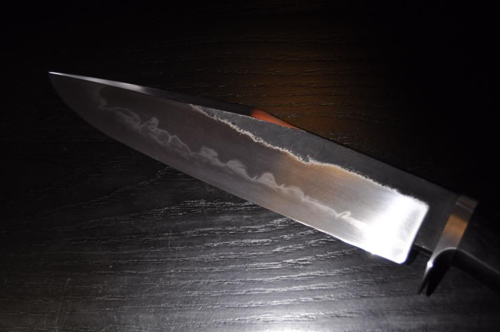

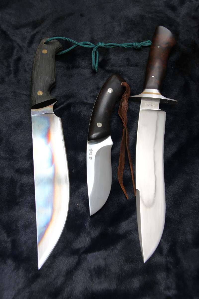

I tried to capture some of these in pics... but I don't have a light box and it's TO HOT to go outside and use natural light right now... These are just a few I could grap in both hands...
One that Nick made for me & pictured above in his post...

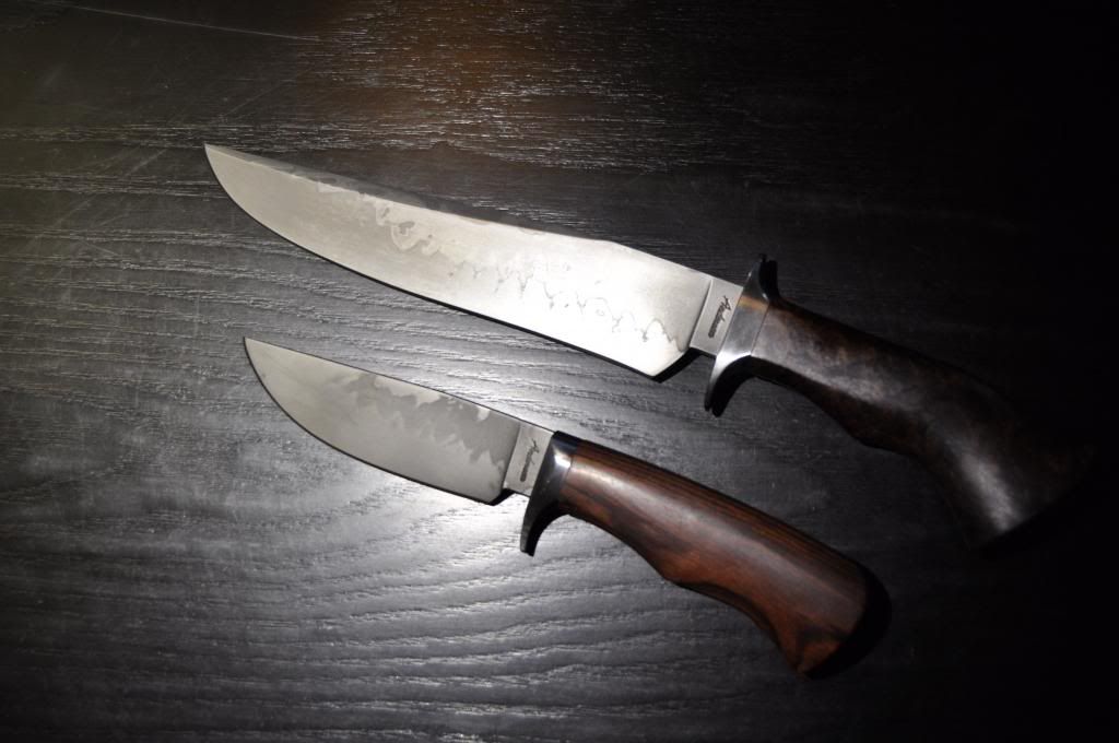

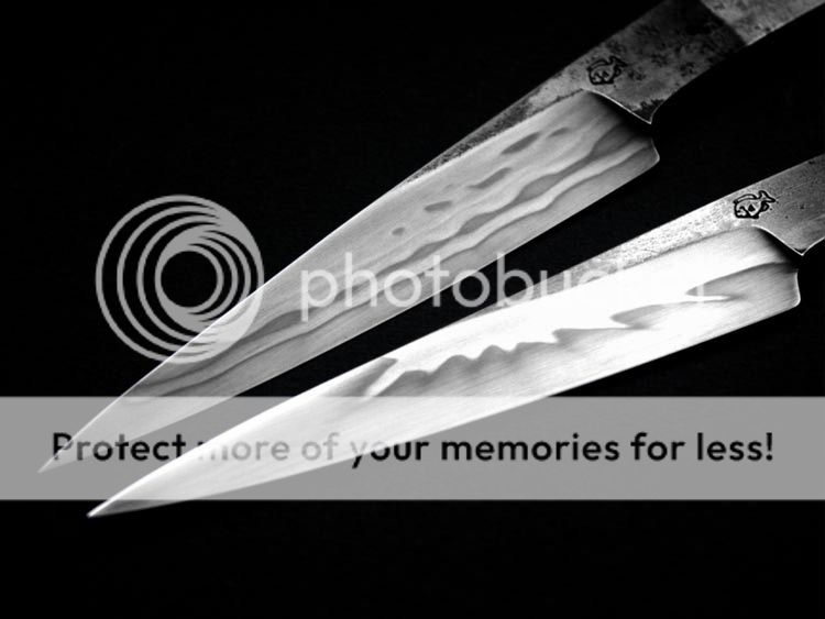

A couple f/ Matt Lamey...

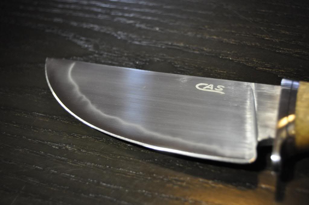

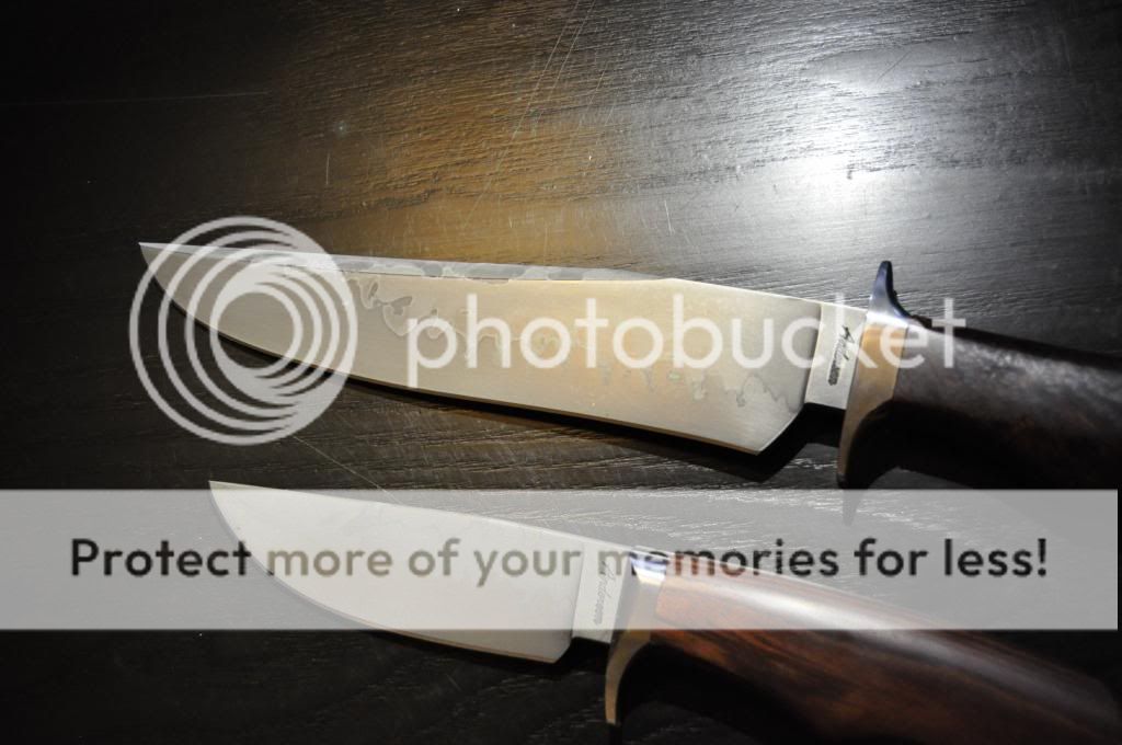

One from CAS...

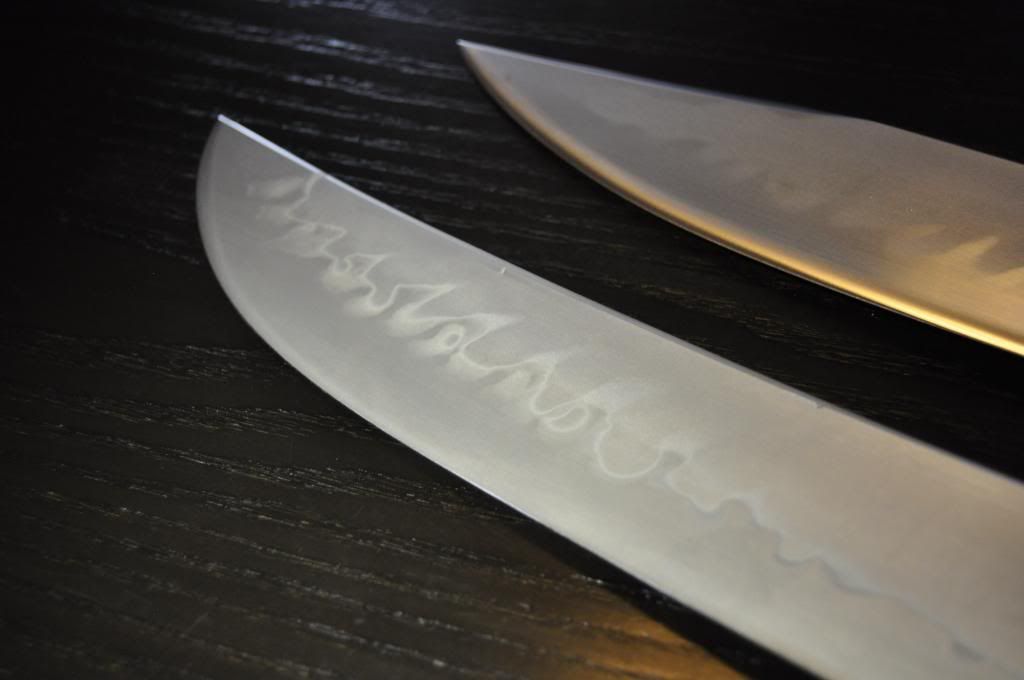

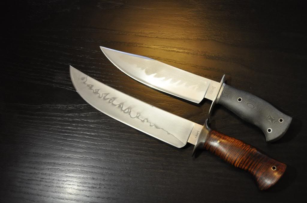

and a couple f/ Karl...
