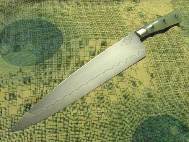

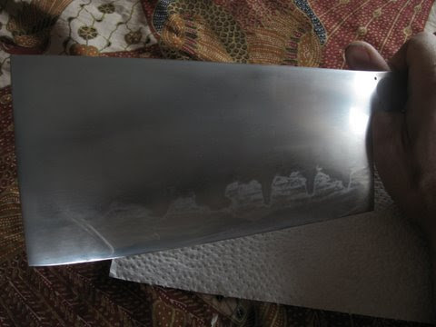

I think a meaningful hamon is applied when a mind carefully considers it's intention. Some are not so meaningful and that's fine. I prefer differentially hardened blades when it comes to carbon steel anyway and pretty is always welcome. For my uses, concepts regarding hamon as in the case of a sword don't generally apply. Wide blades I feel are less effected by many of the traditional concerns as they apply to narrow, optimised weaponry like katana and the like.
The really good ones, though, are those which take into account the performance enhancements which can come with adjusting heat retention during hardening an tempering. Understanding flexibility and hardness and how the twain should meet is where the masters are at.
However, understanding the aesthetic enhancements available is also important, especially if one wants to sell one's knives. Hamon is hawt.
