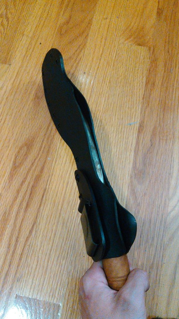

I made a kydex sheath for my KLVUK, came out pretty great if I do say so myself. Waiting on some longer Chicago screws to come in so I can attach the clip plate. I use .093" kydex for most if my sheaths, and used .125" for the plate. The little screws I had will attach a .93" plate no problem, but just couldn't get this one. I'll see if I can't find/take a couple pics of that later.

My order came in yesterday that included the screws for my KLVUK sheath and some more kydex and other supplies for cul's. I grabbed a few pics of the KLVUK when I'd finished. The handle is getting pretty dark from use; you can see a light spot in the last pic, where the sheath wears just a tiny bit.
Excellent job SG! I see you are definitely talented bending that stuff. The finish work is supurb:thumbup: I like the front loading sheaths like that. I like the clip plate as well. Its so much more convenient not having to mess with the belt.

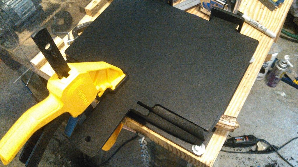

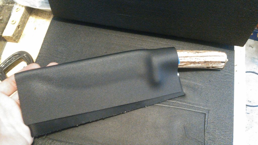

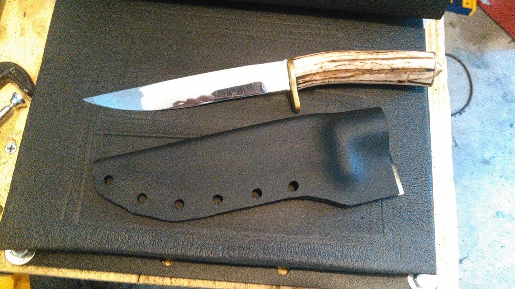

Been very busy lately, but I was able to find scattered time this week to work on sheaths. I started on the Western, thinking it would be easier than the bowie. Took lots of pictures throughout, and those tell a good story by themselves. Keep in mind, I'm my own camera man, so not too many action shots here.
Here's what's happened so far:

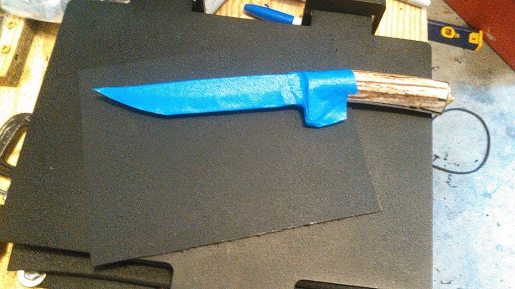

Started by taping the blade with thermoform tape, and cutting a piece of kydex to size

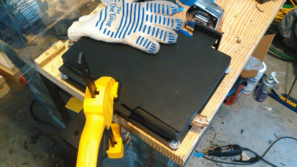

Next I heat the kydex with the help of my trusty heat gun and hot glove. I put it on wood and let the corners overhang, to look for the coveted "cheeseburger effect" as I've seen it called. This is when the corners start to droop, like cheese on a good burger. I think y'all know what I'm talking bout.
Then the knife gets folded in and pressed for 10-15 min. This is the stressful part as you wait to see if it came out alright, or if you have to reheat and press again. I always hate that since heating with the heat gun takes 5-6 min for just a small piece..
The moment of truth...and OK! The fold isn't perfect, but it looks usable since that will be cut/ground off.

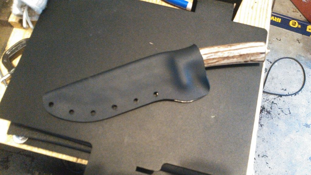

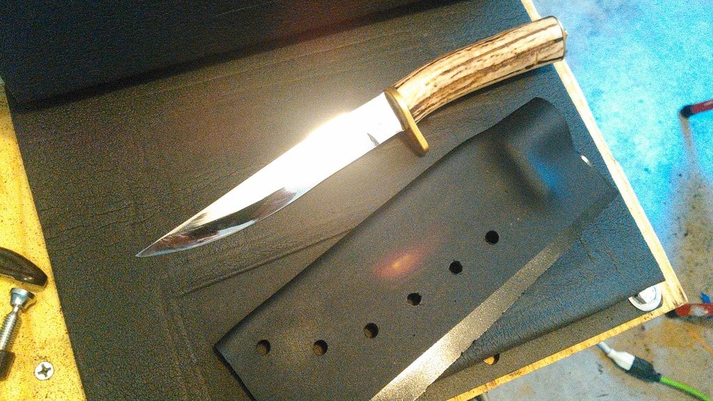

I change the order of the next couple steps sometimes, but this time I drilled holes next.
Rough cut with the coping saw
Then coarse grit on the belt to round/smooth edges

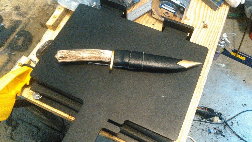

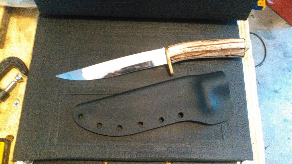

Next, I gently heated the kydex by the top, to make a lip for the gaurd. After this step, like every step, I put the knife in to test the fit. Much to my dismay, the blade wobbled significantly after the removal of some kydex by the handle. Not good. In a hail mary attempt to fix it, I heated one side of the sheath and pressed again.
And it's a no go. Holes didn't line up, as expected, but more importantly, the blade still wobbled. Unfortunately, this one is headed to the scrap pile.
I should have mire time this weekend to start anew. On my next go, I will do a sandwich design rather than foldover, and I will only tape the handle, not the blade.

Now that was interesting. Thanks for the explanations and pics. Hmmm...I'll need to try it one day. After this tutoring, I may give it a go.
Truth to tell, it looked good to me, but then I'm not there to experience the wobble, good try nonetheless! I'm sure your "try" would be way better than any try I would undertake...lol
I never drill the holes until I have the perfect or best fit I can get. I have drilled like one hole and installed the grommet loosely to hold that position for the multiple trips back to the oven or under the heat gun.
It can be frustrating trying to get that perfect fit, the snap in, snap out fit.
Seems you get it right in one place and lose it in another, back and forth.
Probably could be saved with time and or certainly used for something smaller. Seems even the little scrap pieces can be used for something.
