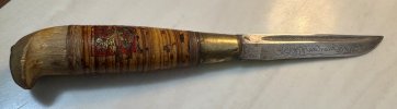

Thank you for the advice and information! I may go the epoxy route then.The ferrule is a thin sheet of formed brass that was originally filled with whats called brimstone, or molten sulphur, to secure it in place. Thats going to be hard to fix without destroying the knife. You'd need to pull the handle apart, and with a knife as old is this chances are some of the stacked bark pieces will crumble. The cost of getting it fixed would probably far exceed its value anyhow. Best bet might be to mix up some epoxy and brass dust, and fill it in as best as you can. Or, just leave it as is.
The maker is Luomanen & Kumpp in Kauhava

You did a good restoration!I ended up doing a good amount of maintenance on my puuko I posted yesterday. I epoxied in and around the crack and where the tang meets the ferule. I also sanded the peeling lacquer off the butt of the knife and finished it with a few coats of mineral oil. Lastly I sharpened and stropped the blade, sadly this wore away a bit of the Kauhava mark.
I also replaced the broken hanger on the sheath and cleaned and waxed the sheath to protect it.
This little project has turned out what is now one of my favorite fixed blades!
Thanks again for the help!
