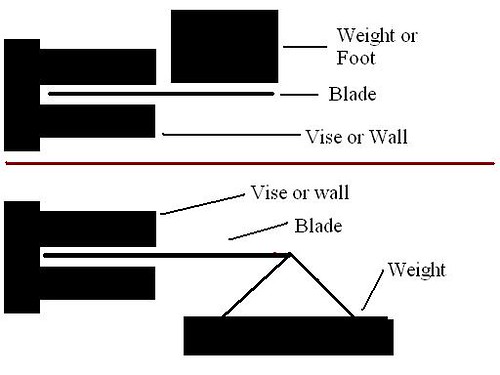

Shearing and bending are both closely related aspects of the application of force on an object.
Take a stick in your hands, or a candy bar. gripping it tightly in each hand with your hands close together, hold it in front of you and move one hand up and the other down, the bar will break in half, thats shear. now hold another bar by each end and move each hand together, twisting them, and the bar will bend into a U. that is bending or torque.
the application of force over the distance travelled. appempting to bend the knife with the device 1/2" from the lip of the vise where the radius of the curve is small will be harder and apply more stress to the blade than attaching the device 3" from lip of the vise and attempting to bend it.
Heres a poorly drawn MSPaint picture I hope will give an idea of the different types of force acting on the screwdriver in the wall or the blade in the tree as opposed to a weight hung off the tang in a vice or levering against the sarter cap in a car.
With the screwdriver in the wall and blade in the tree, the weight is (usually) applied over a foot width, with the inner edge close to the wall/tree so the force is concentrated in a small area and is mostly attempting to cause the blade to move down square to the wall or tree.
In the second view, with the weight at the end of the tang, the force is acting along the entie length of the exposed blade to curve it. causing a bend

So based on what you have told me...
If I were to try to test my blade by sticking it in a vise and then standing on it with part of my boot resting on the blade very close to the vise, I might not be putting the same type of force to the blade as if I were to use my torque wrench tool and tried to bend the knife?
Correct?
The torque wrench is applying a force aimed at bending the blade whereas standing on the blade might be shear force.
Correct?
Alan, I've been following this and haven't had anything to add until now. I hope this is of value.
Torque is a combination of force times distance, from point of rotation. So 40 lbs of force at 1.5 ft = 60 ft lbs.
In your test, I can see that maybe your wrench was attached at 4" or so above the vise (point of rotation). Let's assume in your test that your wrench was 1.5 ft long and it was attached 6" from the vise (point of rotation). Then we would have 40 lbs of force at 2 ft which would be 80 ft lbs.
In the case of knife in a tree, it is possible to put the force so close to the blade that the result is more shear than torque. I know if I were to step on a knife in a tree, I'd put the pressure close to the tree, thereby reducing the torque.
I can also see that a wrench attached closely to the vise might make the blade bend sharper than it really wanted to. Does that affect anything? I really don't know, but it's interesting to get all this input.
Correct?
Correct?
yep and yep.
take the candy bar comparision, one is like the foot on the knife while it's in the vise, leadign to a snapped candy bar. a knife is far stronger and doesn't break so easily, but it's the same principle. then take the torque wrench, it's measuring how much turning force is being applied to bend the knife, like the candy bar.
take as an example a journeyman smith test knife with a 6" blade, 1/8" thick. the fixed points are the vise gripping point, 2" from the tip, and the guard of the handle since the scales/bolster/lever is supporting the tang. so to make a 90 degree ben, so the tip of the knife is vertical in the vise and the handle is horizonal, theres 4" of knife blade forming a 90 degree arc of a circle, for a radius of about ([SIZE=".5"]umm... some maths help here... D = PiR2, the arc is 4", so diameter is 18", square root both sides to get 4 = PiR so R must equal approx 1.3[/SIZE]) 1.3"
someone better check my maths :P it's been a long time since i failed maths last
the same 1/8" thick steel in an arc of 90 degrees with a .5" radius would be far more likely to fail due to the increased stess of making the turn far sharper.
IF your ultimate goal is to make a blade that will take a lot of extreme leverage without snapping then have you considered other alternatives which may be as good or even an improvement.?
