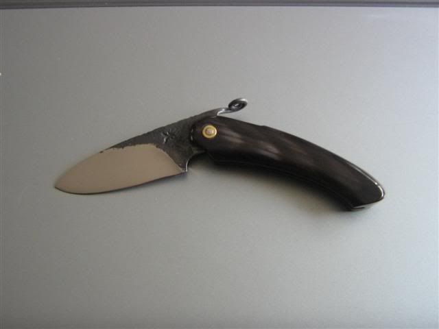

Anyhow,Here's a Tomes trapper,forged 52100,I was down in the kitchen this morning & snapped this one :

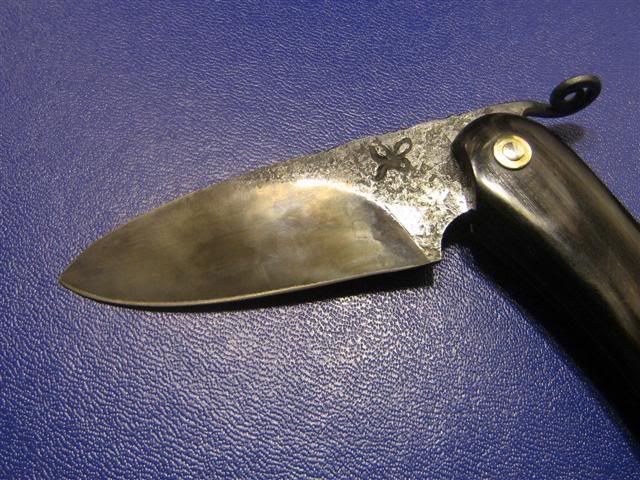

By midday,I had it set up with a red lead (watch the Sopranos) induced patina :

I've had good luck taking carbon steel knives that get that blotchy, unappealing "pre-patina" and rubbing them down with a Miracle Cloth. If you rub too much you'll take the patina clean off - but a little rubbing evens things out and results in nice dull gray.
mnblade is so right,& that's exactly what I've been doing,but I use a soft cloth
You can even out the patina,you get a different look,on different steel & finishes every time
Here are the same two knives after a clean up rub down
It seems the more you use them & clean them up,they take on an even patina easier.Logical,I know,but it is cool to get the knife to have that "broke in" look

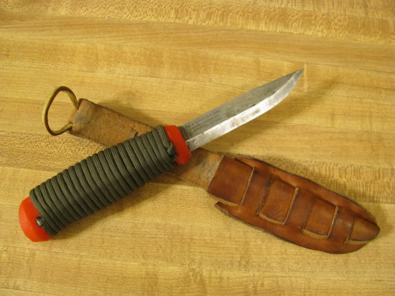

I like that look too..This is my EDC. I wouldn't mind having a couple others in 52100 with this patina..I never paid much attention to blade material until I started reading up on it and then Blues turned me on to the 52100..It holds a super sharp long lasting edge..R

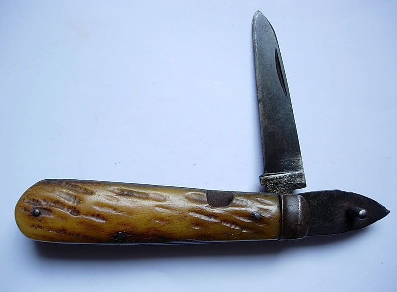

Exactly!. That's the way to do it. Jackknife says he doesn't like the stages in between from start to finish and so he gives his a head start. And to each his own.. I am just the opposite in that regard.. I love the blueish, purplish, grayish colored swirl patterns that remind me of a cold winters day outdoors. The kind you get from good honest use each time you cut into an apple for a quick snack or whittling into damp wood for some chore or another.. This '74 Case 6202 1/2 comes to mind.
I got this one full of rust and had to clean and sand it back shiny again so I could start over. An its getting there slowly but surely.
Forcing a patina feels the same to me as buying preworn hats, with the visors all torn up.
I like to use it and then whatever patina forms, that's that.

...This is my EDC. I wouldn't mind having a couple others in 52100 with this patina..I never paid much attention to blade material until I started reading up on it and then Blues turned me on to the 52100..It holds a super sharp long lasting edge..R
Randy,
I'm glad you're enjoying that beauty of a knife and I'm not surprised that you've learned to love 52100 as many of us have. It's a great steel (especially when forged imho).
