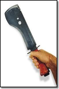

As for your Ugly Stick - I really like the 4th version:
It would be great if the front part of the blade will have bigger angle for chopping than the end, which is used more for carving.
Also the saw on the spine is useless, but it was discussed several pages ago.
I would rather left one "hook-hole" (really don't know the exact word) for taking off pot from fire. I would also remove "glass-breaker" - it will be more convenient for handling in chopping mode. I have my BK-2 2nd gen with this breaker - I would prefer to use this knife without it - glass-breaker is making very uncomfortable grip while chopping when you hold knife only by the end of its handle.
Used KA-BAR Cutlass machete - very good thing! The blade shape is similar to the shape of the stick I mentioned below. But for serious work KA-BAR lacks thikness, few additional mm would be great.
Also 1095 is good for this Stick. Use 1095 CroVan or pure 1095 - is the matter of thinking.
Don't take me serious - I am new to all the knife things & I am in the beginning of my way))
P.S. Sorry for my English, it is not my native language.

Thanks for the response, Camaro, and for the links, too. I will consider your suggestions if I go to a final design. Remember that, even if you're new to knives, it doesn't mean that your suggestions aren't good, so always feel free to comment on any of my designs.
As far as the pommel, it's not really a glass breaker. It serves several other purposes though; it can be used for pounding, but it also provides space for two of the lashing holes, and can be used as a scraper, too.
I agree with you that a pommel extension like that can interfere with swinging the knife for chopping, and if this were just a chopper, I would leave them off. In this case, though, they have other uses.
Yes, the planned steel would be 1095 CroVan, and the thickness would be around 5mm.
Don't worry about your English: it's fine, and you make yourself understood well enough. Your English is certainly far, far better than my Russian, which, sadly, is nonexistent.
