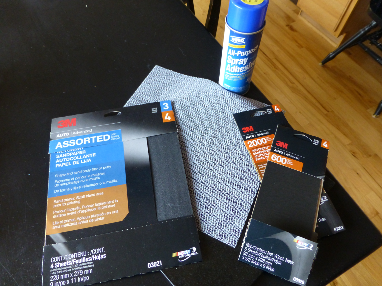

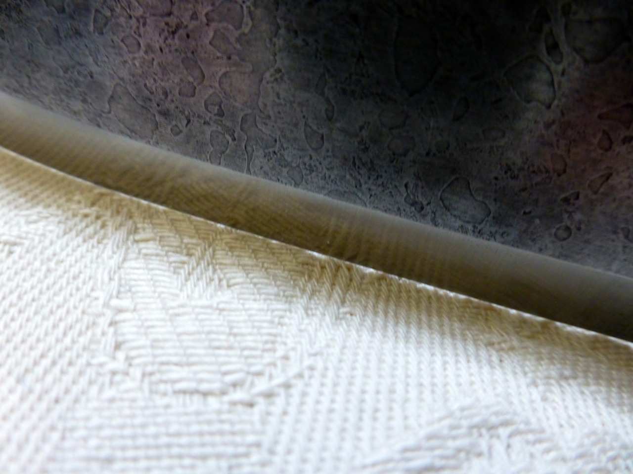

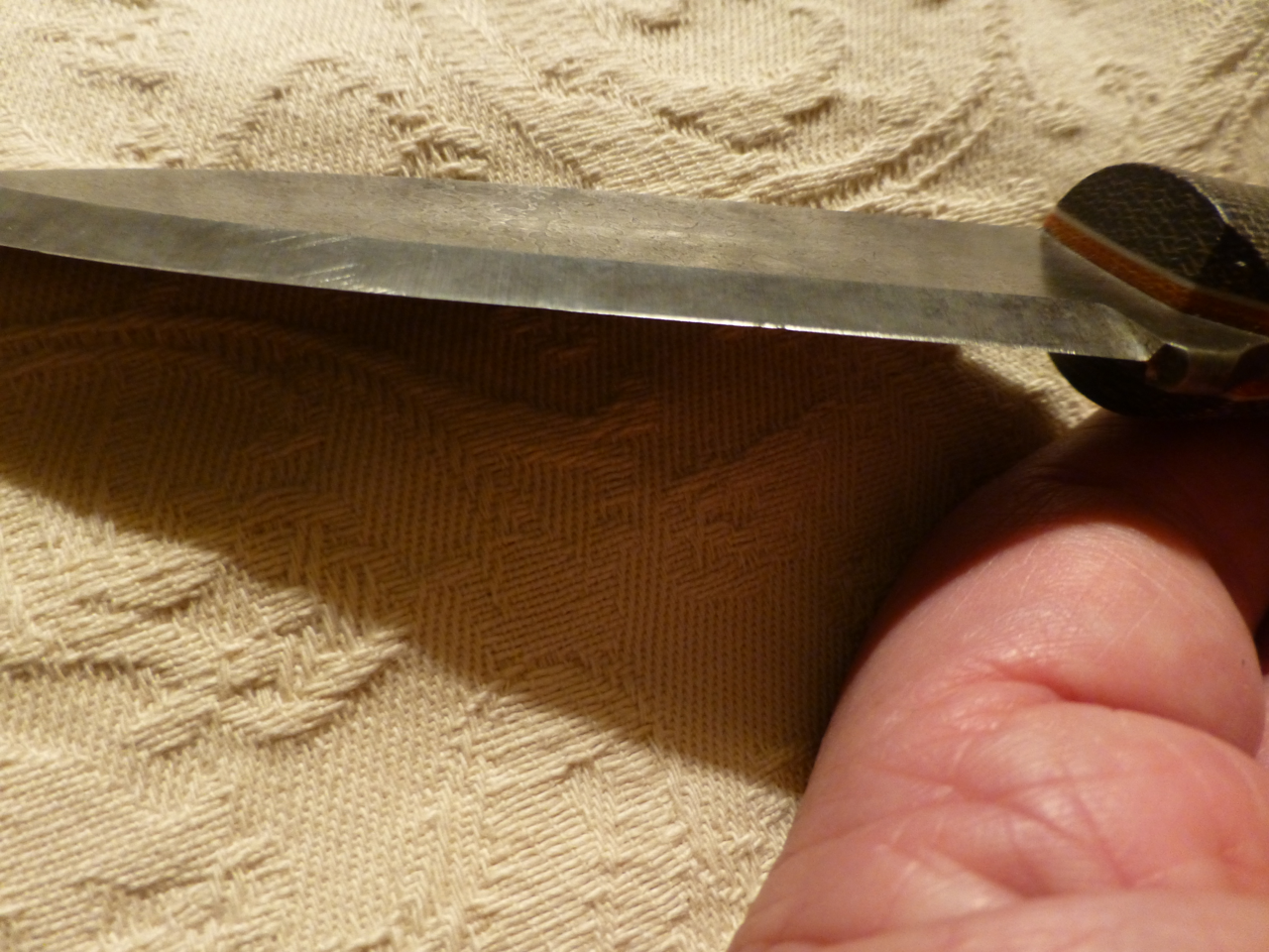

For convex, I use the sandpaper on mousepad method and rely a lot on the sharpie and a jeweler's loupe to make sure I'm getting the edge good. Putting the sandpaper on the strop is another way to handle those convex. Since Fiddlebacks have a secondary bevel (unless it's been removed), the Turley vid is a great reference for finding the right angle and giving good visual clues as to what you're looking for.

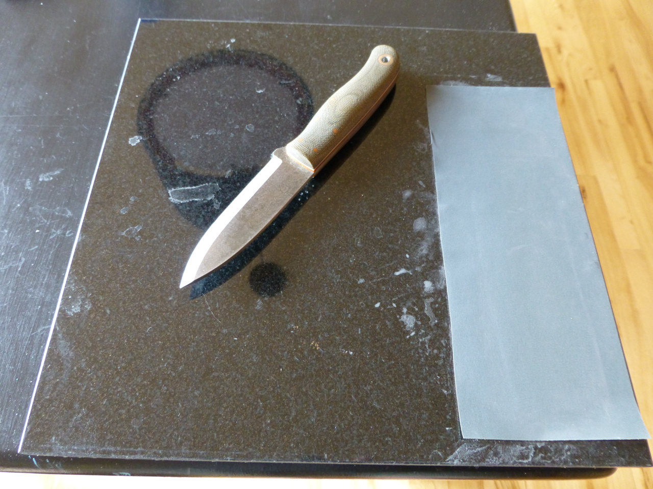

For scandi, you want to maintain the flat bevel and therefore you need a flat, solid base for the sandpaper. I picked up a $5 granite tile at Lowes and put the sandpaper on it. I use one of those rubbery drawer liners underneath the granite to keep it from sliding around on the workbench. Plate glass would also work.

I've found that true zero grind scandi edges can be a little brittle. So I put a very fine micro bevel on with a strop or with the Sharpmaker. I've found this really toughens them up. Hopefully I haven't offended any purists.
