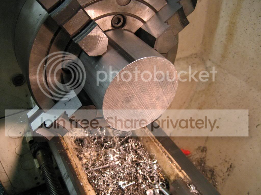

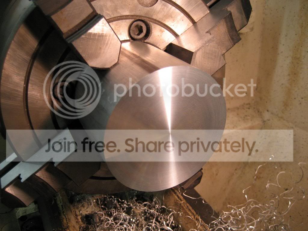

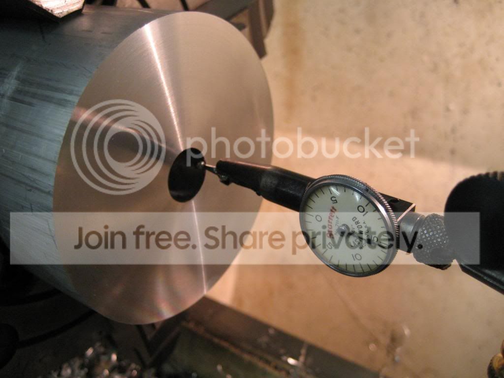

First indicate the slug in the 4 jaw chuck.
Then face it off.

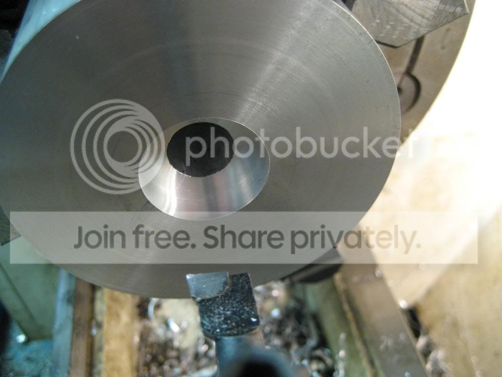

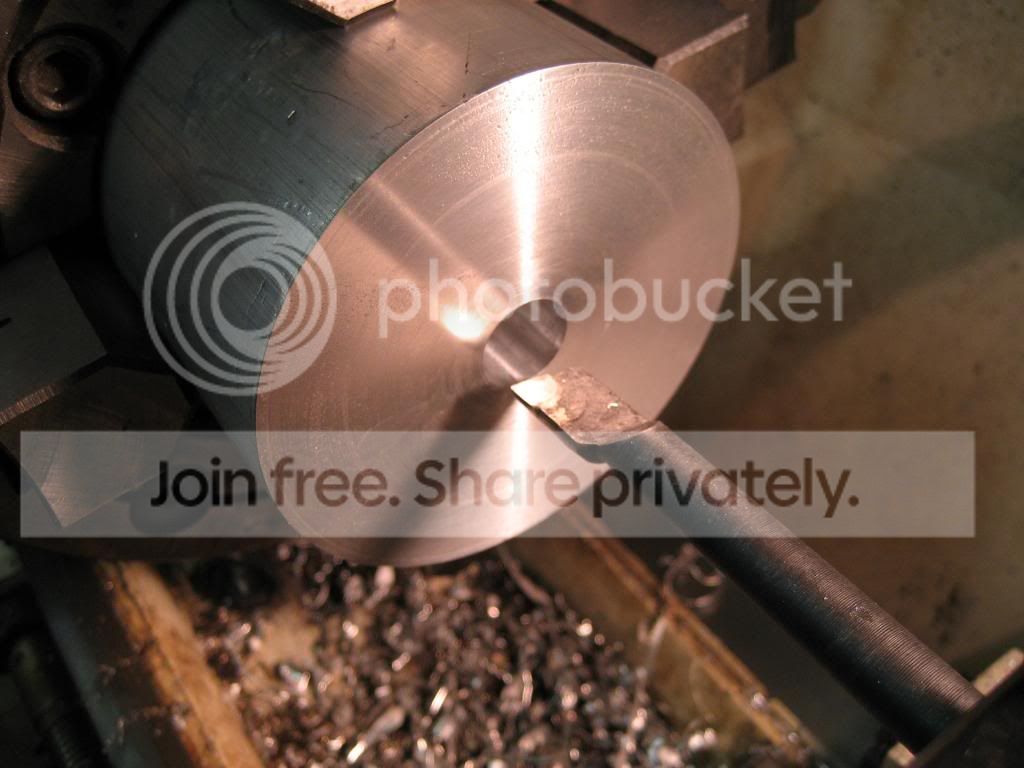

Here I drill it out to .500" and then precisely bore it out to .6248" for a tight fit for a mandrel.
While it is set up on the 4 jaw chuck I bore the bearing pocket.

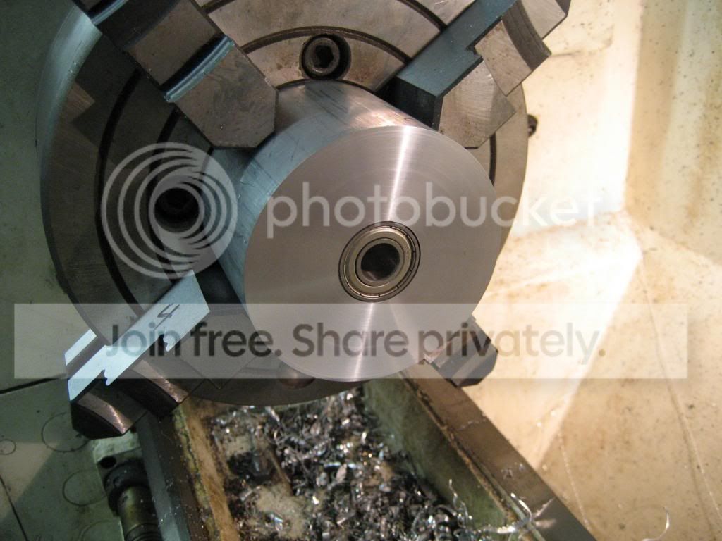

After turning the bore and one bearing pocket I turn the billet of 6061 around and remount it in the 4 jaw chuck indicating it precisely off of the bore.

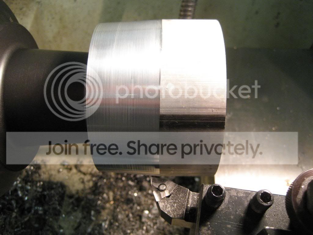

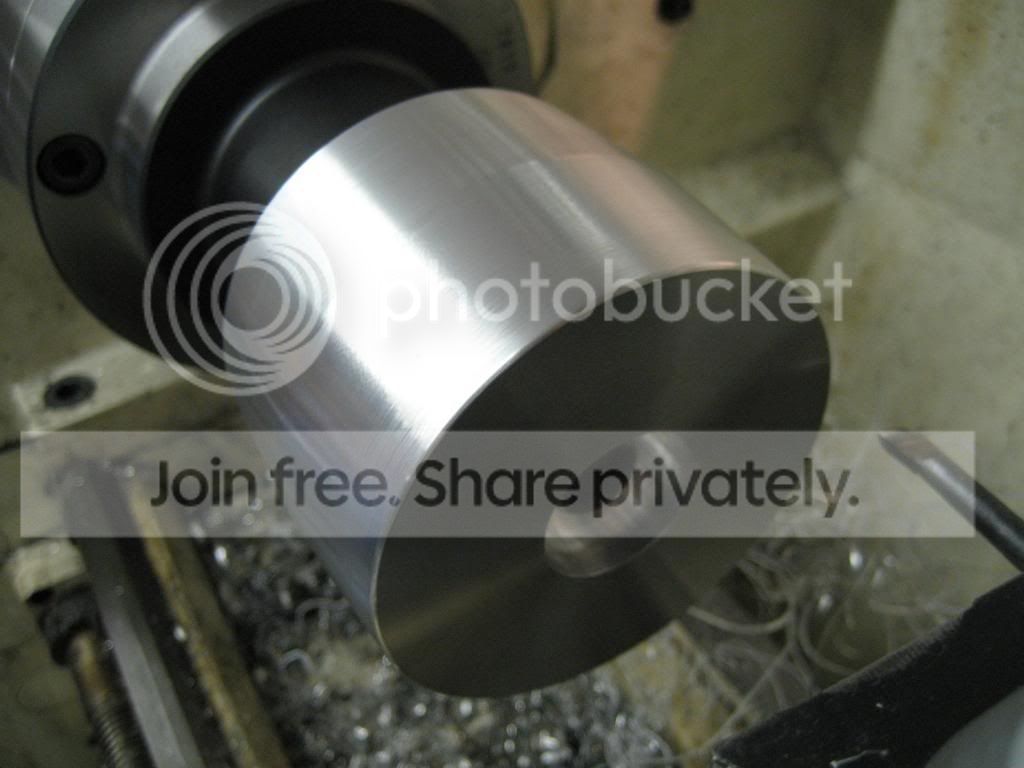

The wheel is then moulted on a precise friction fit arbor in a Bison Set-Tru 5C Collet Chuck with Hardinge collet. The compound ios set to 3.5 degree for a 7 degree included angle. I took light cuts as I did this without the tailstock. The reason I did not use the tailstock is that I made the first taper cut in the front with the spindle in forward and then took the other cut in the back with the spindle in reverse. So there would be no way to use the tailstock. However this setup is plenty ridged for tuning aluminum.
Here is a shot of the finished wheel. You can see the small boring bar used to turn from the backside.

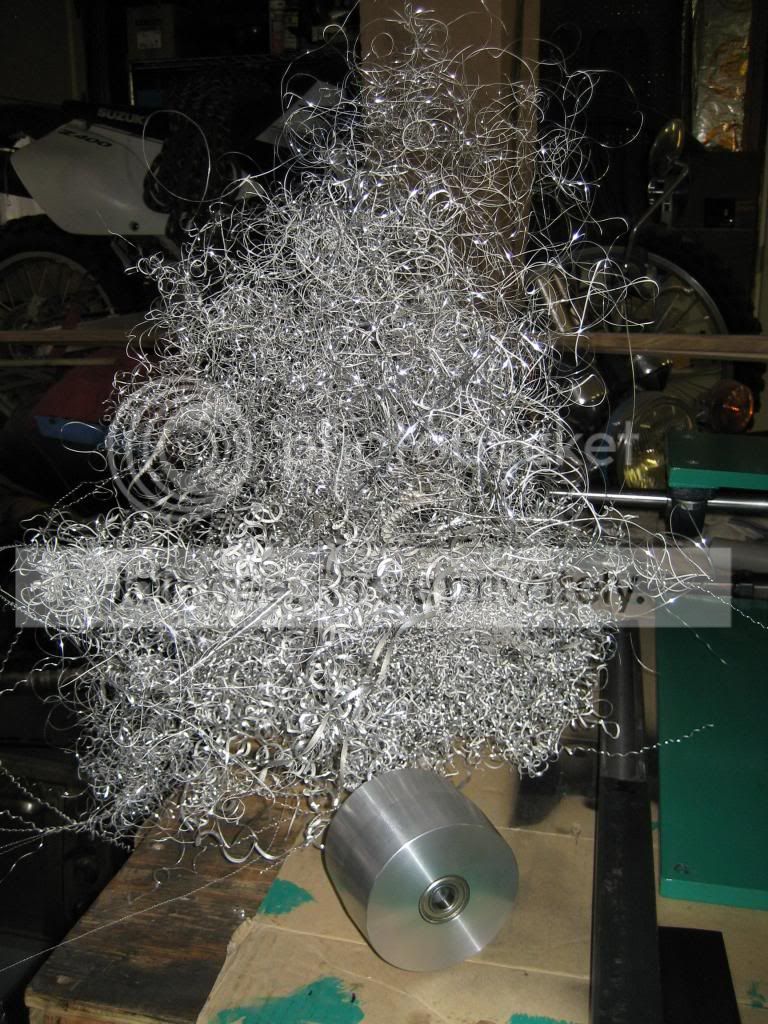

Here is the finished wheel with the rats nest of chips that come off of it. As you can tell, if you are a machinist, I was not using a indexable carbide inset for aluminum, thus the long chips that are common on a manual machine.
That is it. One finished tracking wheel ready for mounting.

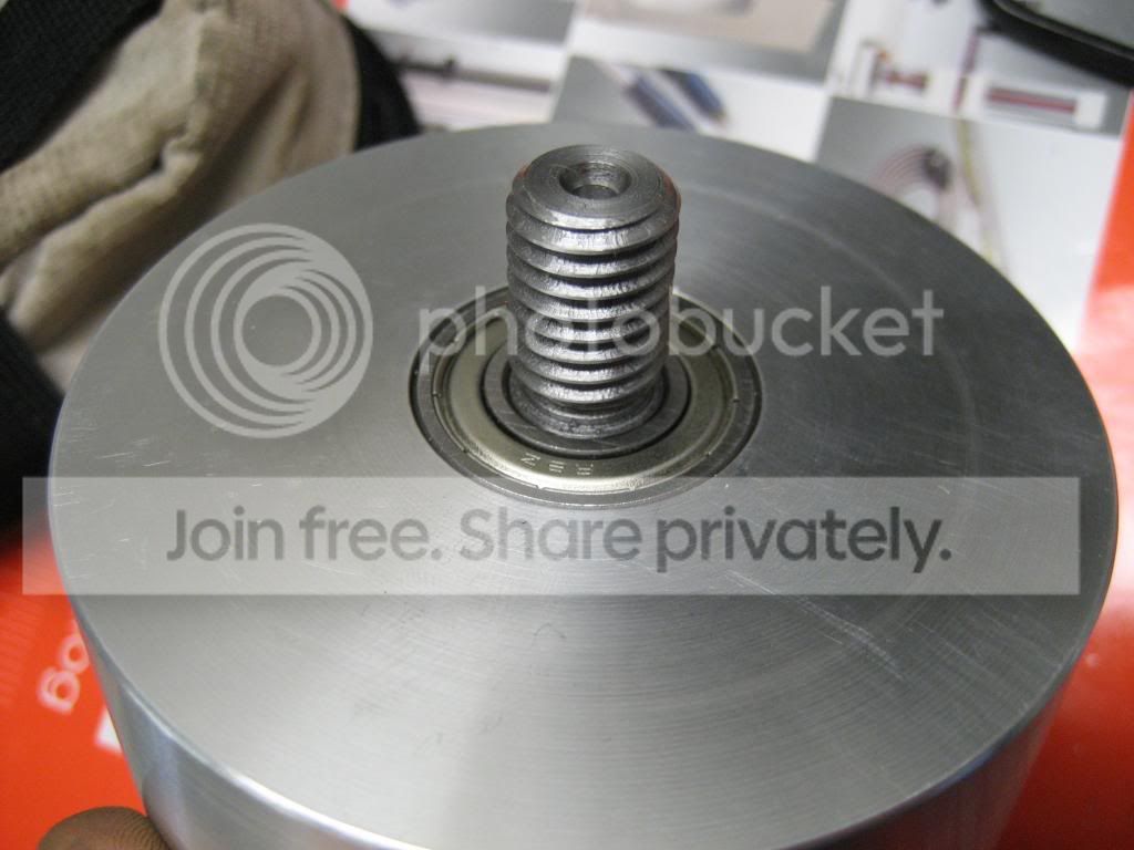

Next I needed a way to mount the tracking wheel. I could have done it the easy way and used a 1/2 in bolt, but where would be the fun in that. So I went about turning a special flange bolt type of thing. I suppose this is a new type of bolt as I have never seen something like this before.

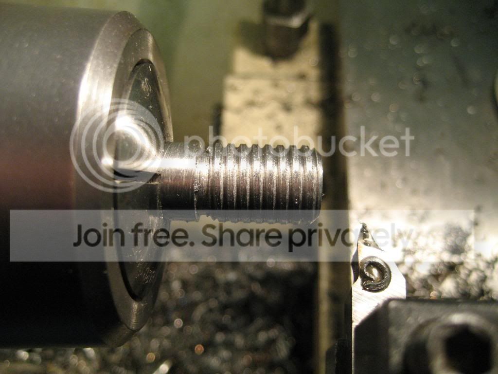

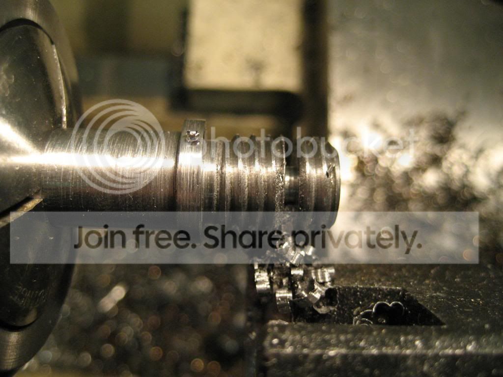

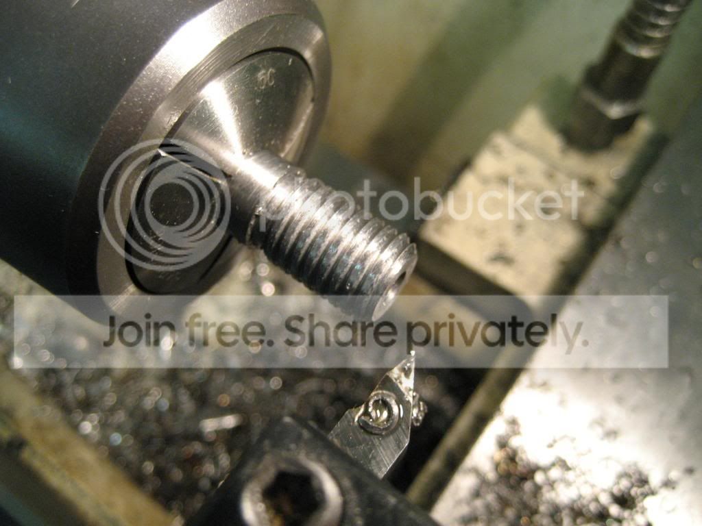

I did not take pictures of the initial process, but I Started out with a .625" A36 rod (5/8" rod) and turned it between centers to .500" (1/2") up to a shoulder. Then I single point threaded both ends. Here are the initial cuts threading one end. Not sure why I did not take a final thread picture.
This end was threaded and then parted off to .375" to thread flush into the .375" hinge arm.

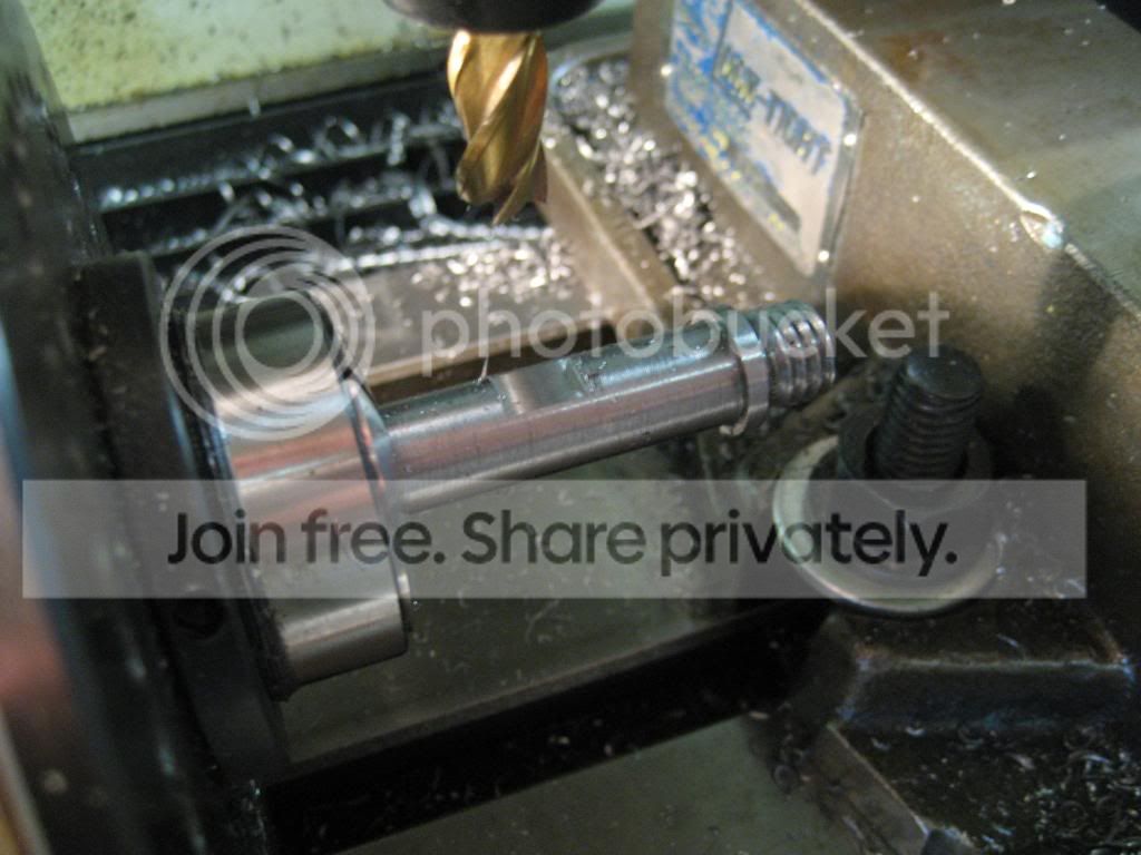

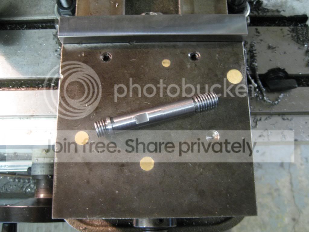

Then I put the bolt into a spin indexer and milled two flats for a wrench.

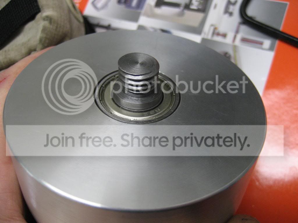

Here is the finished bolt. It has a few scratches on the .500" diameter smooth part as I was just working fast on this to get it done. All in all probably took about 20-30 minutes with set ups while demonstrating the process to my father while he was here visiting.

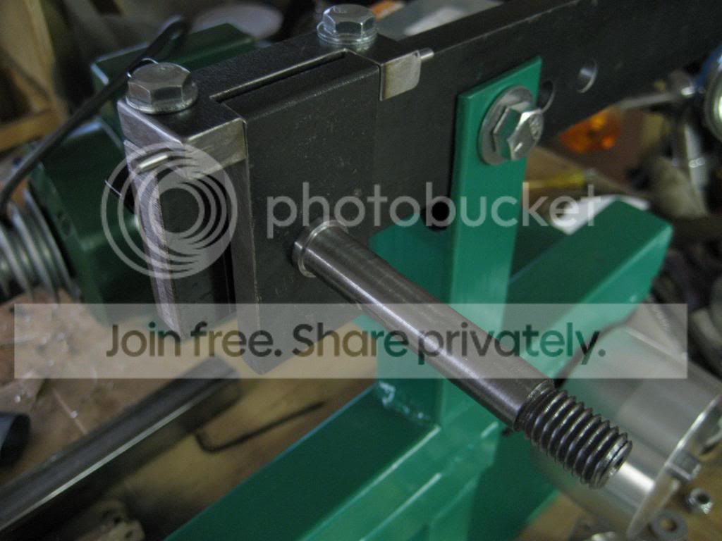

This is how it looks on the wheel with the flange on one side and the threaded end on the other for a lock nut.
And last but not leas the bolt mounted on the hinge.
How about grinding a chipbreaker into your tool ?
As far as I can tell, it forces the chip into a tighter curl, which breaks off.
fiddling with the rake angles may do the same thing.
I've got some bits that work and some that don't, I just try to copy the ones that work.
