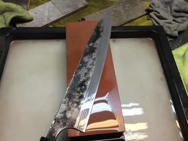

Here is some sharpening work I have for tonight/tomorrow....
WOW Jason, looks like you have your work cut out for you!! I don't envy you fixing the gyuto!!
Tell me about it, lol. This 1111 was reground below .02" and I pushed it too hard, also rippled the primary prior:

Man that blow out is CRAZY! Did you fix it? I think it is best to set your edge angle first, and get that dialed in, then after you know what your edge can handle regrind the primary to thin it out, but I generally stay at least .030" thick for choppers, most of the time .035-.040" at 15 dps.
