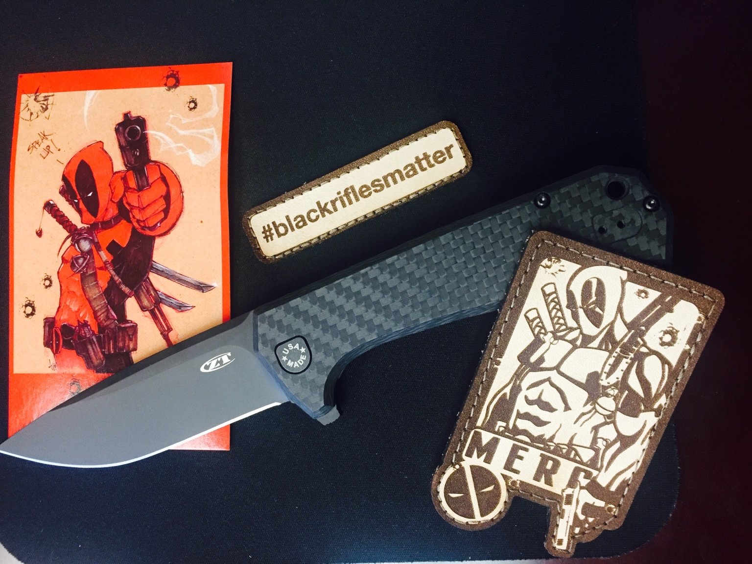

The ZT no one is talking about! ZT0804CF
I love the 804cf.. I am not crazy about the DLC coated blade, but my main issue the cost. I think it is 80-100$ over priced.
It'd be about $60-$80 less if they used titanium instead of CF, steel instead of titanium clip, S35VN instead of 204P and no DLC. So, it's priced right.
