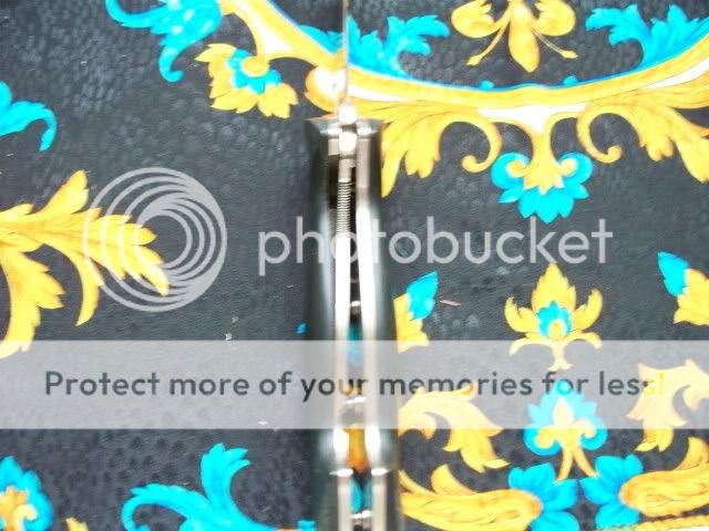

on a well built knife i have no fear of either failing on me here is a comparison pick of the framelock of a zt 550 (thanks again chris) and the locking liner of the spyderco gb. both are stout and beastly 004.jpg006.jpg007.jpg
