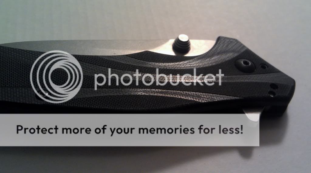

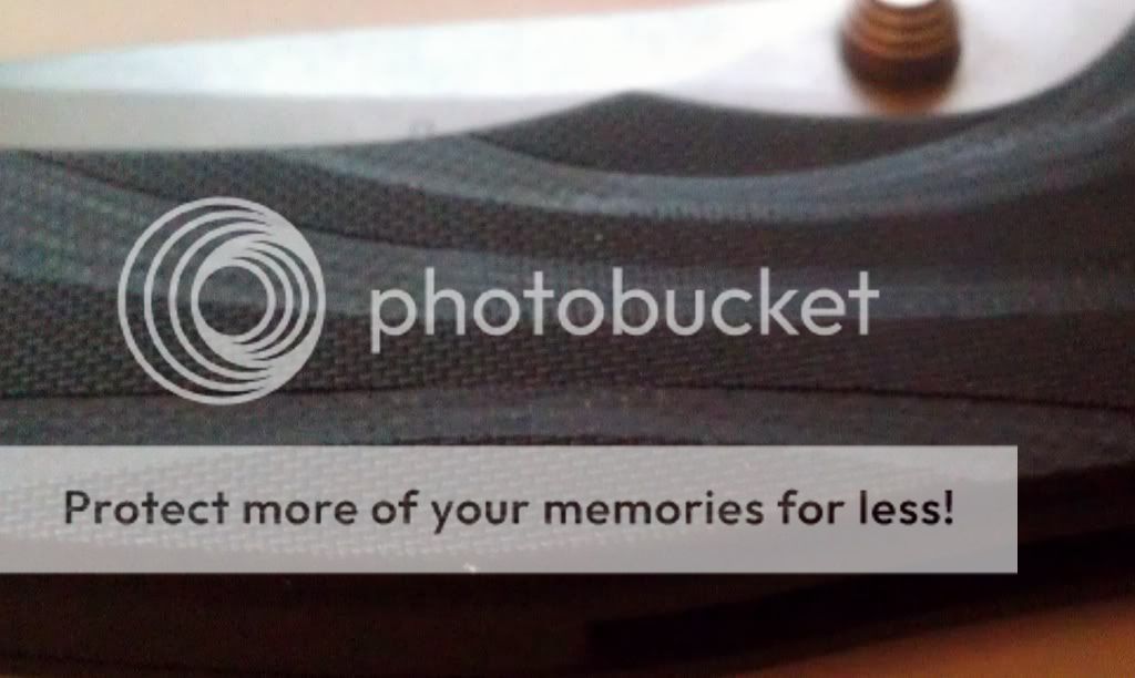

My first concern is the pocket on the backside of the left scale, which contains the hidden half-liner (for reinforcement). The internal pocket was machined first before the decorative milling on the outside. After the internal pocket was machined, the G10 went convex due to its own internal stresses. That left a visible area on the outside of the knife where the decorative milling was not able to cut deeply enough due to the dip in the material.
I measured the the decorative grooves with my depth micrometer, and the average depth throughout the outside of the knife body is between 0.0045 and 0.0055 inches. The depth in the center of the depression is 0.001 inches. When you have a decorative groove that is only 0.005 deep, a 0.004 difference is quite significant. If the warpage had been any worse, the decorative milling wouldn't have even made it through the texture portion of the G10 sheet.
It is very visible in any light, and from any angle. It was a bit disturbing for me, because I usually expect nothing less than perfection from Kershaw. This is what I would consider a rather amateur mistake in machining. I don't mean that to insult the fine American workers in Kershaw's factory, but if this was in my shop, I certainly would have cut the decorative detail before milling the underside pocket, and destabilizing the material. Additionally, if the underside pocket is cut last, it ensures that its dimensions won't be affected by changes that occur after the decorative detail is added on the other side.

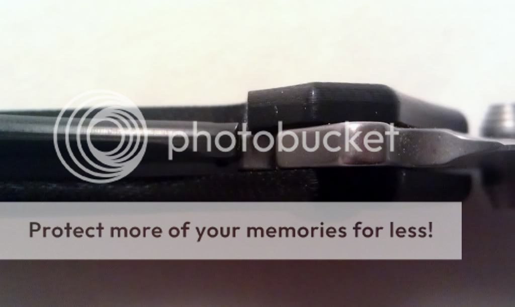

This knife is designed to be as lightweight and slim as possible, and so has very limited liners under the G10 scales. Because of this, the front of the knife where the pivot resides, is very unstable. By pinching the lower front of the scales together (with firm but not excessive force), I am able to expand the gap between the scales at the stop pin, from 0.1445", to 0.1650". In a resting closed position (without squeezing the bottom front of the scales), I am able to close the gap from 0.1530" to 0.1445" by pinching the top of the scales. In a resting position, the stop pin has just over 0.010" of lateral play, as well as roughly 0.001" of play in the scales (which is well within reason, we're talking a synthetic composite material here, although G10 is very strong, it does have limited mechanical stability).
The flex in the front of the knife is severe enough that if a right hander is using the knife, gentle pressure is enough to cause the scale to rub the blade as it is opening. Slightly firmer pressure will actually prevent the blade from fully opening. It takes very little pressure to cause the scale to touch the blade.
After opening the blade, the lock has roughly 50% engagement.
Gently wiggling the blade causes the engagement to set to somewhere around 70%
A very gentle squeeze will set the lock all the way against the opposite scale. This concerns me, because as the lock breaks in, it will eventually cease to tightly engage the blade. I don't see full lock failure as a serious possibility, but it still is disturbing. I don't like the idea of significant blade play in the future. I'm especially concerned with the combination of this, and the relatively loose, small diameter lock pin that is supported solely in G10, with no metal liner support.

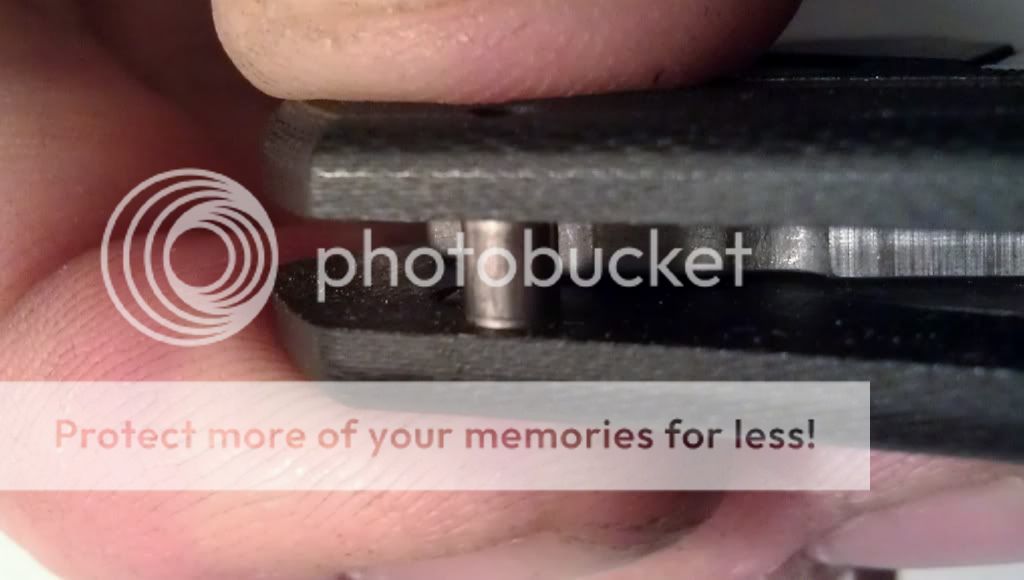

I just wanted to add that the degree of the warpage on the left scale can be seen clearly in the last three pics that I was using to illustrate the lock engagement.
If you look at the lock side (top in photo) you can see the approx 0.015" gap which is "normal". If you look at the other side (bottom in photo) you can see the the lower section of the scale is almost touching the blade, and the gap tapers up to the matching 0.015" as seen on the other side.
The best I can tell is that the scale that houses the half-liner is warped approx. 0.009" across an inch, due to the stresses let loose from the material removal, combined with the lack of stability from the very thin area which is attempting to support the portion of the scale near the finger guard. The opposite scale is straight and parallel to the blade, whereas that scale warps down towards the blade as you move farther from the top of the knife. By the time you reach the bottom of the scale, the gap to the blade is only a few thousandths at most, which is why it is so easy to get the scale to rub on the blade during opening. It's already pretty much touching.
edit: I also wanted to mention, the pivot screw is properly adjusted, so the excessive movement shown above in the stop pin illustrations is from the scales flexing, not from a loose pivot screw allowing the scales to move freely.
edit edit: I also also wanted to mention, that if the scale was not warped, and the depression of the half-liner was not visible externally on the decorative machining, It would be a lot easier for me to overlook the other issues I mentioned. If you look at the knife in profile, and then look at the overall thickness of the knife, it's quite impressive. What's even more impressive, is how the knife feels in hand. It carries like a slim gentleman's knife, but feels in hand like a robust tactical knife (as long as you don't expect to play rough with it).
