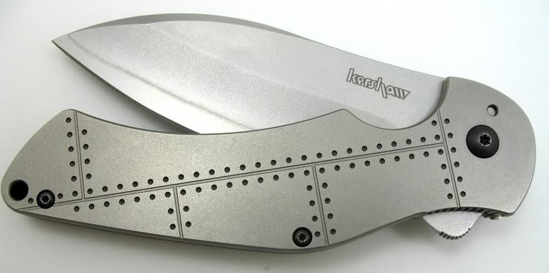

I'm curious about the grind ... was there a particular reason, SG-2/laminate perhaps, that dictated changing from the high flat grind of the regular model?
Well when we flat ground the SG2, you couldn't see the laminate. So we had to hollow grind it to fully expose the 2 steels. I will say it is nice and thin with the hollow grind, but not quite as sexy.
I think they both look good, though might like to see the hollow grind run up a little higher, closer to the spine.
The "rivet pattern" on the Ti handle looks especially nice, BTW.

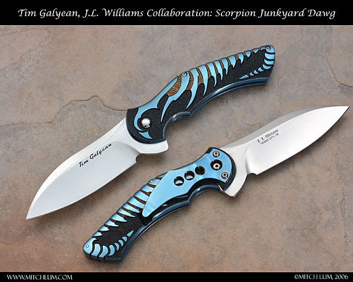

Thought I would throw one more JYD II out there, this one was a collab. with Lee.

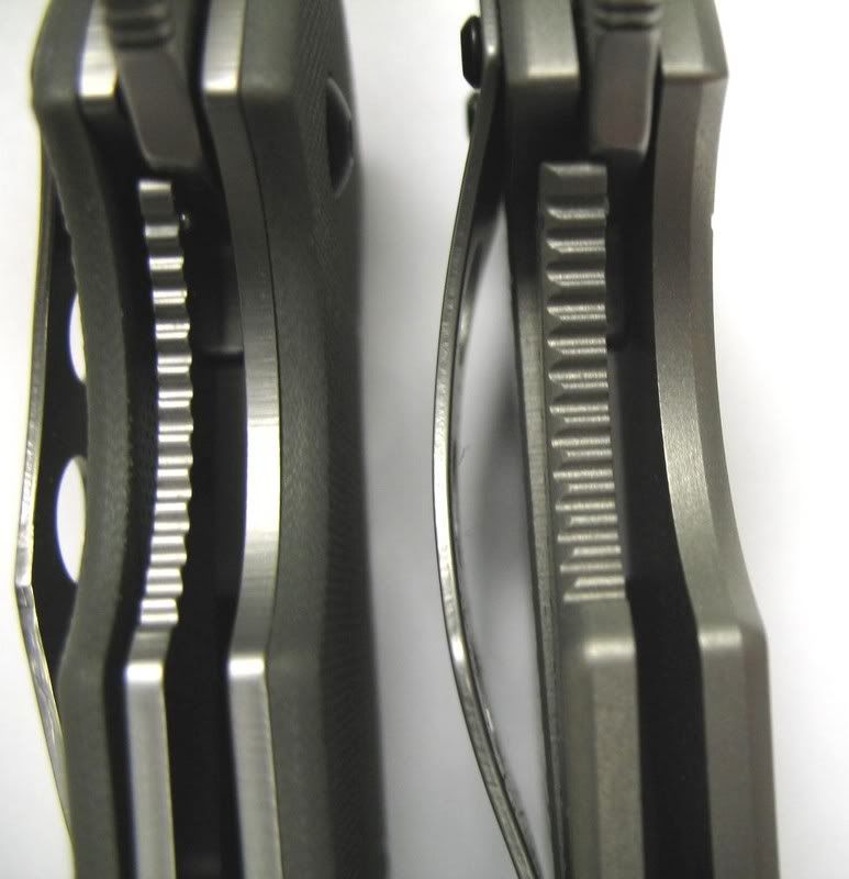

A picture like this with original JYD II, to estimate handle thickness and framelock, please.
Here you go. Engagement is bit off due to this piece being a pretty rough proto, but you get the idea. I believe the lock measures in at .130 vs. the .070 liner lock.
One more
WOW!! I can't wait! I like a frame lock better then a liner lock. That just looks great!!

Holy!!!!!!!!:eek: .130! That for you "tactical" lovers is thicker than a Strider frame lock!
I always saw big things possible for that JYDII knife and have said since first wrapping my hand on it that its the best folder Kershaw ever made and one that could fit into several venues in the hands of end line users. I see now that I hit the nail on the head there! That Ti JYDII is going to be a high demand folder I think. I know I want one or two for myself, especially in that blade steel too. Thats a fine steel folks. I liked it better than ZDP189 personally for better corrosion resistance and it seemed to sharpen back up far easier.
