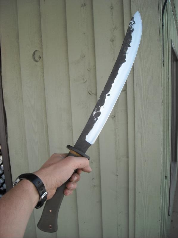

I'm finished mine and here it is:

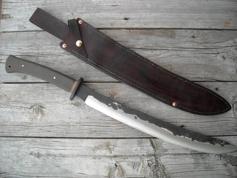

Actually I finished it last weekend and finished the sheath yesterday:
Blade is 17" from guard to tip, forged from 5/16" L-6 with distal taper (Thanks for the help Darcy, he did most of the forging on this one as a demo for me), handle is 7" micarta, guard and spacer are micarta.
PLease don't enter this one in the challenge as it was built before this thread started, plus it wasn't built entirely built by me. Just thought I would post pics....
Nice example Bruce.
