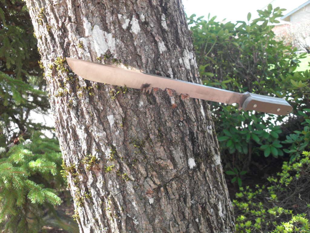

I'm just finishing up the sheath for a "bush/camp sword", so my project is almost done. I don't have a lot of wip shots, but I'll post what I've got.
Oh, its just a tad shorter than your recommendation if that's alright.

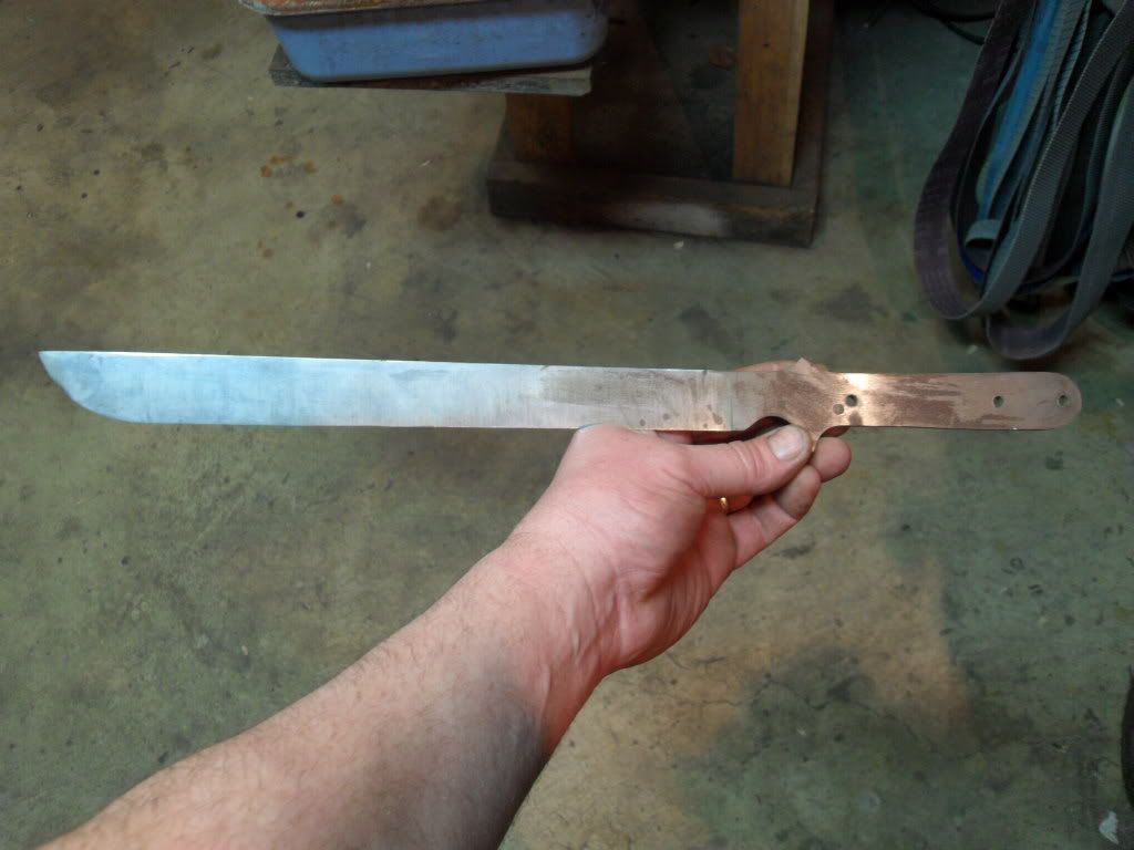

Ok, i have been wanting to do this project for over a year now. I have it designed, and the steel is sitting right by the forge. I will also do a full WIP(and renew my membership lol)
Had some time to get this thing down to HT tolerances, gonna fire the forge and put a soak on it tomorrow evening. Now heres the specs:
3/16" 0-1 stock removed
double flat to convex
OAL 18 1/4"
BL 12"
camo micarta w/liners, corbies and epoxy
Feels real light in the hand, and already hungry for wood!!!
