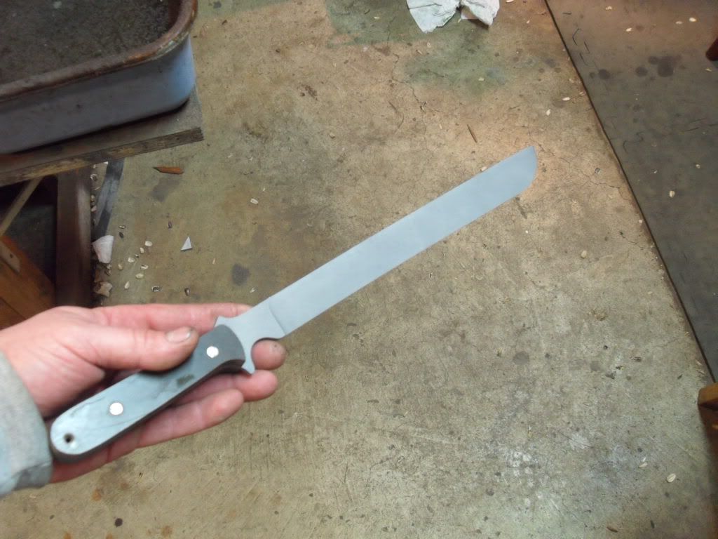

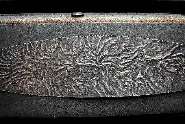

I got out into the shop for a while after my annual yard cleanup day, Sunday. I roughed out two Campizashi. One is in san-mai and the other twist damascus. The blade is 14" and handle 6". Blade gets slightly wider toward the ko-kissaki ( blunt angle tip ). I haven't decided how much, if any, sori to add. Tsuka (handle) will be cord wrapped with copper koshirae (fittings). Saya ( sheath) will be cord wrapped wood. I'll try and do a WIP on these as I get going.
I am thinking of calling this style shinrin houshiki. That is roughly "In the style of the Woodlands", or roughly equivalent to bushcraft.

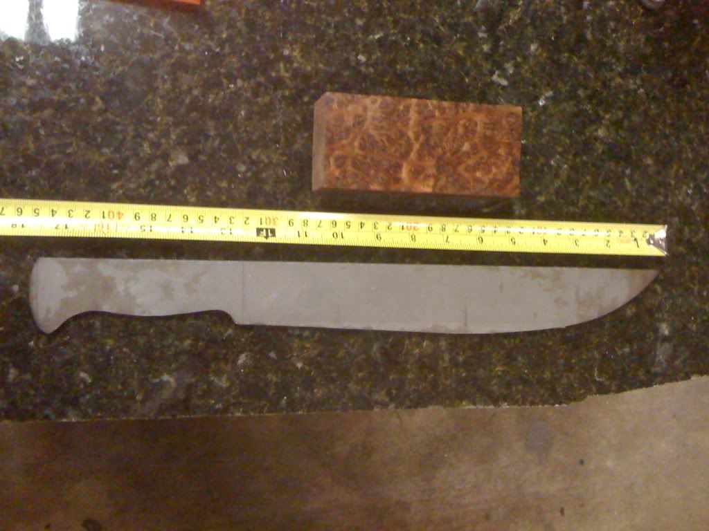

I got my basic profile done but stuck on the exact blade geometry I wanna do and what to do for the handle. Was leaning toward the redwood burl In the pic but would also like to try something different. I was wondering if I could wrap a handle in alligator skin and lace it up somehow. I was thinking use some cheaper wood to give it a nice rounded shape and wrap it somehow but this is a new one for me and not sure how to do it or if it would work.

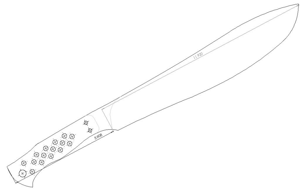

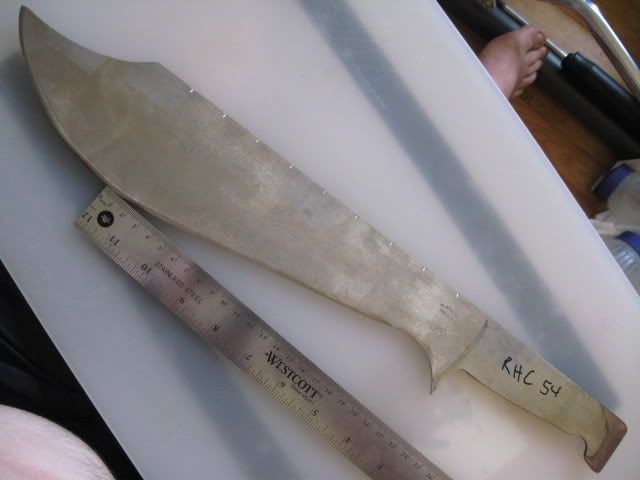

Here is my design. 1/4" O-1. Does it still count even though the blade is under 12" This is at my oven's max capacity.

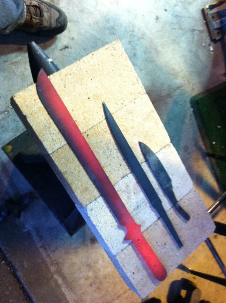

Fired the forge yesterday to get some heat treating done on the camp sword, and a couple nice blades fellow forumite Brian Ayers is putting together, everything went as planned, normalize once, i put about a 10 min soak on it, then gave it bath in some parks 50, double temper at an hour/400, broak the scale, hit it with grn scotchbrite, bead blast, and we're up to present, i'll edge tomorrow chop up some 2x4's, if im happy with everything i'll epoxy it up and call it done!
The intentional Quench
The cool down
After bead blast tonight
GHaile

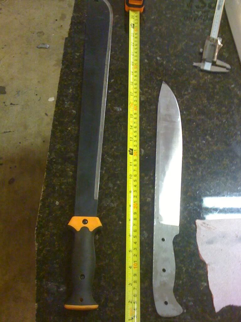

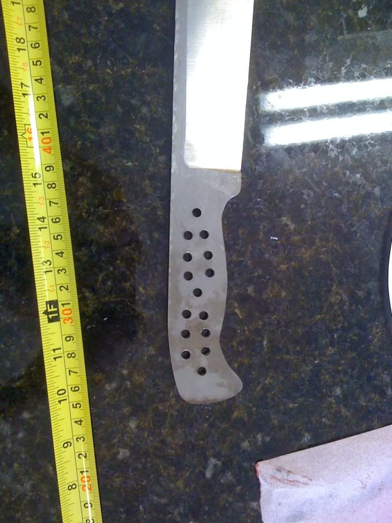

Got my bevels ground. Aded some slight curve to the handle and a very slight drop point. Also drilled out the handle and will heat treat either tonight or tomorrow. Got a pretty straight grind line which kind of surprised myself on something this long. Was planning on a scotch brite finish but might keep the grind line.
