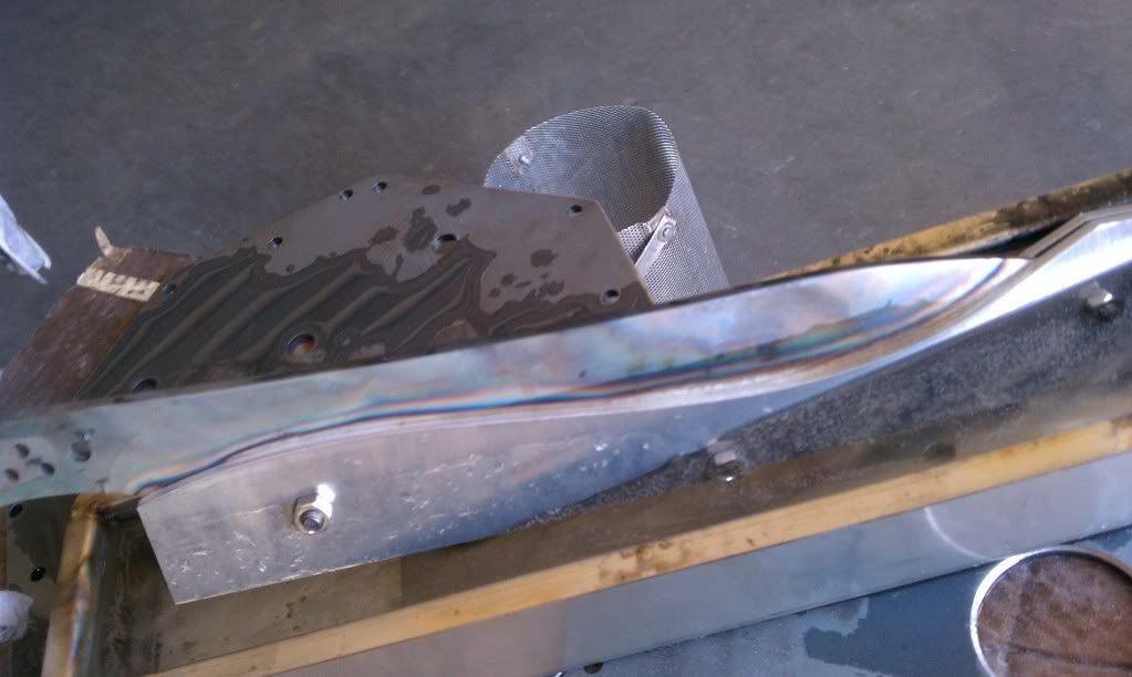

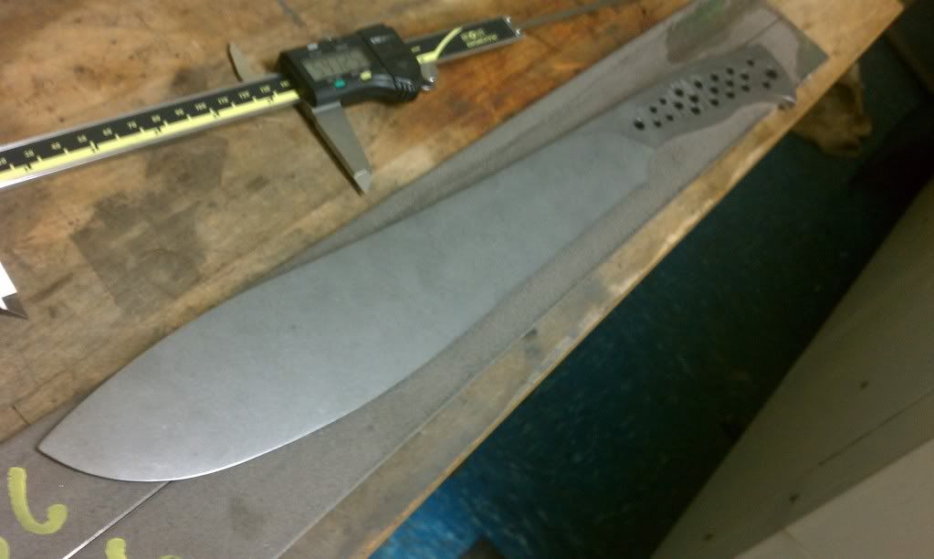

Back to work. The blade is ground, heat treated, Tempered spine, sand blasted, and tumbled. Ready for Vinegar patina, and handles.
I didn't get pictures of flame on tempering. However here was my setup for it. Aluminum plates cut to follow the bade shape somewhat. Any way to get a temper line with a sand blasted and tumbled finish? I plan to use the heck out of this thing, and am not it the mood to hand sand just for a temper line on a hard user.

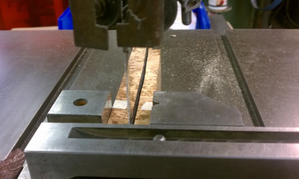

Okay On to the handle. I Originally planned to go with G10 then changed my mind to go with a block of Maple burl. I started cutting the block in the band saw using a squaring vice to get the cut along the plan I wanted, and not perpendicular to the un-squared sides. I am a bit off center towards the side I felt had the better figure.

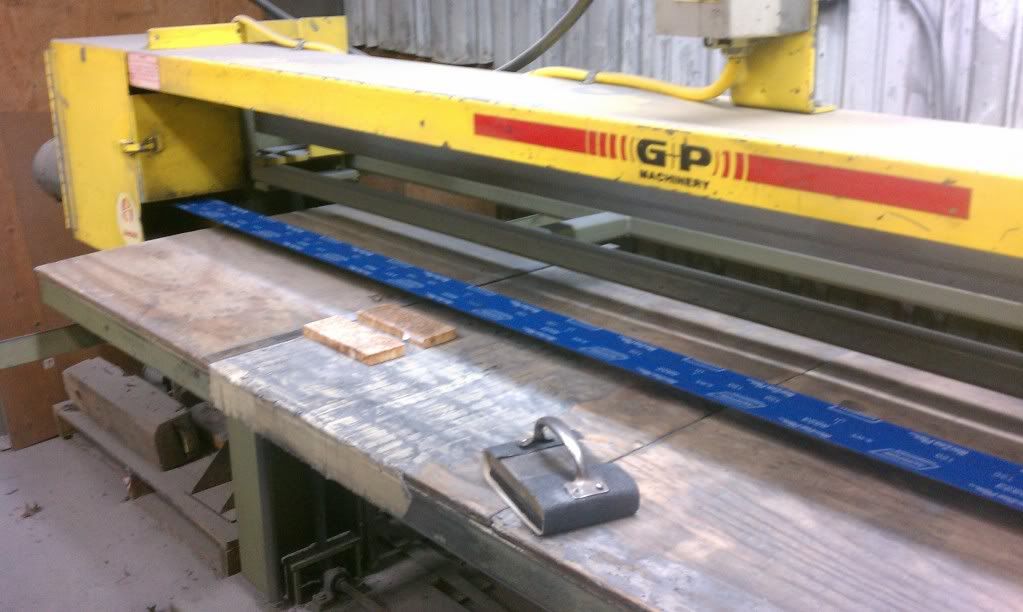

Then I took the slabs to my stroke sander to see what was waiting for me in the middle.

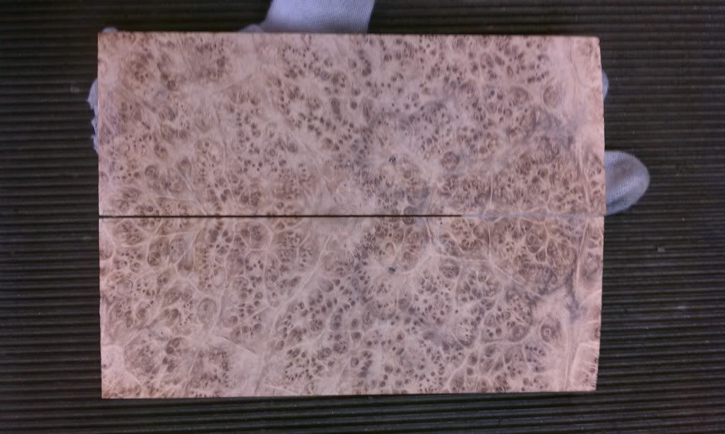

After some clean up at 80 grit and no oil, I found this. Which blew me away.
Now I am stuck with a question on my mind. I hope some of you will chime in here. I am after a shaped handle, not unlike a Wheeler bowie. I feel now that I have seen this wood that the bowie style handle shape will take away from the wood. I am thinking I should save it for a more flat profiled handle that can better display the character of this wood.
Any comments will help me one way or the other.
I think that wood will look great with a nicely contoured handle. I don't think shaping and contouring will detract from it at all.
Darcy:)
Carl that is looking great in every way! I really like the lines. The wood you picked out is spectacular.

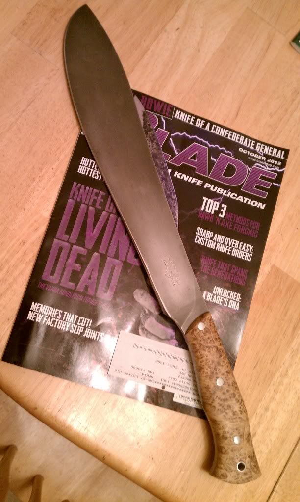

I keep walking past this girl (camp sword) letting her know I will get to her soon. Hopefully that will be this weekend. I brought her in for pin sizing today, then one last sandblast and tumble before going through the vinegar, steel wool, vinegar, steel wool, and then getting dressed in some Maple Burl. I can't wait to finish. Hopefully I'll be able to post pictures soon.

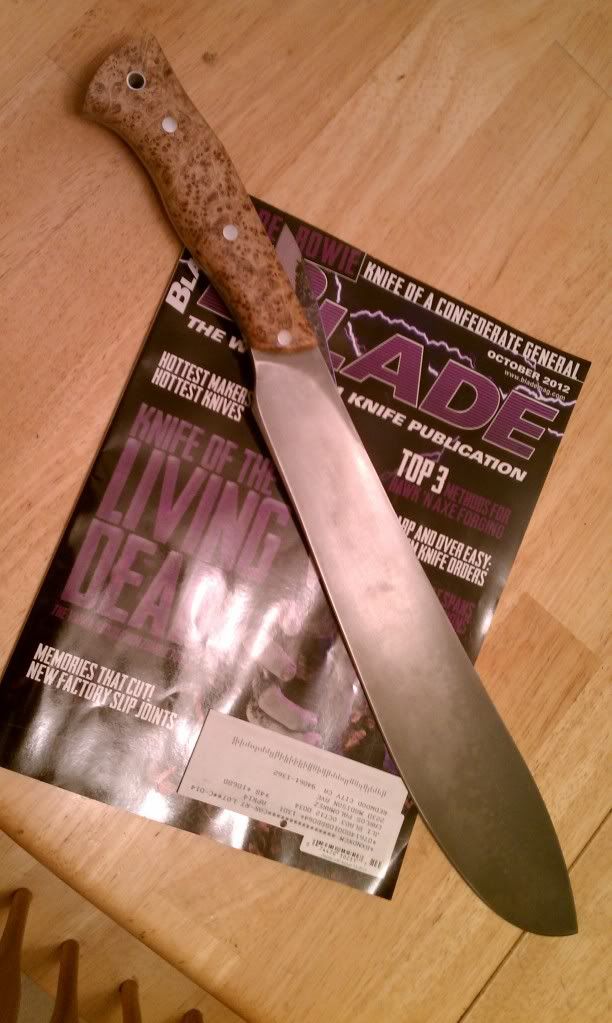

Well here it is. Not completely finished, but I am going camping, so I need to take a sword. :cool::D I figured I'd post pictures before I possibly make it look uglier than it does now. The handles are Maple burl, only at 600 grit (for now) . The blade is o1 with a flame tempered spine, and handle. I tempered the whole thing at 480 so it should be right around 56-57 RC. The finish is a sand blasted and ceramic media tumble, with a vinegar patina. I have no idea what the patten on the back side of the blade is, but if anyone has any thoughts on that or the "sword" in general I'd love to hear them.
Thanks for looking...
