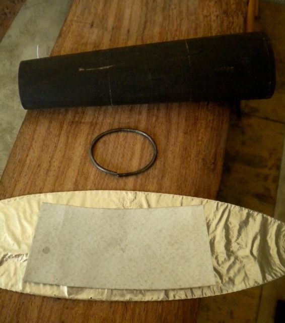

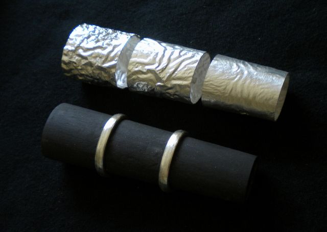

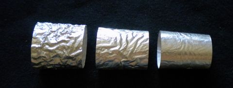

To fit the reticulated pieces over the wood core, first I make a paper template to get the shape needed.
I bend a wire around the wood core, about the same thickness as the reticulated piece and straighten it back out to get the length. It’s better to have it come out a bit too long than too short, because you can always cut it open and saw/file a little out. I shoot for just right and hope not to have to do that though.

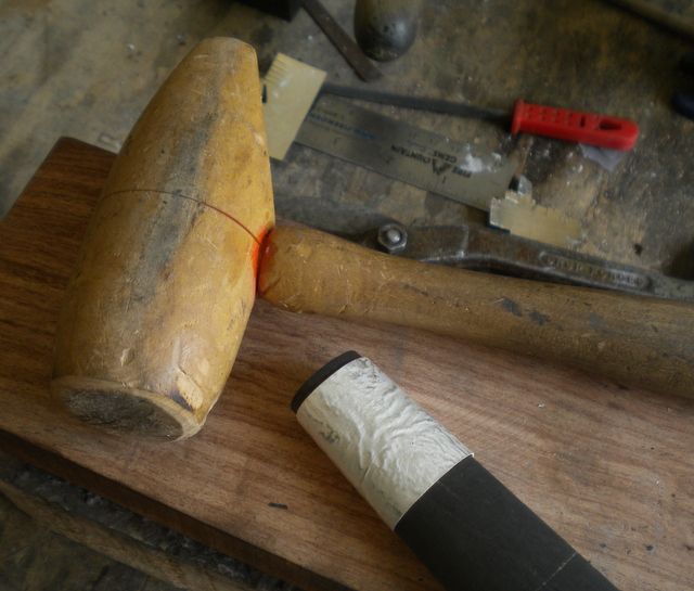

… Cut it out, bend it around, silver braze the seam, slide it on the handle, use a wood hammer and the core itself as a mandrel to get the fit.
No two pieces ever come out exactly the same. So, the way I arranged them was with the one with the highest relief at the back and the shallowest relief in the front which just seemed natural. I made them all a little bit extra tall so I can trim them down to get the spacing right for the half round silver bands. The silver bands will separate each piece, frame them in and (counter intuitively) help get the whole handle to look more unified and flow together. The banding will also help create a "rhythm" through the whole piece and help tie it together with the scabbard design wise.

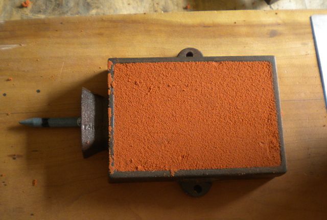

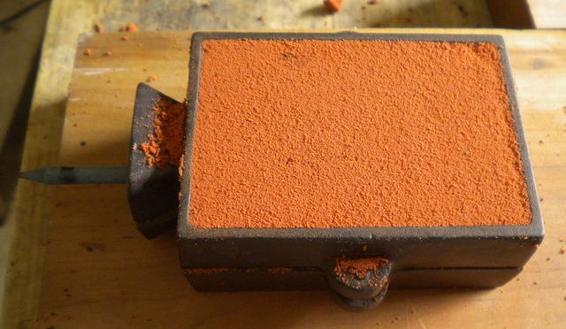

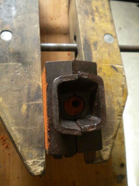

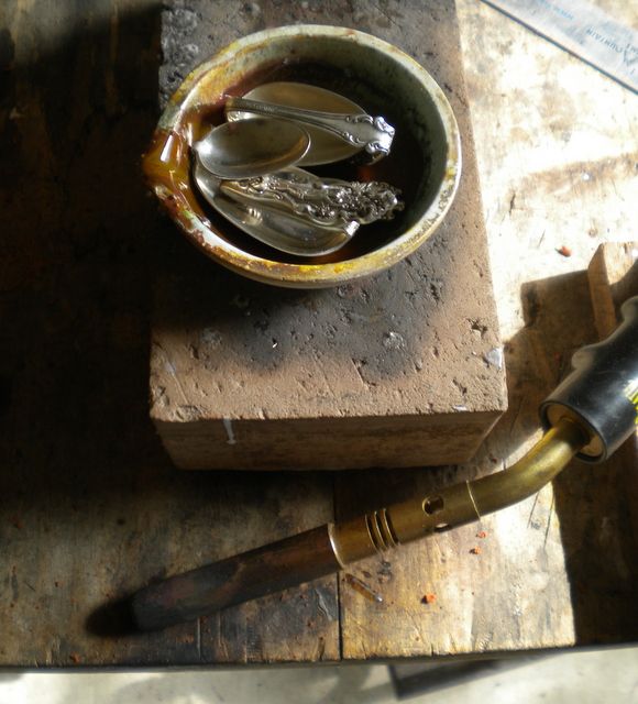

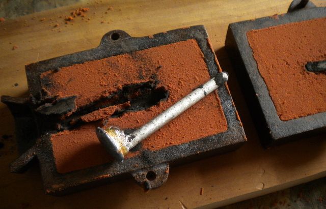

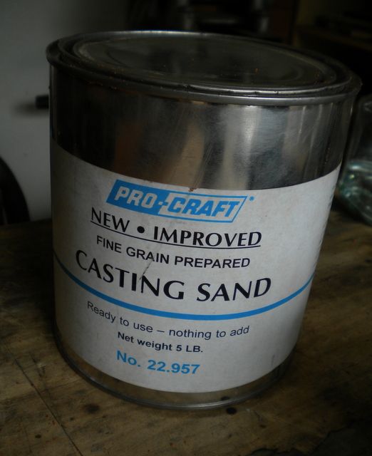

I needed to cast an ingot for the half round stock. I’m using a simple cope and drag and premixed sand (reusable).
For the form I used a pencil.
Pack the sand in one side, then put the other side on and pack the sand in.
Pull the pencil out and stand it up with a clamp.
Melt the silver, grab the melting dish with some tongs and pour it in.
After it cools, take it apart and remove the ingot.
After that, I just cut the top off, do some rolling and forging to make the half round stock.

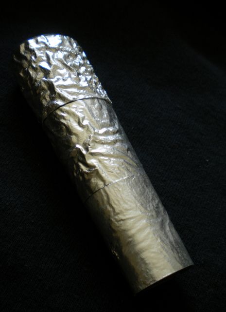

I got the half round bands in place. I made all the parts a bit extra tall, so now I need to trim them down to fit the length of the handle core flush and maintain the equal spacing.
I intentionally made the spacing equal. However, since it's on a taper, the larger diameter pieces look proportionately shorter and the smaller diameter pieces look taller. I like playing subtle "optical illusions" like that. I think the camera angle did amplify that effect in this shot though. It will be very subtle in the finished piece, and the angle you view it from will also effect it.
Square on it tricks the eye or mind a little.

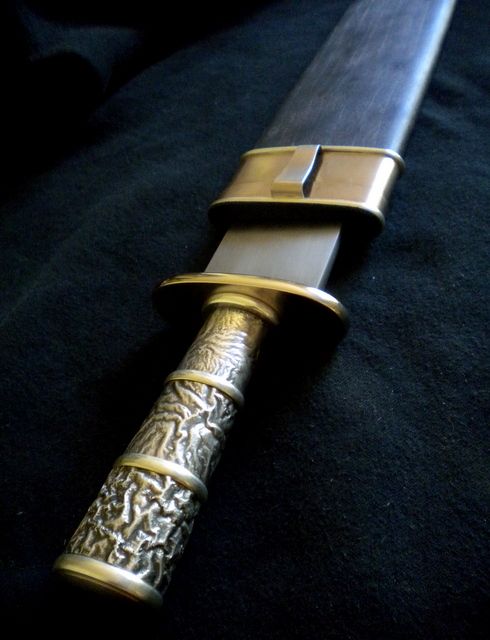

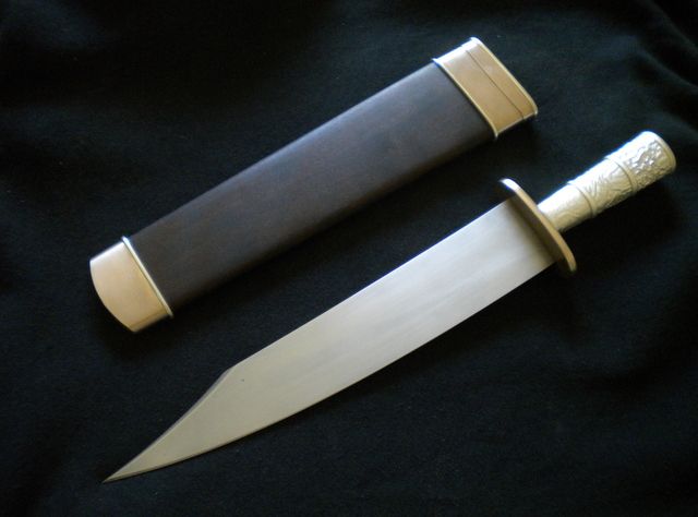

Since I got everything I needed yesterday, I changed my mind this morning and decided to work on the finish of the handle a little instead. I ended up going with the “Silver Black” instead of the liver of sulfur. The liver was a bit too “bluseish” and iridescent. The Silver Black was more neutral… did some sanding, patina, buffing with finishing pads, steel wool and polishing paste,
The reflection of the color off the bronze makes a subtle color transition onto/into the silver when the light hits it just right... "reflect light" is another important reoccurring design principal/element/illusion in cutler's art.
… It’s not so much “striving for perfection” as it is creating an “illusion of perfection”,... or "beauty". Perfection, order and beauty are just states of mind and "Illusionistic" in nature.
the patina makes a big difference in how I perceive the knife handle. Sometimes the little details really change perspective. Once I made a short sword that looked very bad and chaotic until I filed in a set of plunge cuts to define the false-edge. Then, suddenly the whole thing looked planned and careful.
For me, the patina does something like that for this handle. It looks more like a complete unit now. Thanks for showing this much of the process.

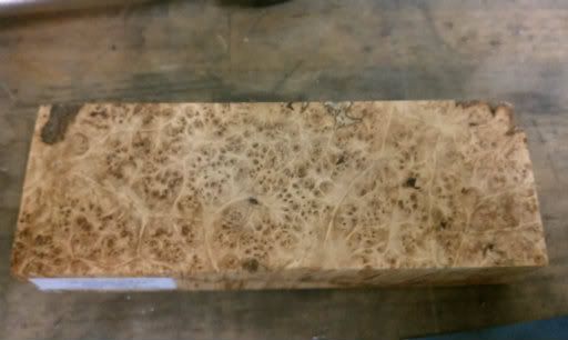

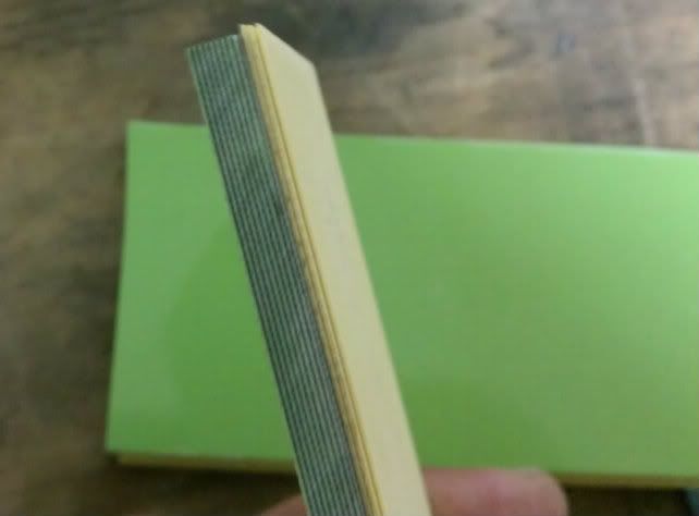

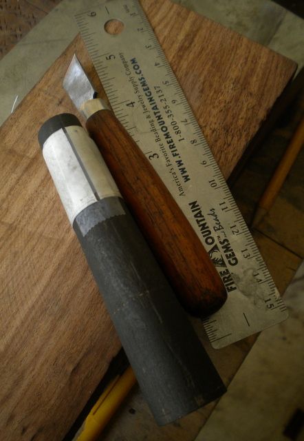

I have been stalled on handle material. I initially planned on Toxic and black layered G10 with yellow G10 liners, but now I am leaning towards a maple burl piece I have had.
(I wasn't getting enough thickness out of the G10 stack) What do you guys think?
Also, I should be getting some stencils in the mail from Ernie any day now. This will be my first etched blade.
G10 Stack.
Burl
