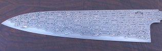

I'm always curious of how damascus with pure nickel as main composition perform? like W1 + nickel vs 1084 + 15n20.

I was curious how this steel would do in “standard” Damascus steel, both with the forge welding and in the contrast vs 1080/1084. Since I’ve ended up with good results (although I’m using my salt pot), I figured if it worked well with 15n20, it’d be worth using it for pattern welding, too?

I’m not sure why the recommended aus temp is so high. I’ve been doing my damascus at 1525 to match the core with good toughness and hardness.
