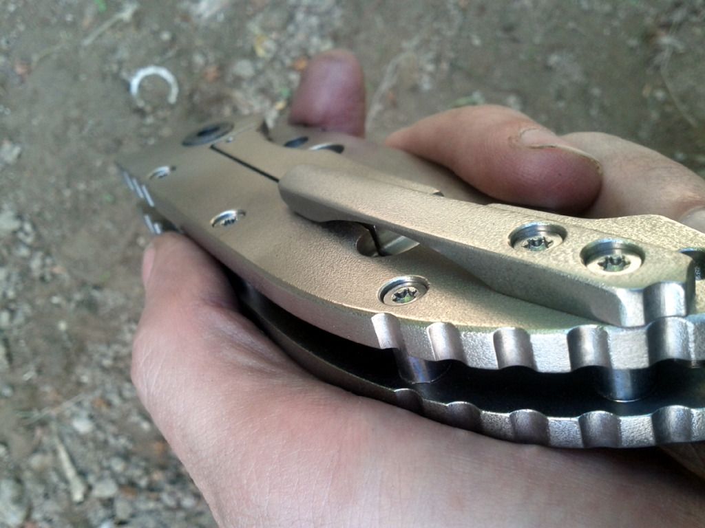

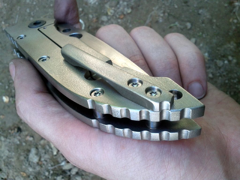

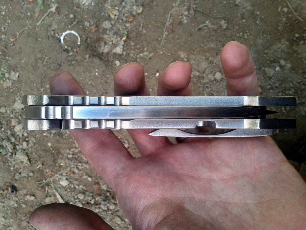

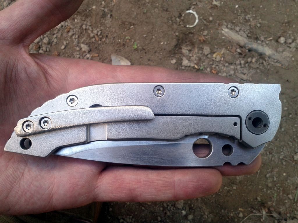

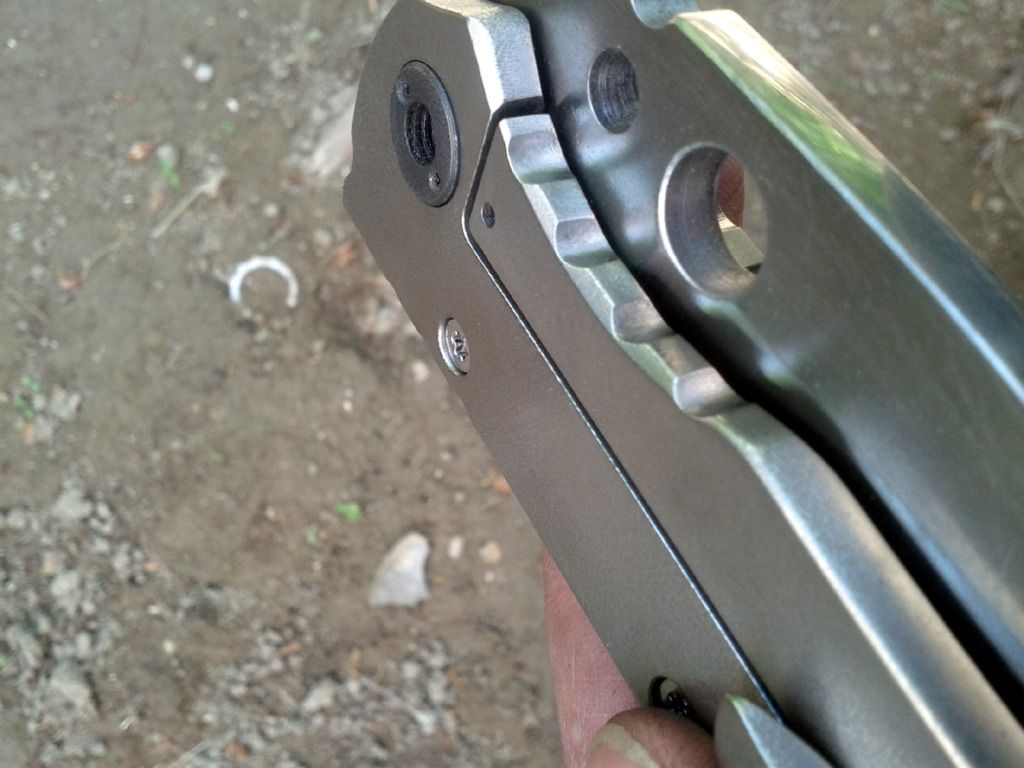

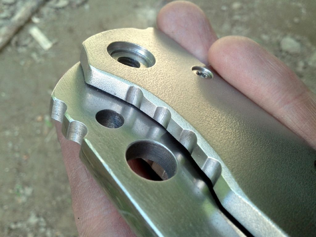

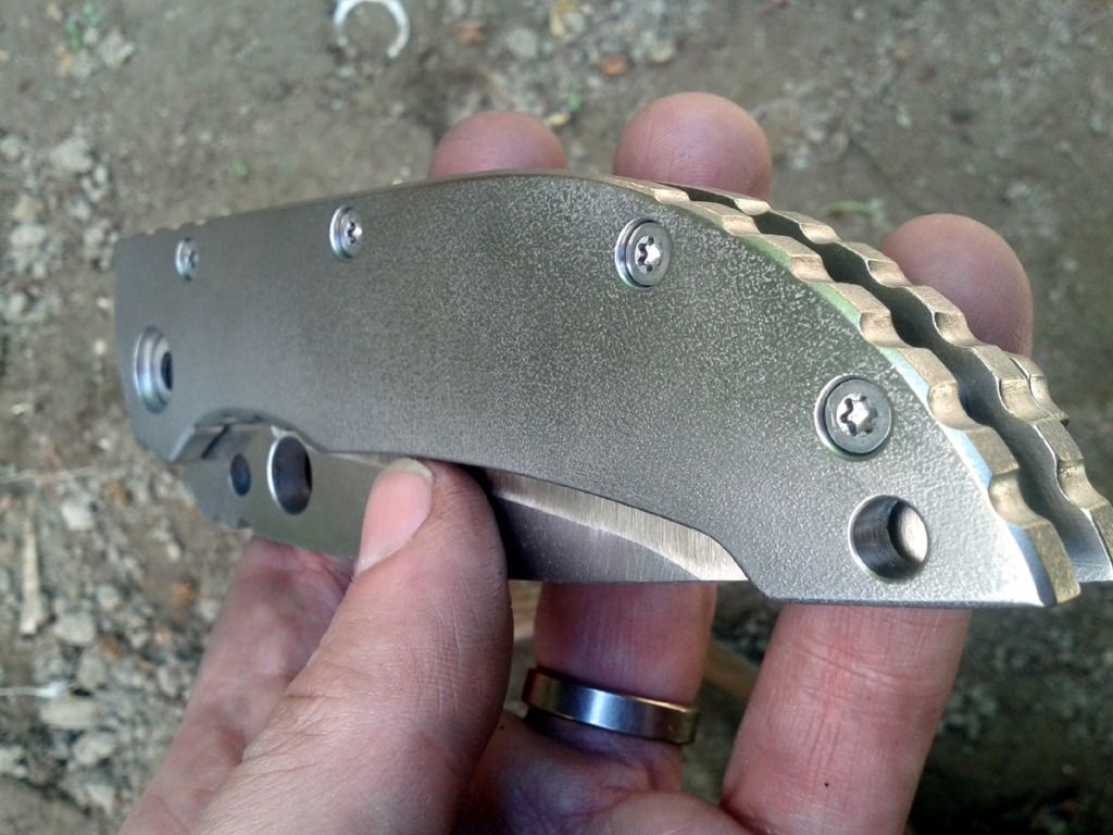

i orange peeled Ti frames and clip..here's some pics:

Still looking great but I think I prefer the stone washed myself.
The clip also is a very interesting design, much better than your 1st prototypes, but for people like me who prefer not to use clips all the time will you supply a screw to fit the clip hole and a shorter screw for the frame hole?
Wow! Looking great! Your orange peel looks slick. I think the "War Horse" has a cousin :D both ready to attack a tank! ;)
Lookin' Good, Dabilor. I think the orange peel looks cool too. The OP should make the knife easier to hold too.
i did it using wire cup brushes at high speed, i always polish Ti before any surface treatment for better result..

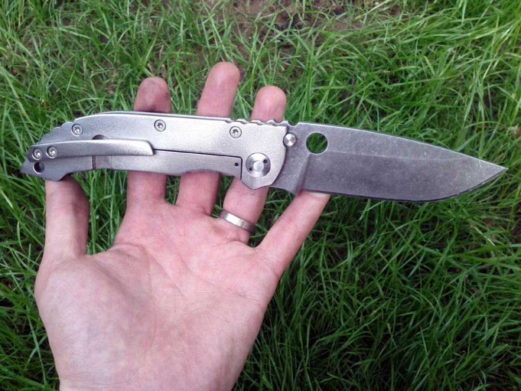

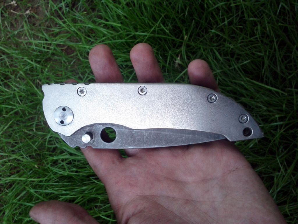

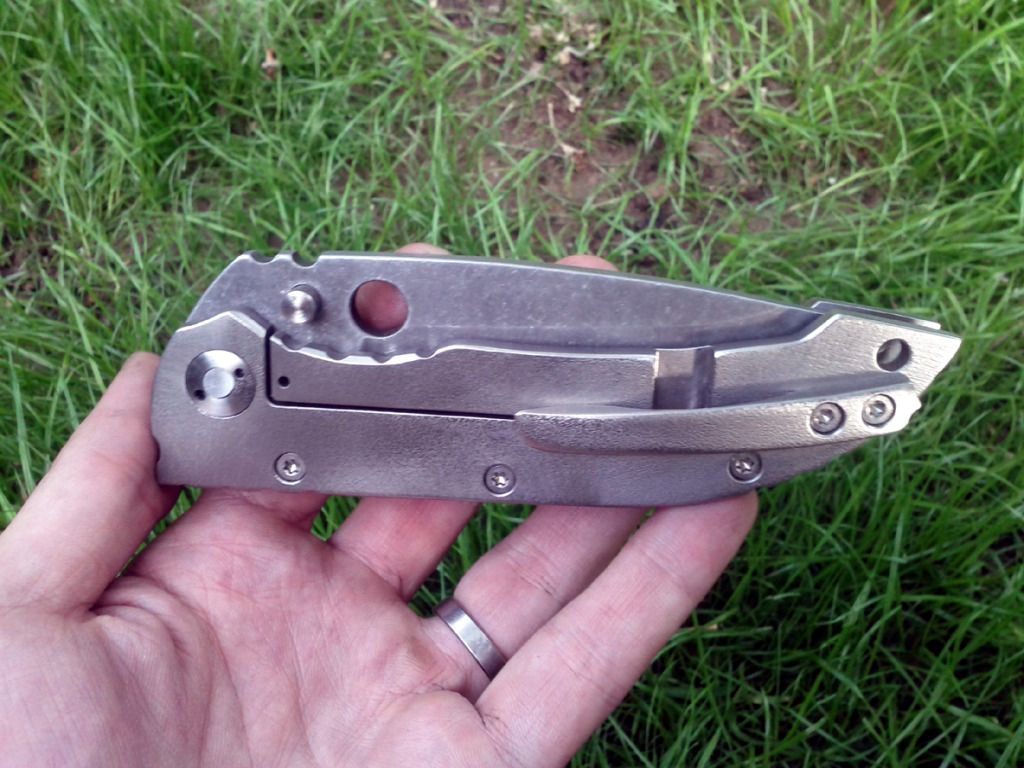

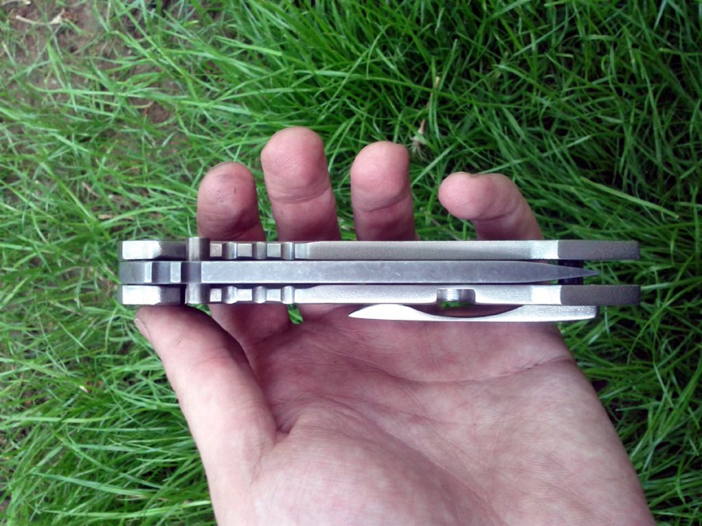

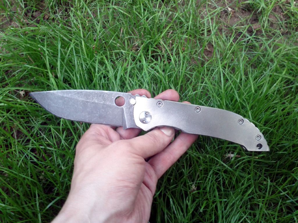

after HT , i polish the blade , than i dunk it in ferric chloride for 3~5mins and than stone wash it.
it's the Jake Hoback finish :D
ok, today i finished one..just need to etch it and put the final edge tomorrow and that's it..

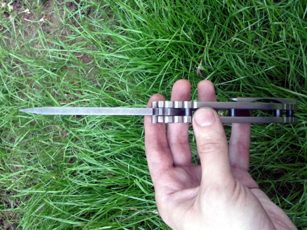

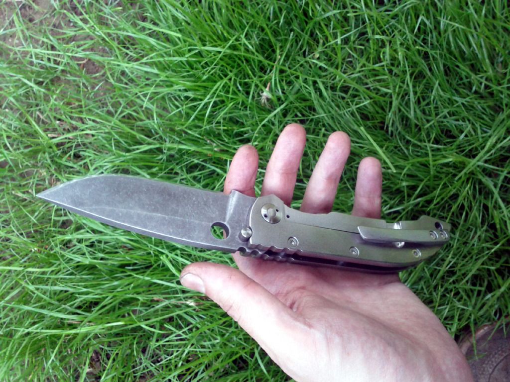

here's a few pics:
sorry for the quality i use my cell phone..

blade from center of pivot to tip is 4.5" , sharpened part is 3,6"
i'm making 3 , gonna finish up the second one tomorrow :)
