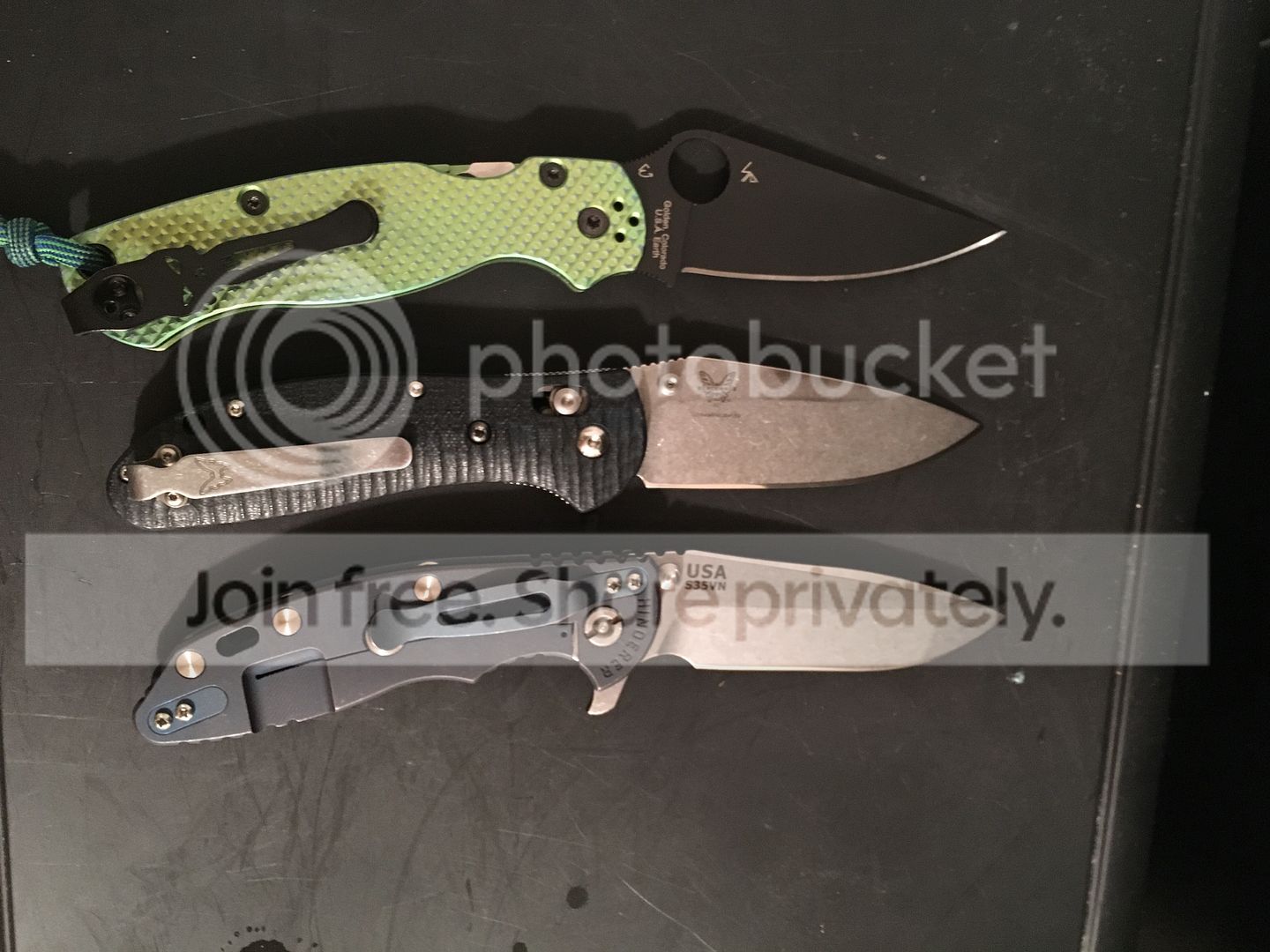

On my Instagram I presented a shot called "Three Locks" the other day and got some responses. I myself wrote "Personally I don't prefer one lock over another. I want a well made one!" And to that one person even responded "I hate framelocks /../".
