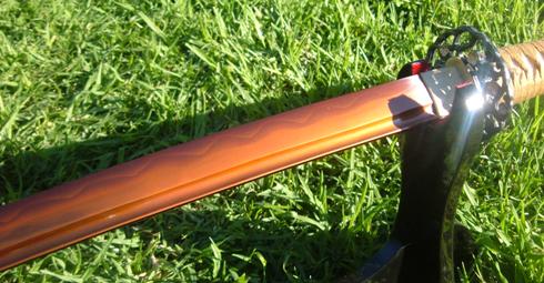

it's a katana by global gear, they call it "Titanium infused". What I think it really is is some sort of titanium coating all over a carbon steel blade.
This is appealing to me for 2 main reasons. 1: The looks. 2: Durability, low maintenance, rust proof, etc.
(SBG review: http://www.sword-buyers-guide.com/titanium-swords.html - they do not retail the sword themselves )
I have read on another forum that the coating on this particular sword wears off too easy, removing both the things I wanted it for. Especially if cutting through fruit, the juice simply smelting it off? O.o
But would an actual infusion of steel an Ti be possibly, with the purpose of rust proofing and getting a neat color? Or would it be possible to make a good enough coating, that will not easily wear off?

It looks dang nice.^
I'd prefer an all Beta Ti or Ti laminate blade. Right, William?
