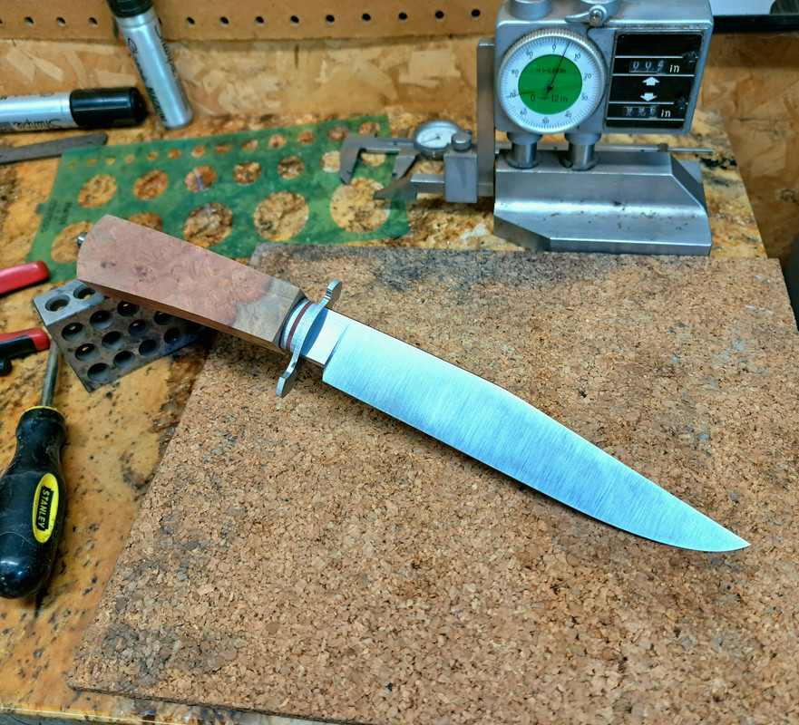

Looks great John, I really like the proportions where the blade drops. I always have a hard time with that, I try the golden ratio but end up going with something completely different.
Thanks John. It can be a tricky thing. And a snall change can make a big difference in looks.
This one is actually a bit different than my typical style. I had to quench twice. The first quench I got a killer hamon with crazy activity but it touched the edge in one tiny spot. So I re quenched and got almost as good of activity but the tip dropped. Which it usually does in oil. But it compounds each quench so the second quench dropped it a good bit.
I did a few post heat treat adjustments to the blade profile and I think it'll actually turn out cool.
But remember that top drop if you have to quench more than once.
Very nice John, I really like the shape.
