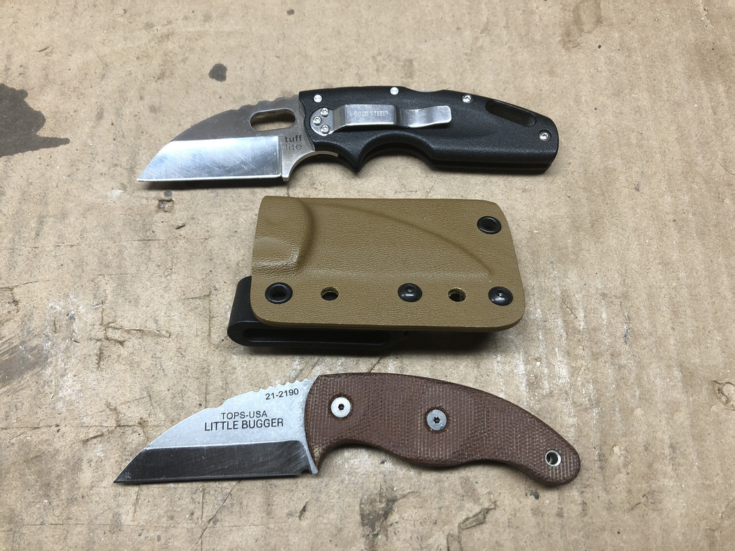

I LOVE the tuff lite and have been eyeing on the little bugger. They are a bit too pricey here to make sense. Handle looks a little different but would definitely like trying one.
