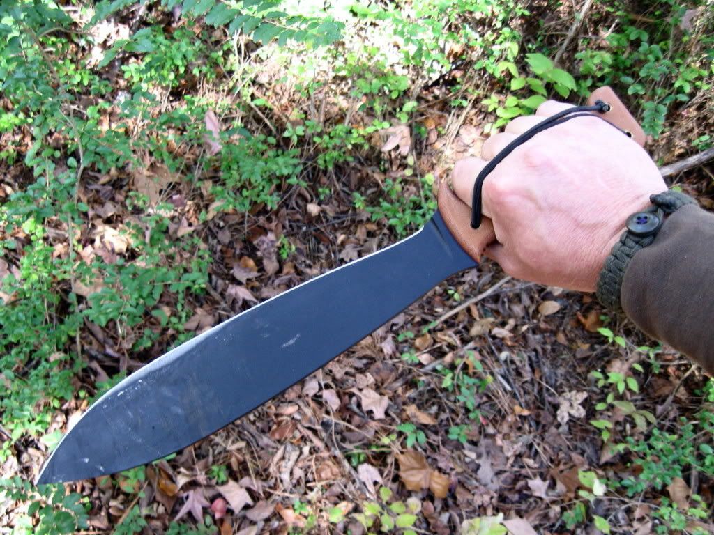

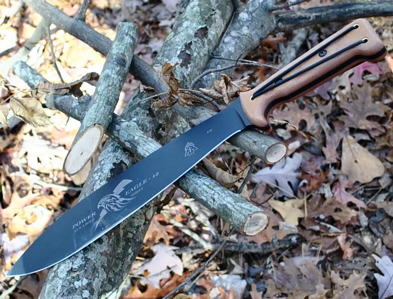

I looked closely at the TOPS Power Eagle 12 when I was at the 2010 International Blade Show in Atlanta this past June. Even though I really liked the looks of the design a lot, I really didn't have the money to spare at that time...it took me a few months to get one, but I still managed to get it at the current introductory price. I have had it for a month or so now and have put it through some paces.
The specs are:
O/A Length:......17 5/8"
Blade Length:....12"
Thickness:.......1/4"
Steel:...........51-60 Spring Steel
Handle:..........Tan Canvas Micarta
Blade Color:.....Black Traction Coating
Sheath:..........Nylon
Weight:..........1.6 lbs
With sheath:.....2.0 lbs
Designed by:.....Leo Espinoza

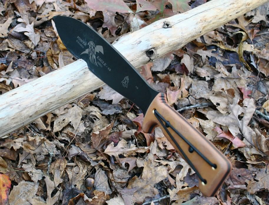

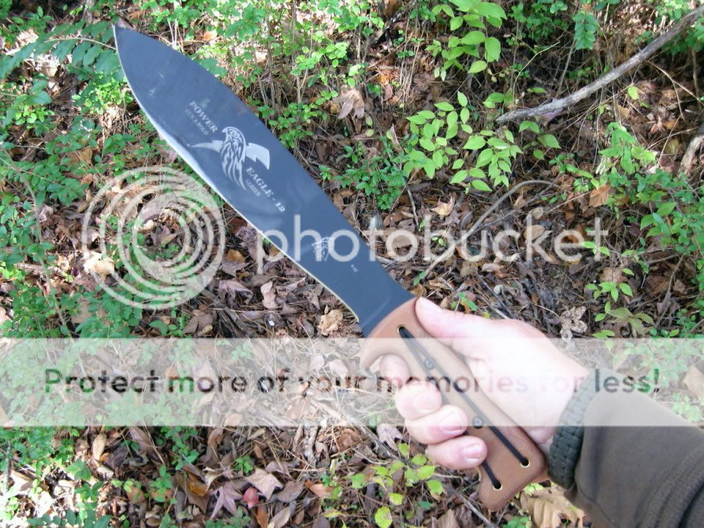

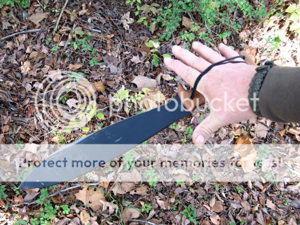

The knife has a full, contoured, tapered handle with a bird's beak pommel, that is actually pretty darn comfortable as far as machete handles go. That was a pleasant surprise for me.
The handle has a pre-made lanyard they wraps around the back of the hand, I found this is even useful in a rearward grip if you are just used to that wrist action.

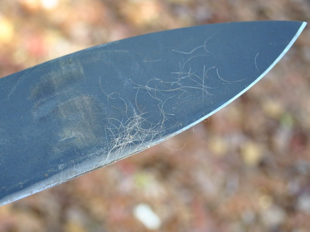

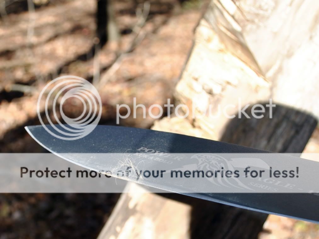

There is a nice unsharpened area in front of the guard that can be used for added traction during extrication, or for choking up on when whittling fuzz sticks...which by the way it does pretty darn well for such a large knife, it came with a great edge.
The balance point is about 2 inches forward of the handle. So even though it is blade heavy as a chopper should be the balance isn't uncomfortable when it's employed in a knife role.

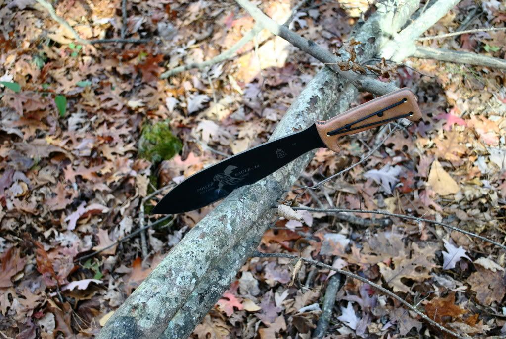

The sheath is a "molle-back" sheath that work with molle or pals webbing, it has eyelets for multiple attachment points, as as often with TOPS' sheaths it has eyelets that also serve as a secondary or alternative retention point.

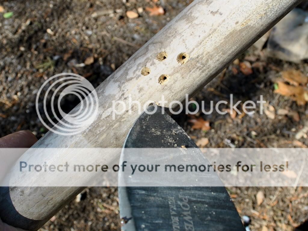

Being as the knife is obviously designed primarily as a chopper I have done a lot of just that. And since it is 5160 spring steel which is known for it's toughness and edge retention I have mostly been chopping in some very hard woods, and periodically stopping to check the edge.
I'm really not sure what type of wood this is...maybe maple...but It is a very hard wood that I have used to test more than one edge on.
But even after a few minutes spent making a deep notch in it the edge was still doing fine.

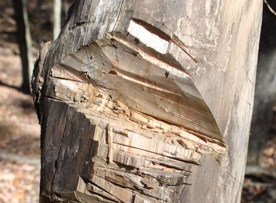

Then I set into a nice hard Dogwood tree, a recent victim of the blight, which it handled with ease.

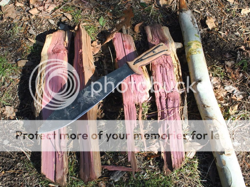

Next up was some seasoned Hickory. It severed some one inch thick limbs easily in one quick cut on the bias, and using the hickory log for a chipping block easily chopped them in two cross-grain as well.
end part 2 of 5

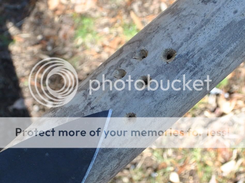

and even after multiple cuts through larger seasoned Hickory limbs the edge was still doing very well.

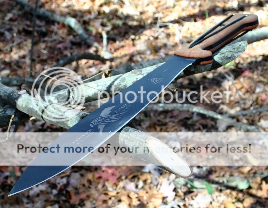

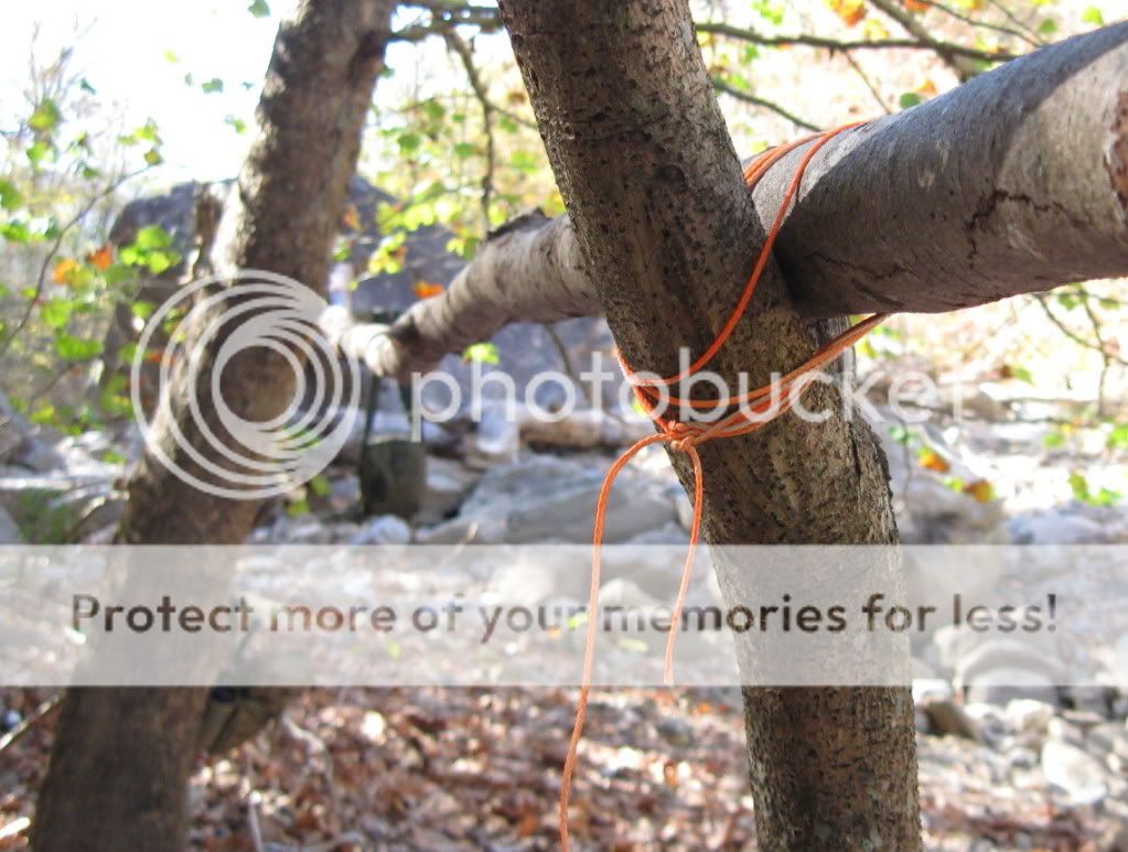

It handled well, and did very well when I used it to cut the structural members and stakes for this shelter.

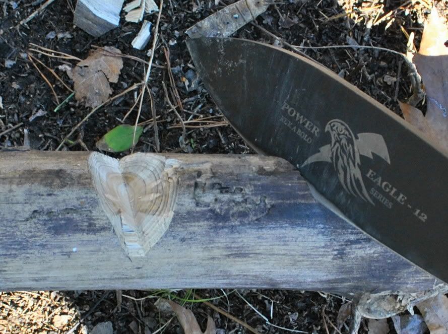

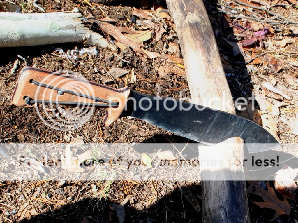

The full flat ground blade will bite deeply, it took all of three seconds to make this notch with two cuts.

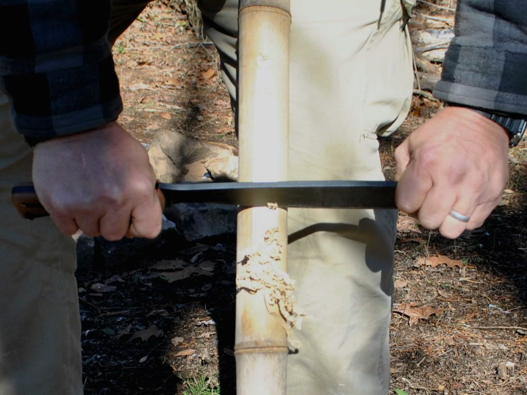

The knife also lends itself to being used as a draw-knife.

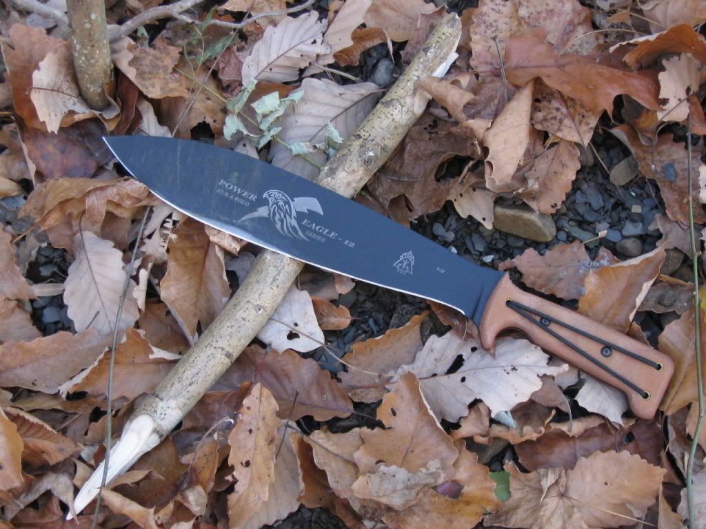

and has a nice pointy tip, which is always a plus in my knives.

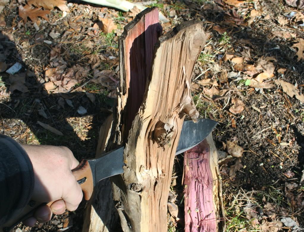

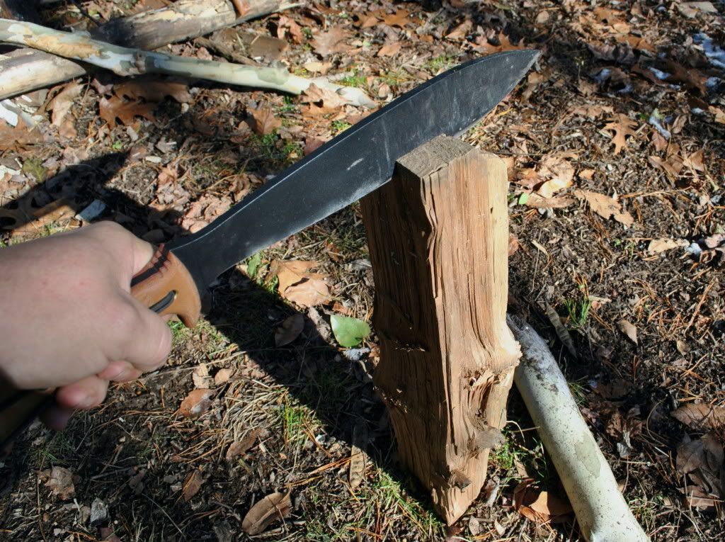

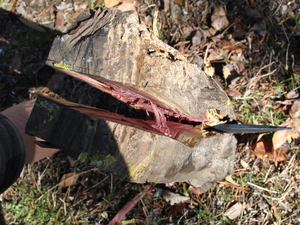

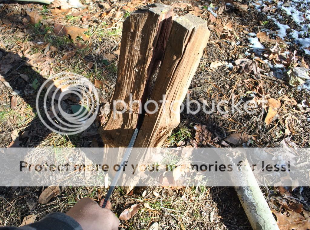

The tough 5160 has also handled some rough use in being batonned through some hard, knotty Cedar.
And still even the most used portion of the edge will whittle some thin curls very easily.
