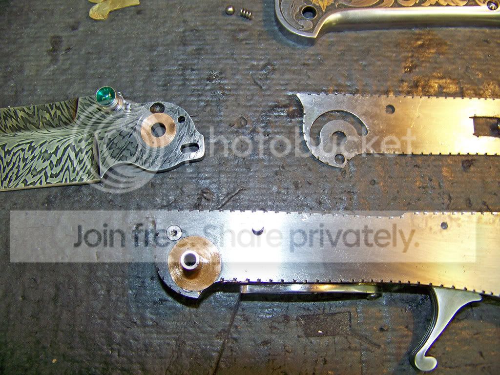

I'm going to lay this project to rest but I thought it would be interesting to show you just a couple more shots on a new thread as the other one is huge.
Here is the exploded picture of all the parts laid out and the assisted opener system. If it looks like somebody elses system it is purely accidental.
Thanks go to all my forum friends that have followed this project and all the swell comments and compliments along the way.

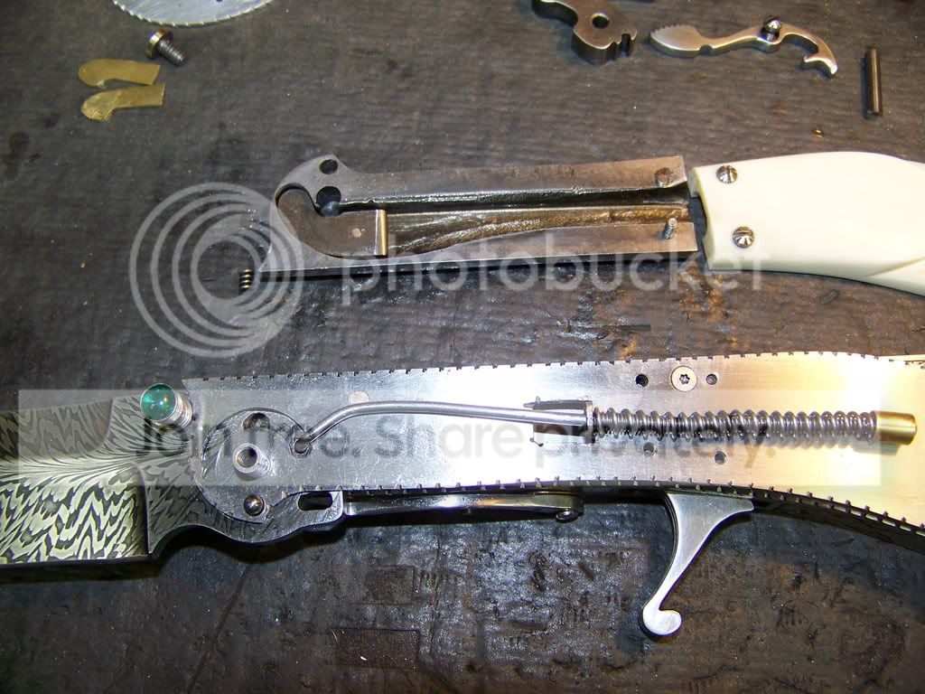

I've got a question regarding the springs for the assisted opener.
Are there 2 springs on that rod, one inside the other?
Don't they bind up with each other?
Why two and not just one?
What is the finished weight of this piece?
Good eye Steven. I have the variety pack of coil springs that Brownells sells. There isnt one with the correct inside diameter to fit snuggly around the rod and still have enough spring action (power) to open this blade. I finally had the idea to install an inner and outer. The inner adds power and keeps the outside spring from deforming when compressed also. Very snappy action now.
Finished wieght? No idea. Its a handful of steel and ivory for sure. It wouldnt hurt to drill some lightening holes or skeletonize the next one but heck I sell these by the pound.
