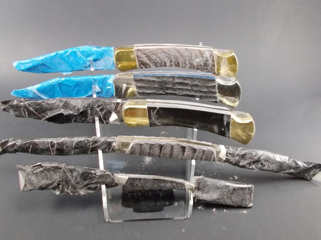

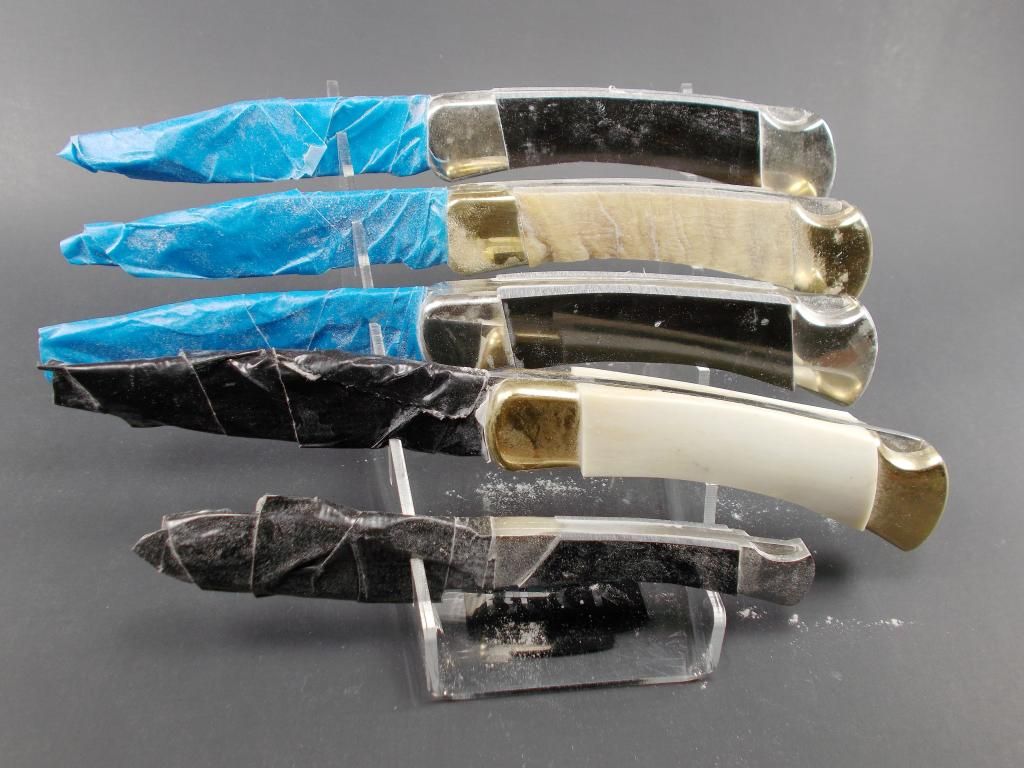

Here is a quick update on those knives…they have all been fitted and are now epoxied. Now to start making them purdy. I'll post them here as they get ready for my use or my display.
I ran out of painter's tape and was going to go buy more, but decided to finish rapping the blades in duct tape with paper underneath to protect them….yep, I'm that cheap!! :)
It's been cold even here in Florida this last week, so this is what my kitchen counter has looked like. It's warmer in the house! :)

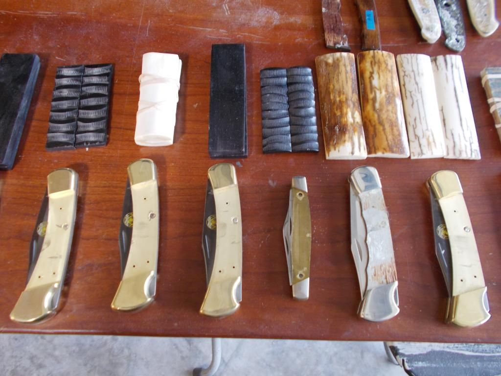

How do you deal with the lock pin? cut and peen both sides or just cut flush? do you recess a spot on the back of the scales?

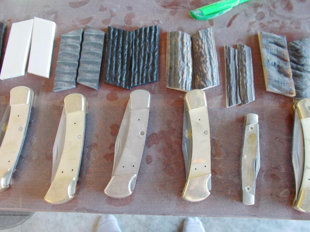

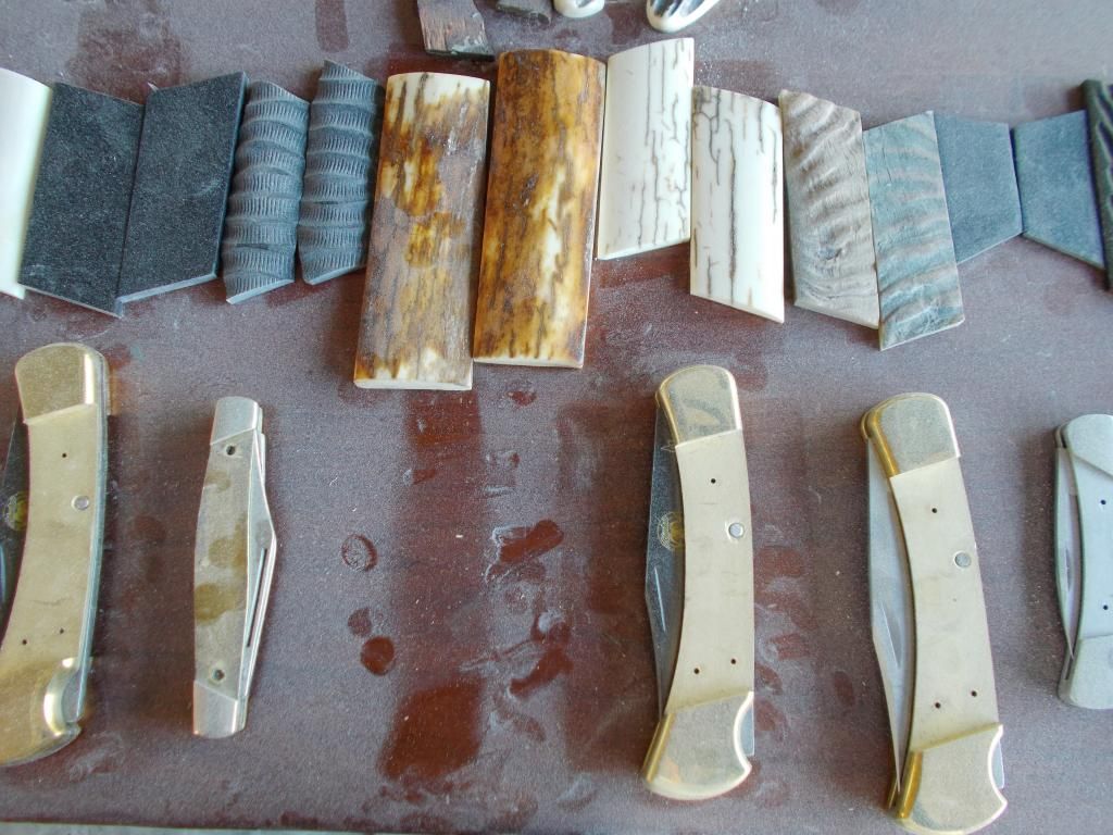

Here are some of the earlier photos on this project. I do cut the rocker pin and peen it below the surface of the liners.

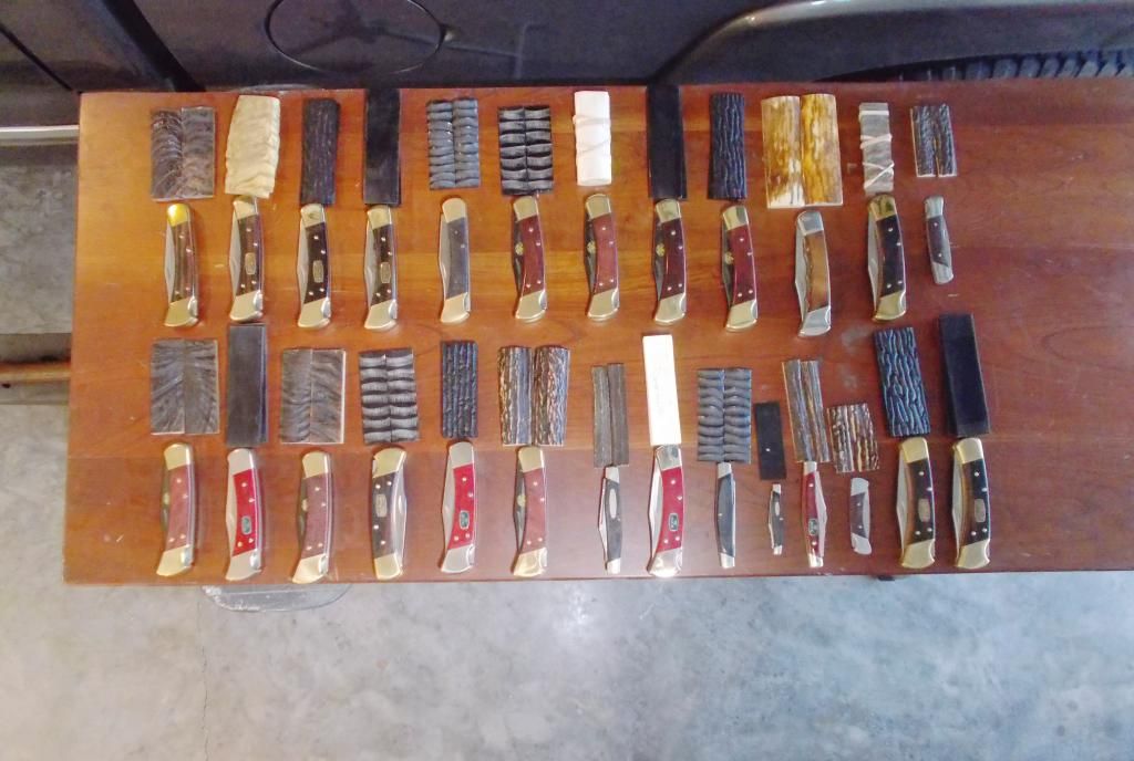

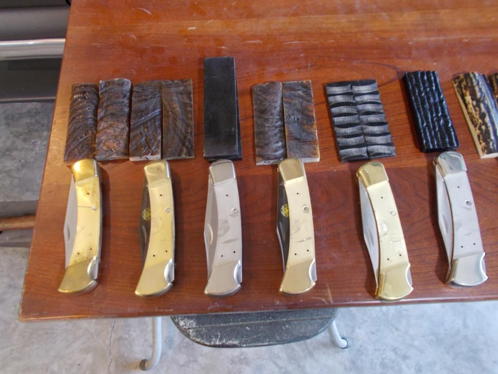

This is where I matched the new covers up to the knives I wanted to put them on.
These photos show the rocker pins peened after factory covers were removed.
These show the covers fitted to the frames and sanded to the right thickness.

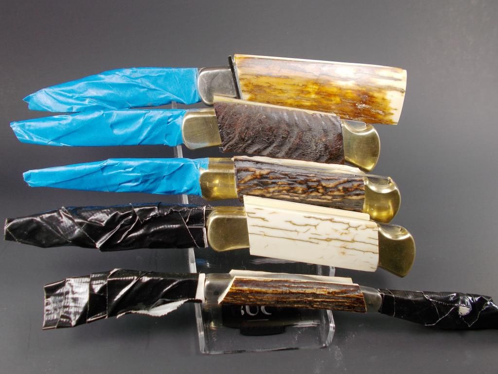

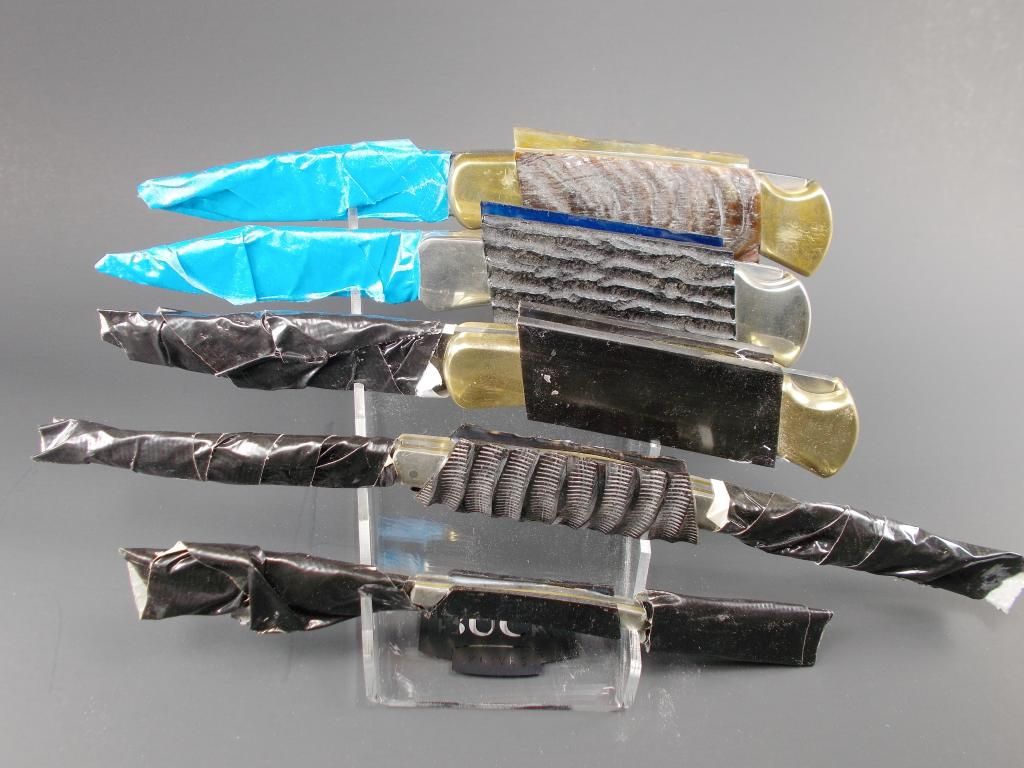

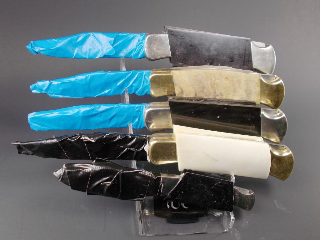

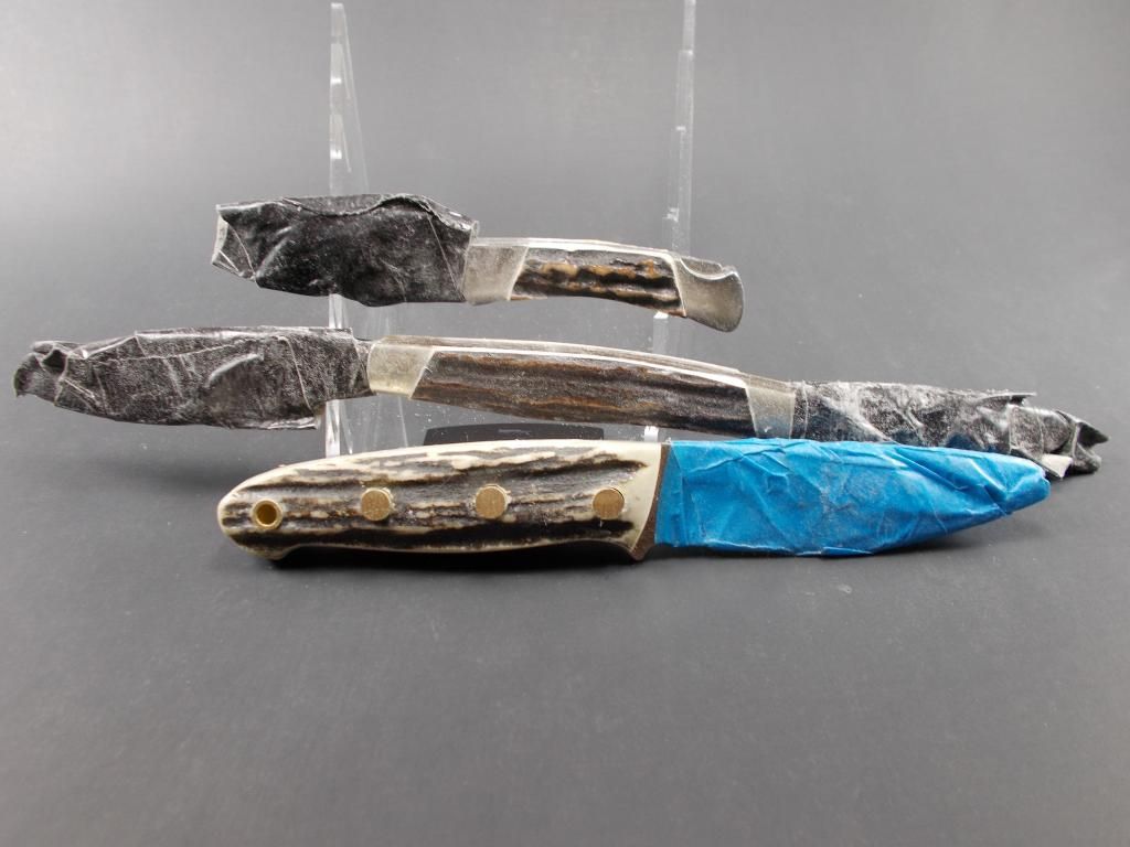

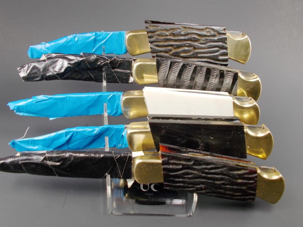

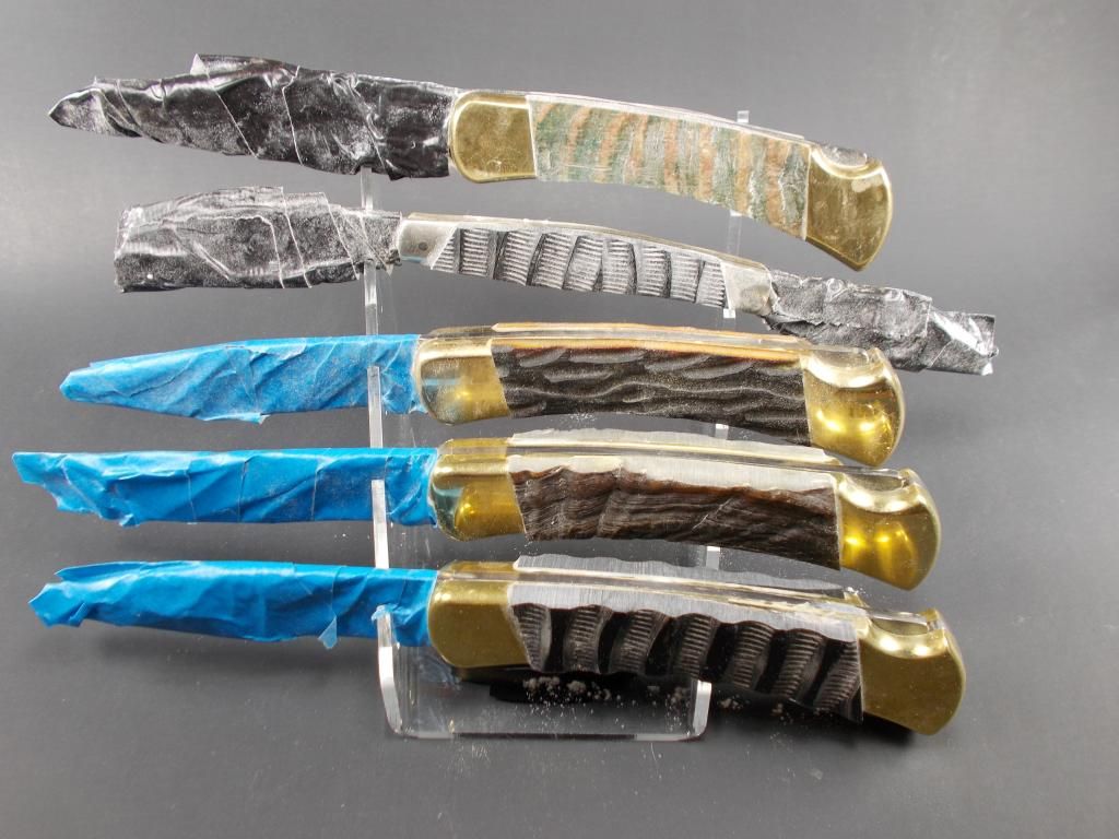

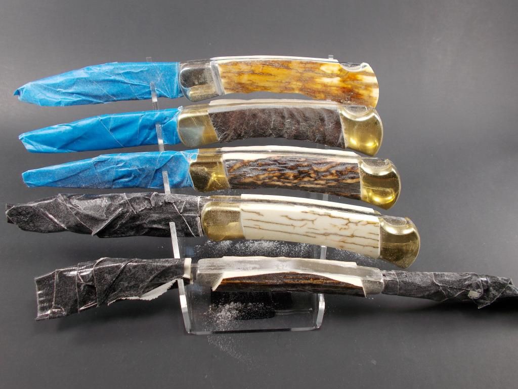

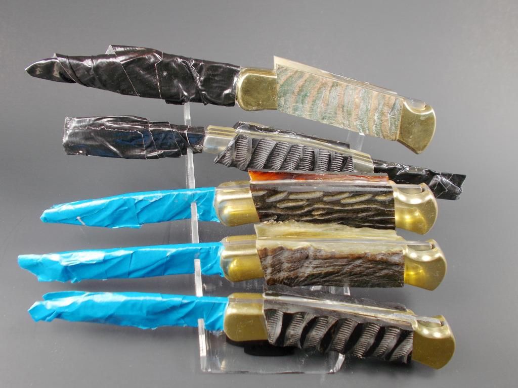

Spent the day doing the rough sanding on all 28 Buck knives.
My back and neck are sore. :)
I have these in the same order as they are in post #1 above so you can see the difference a day makes.
John…I use an 80 grit belt for the rough sanding. I believe most probably use a 36 grit for this process, but my eyes aren't as good as they used to be, so a less aggressive grit it is. :)
Second rough will be with a 240 grit belt, then up to either a 400 or 500 grit belt depending on what belts I have in the shop.
I enjoy the whole process of re-handling knives, but I like the finish sanding the best. That's where you can really make a knife look great with a little imagination.

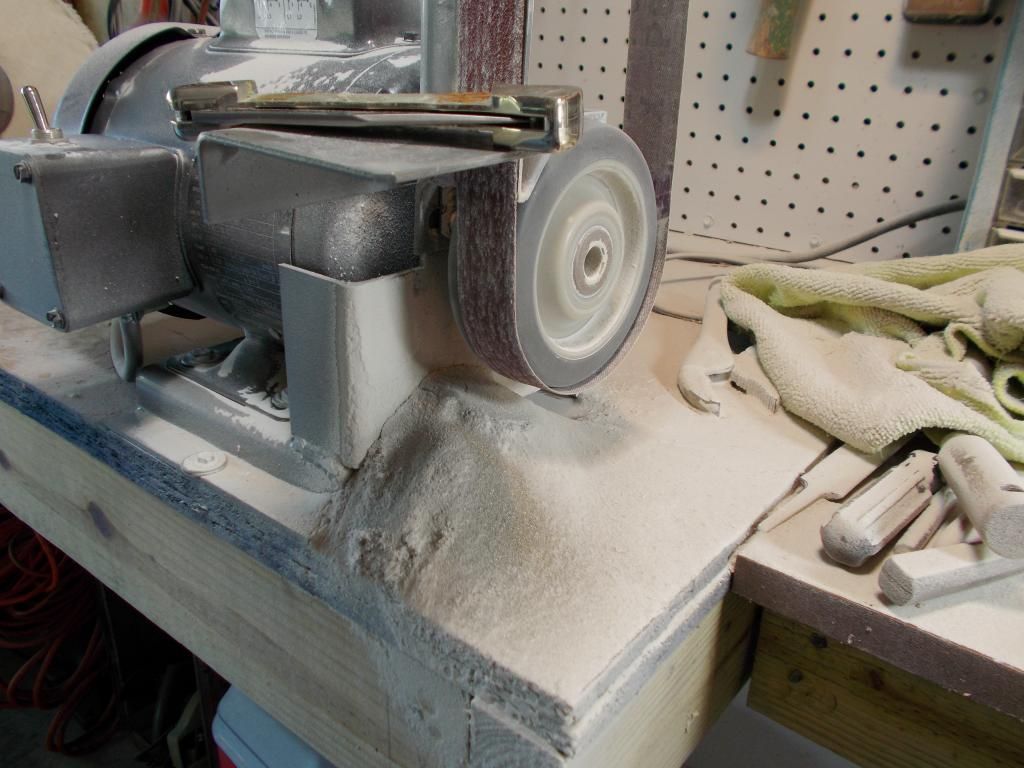

Looks fantastic ..Can I ask what type of sander you are using? I have a cheap harbor freight (1x24 inch belt) the belt is to flexible so it is hard to get the handle match the bolster height without hitting the brass. I have done a few less expensive knives ..not quite up to attempting a buck just yet..need better equipment and a lot more practice to get to your level
Bob
Bob, I use a 42" Kalamazoo. It's not one of the large belt sanders, but I don't need anymore since this is just a hobby for me. It has a nice flex to it. I find I use that part of the belt more. Just have to go slow and constantly check the progress…especially when I get close to the bolsters and liners.
I still occasionally nick the brass lightly, but it's never bad and always easy to finish with the final sanding.
Fantastic work Mark. I have a handle material question. 2nd pic top knife and 5th pic top knife what is the material?
Keep up the good work!!!
