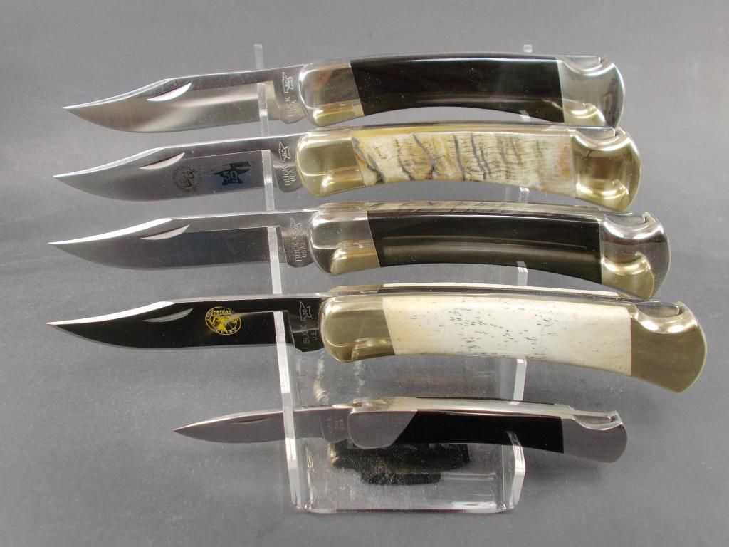

Fantastic work Mark. I have a handle material question. 2nd pic top knife and 5th pic top knife what is the material?
Keep up the good work!!!
Second picture top knife is smooth buffalo horn and the fifth picture top knife is mammoth ivory.
The mammoth ivory knife is a Buck Custom Shop knife I ordered with S30V steel, finger grooves and walnut covers. I ground off the rear bolster so the mammoth ivory could go all the way back. I also added about 1/16" buffalo horn and 1/16" nickel silver right behind the front bolster for some separation.

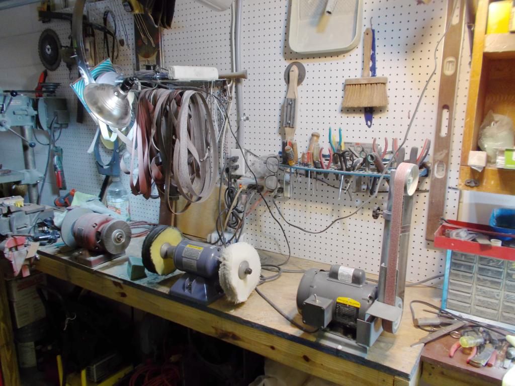

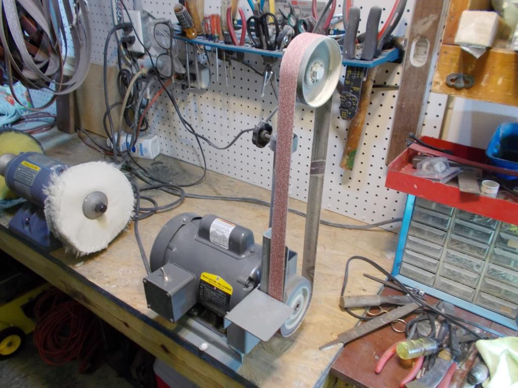

Bob, I use a 42" Kalamazoo. It's not one of the large belt sanders, but I don't need anymore since this is just a hobby for me. It has a nice flex to it. I find I use that part of the belt more. Just have to go slow and constantly check the progress…especially when I get close to the bolsters and liners.
I still occasionally nick the brass lightly, but it's never bad and always easy to finish with the final sanding.

I am terrible at explaining myself, so I wanted to try and clarify what I had said here to badws6 yesterday about the belt sander I use.
I should have said I use the slack belt for this finishing part of the re-handling process. I believe I only use the slack belt from the time the covers are epoxied onto the knife to the finish.
I only use the platen and table when I am actually fitting the covers to the specific knife. I use the platen to thin out a cover so it's not too thick also.
I like the cover to match up fairly well to the bolster on the knife. I do have one Buck 110 in stag that I left much thicker, but I don't like that look nearly as much.
A lot of the covers I get are cut on an angle that wouldn't look right on the knife. I freehand those until I get them close to the proper thickness to sit on the liners and have close to the same fit at all for corners of the bolsters.
Then I flatten them nicely on the platen for a good fit to the liners.
Going slow and checking the fit often works best for me…although my favorite re-handle to this point is a 112 that got the covers meant for a 110 that I got overly aggressive grinding.

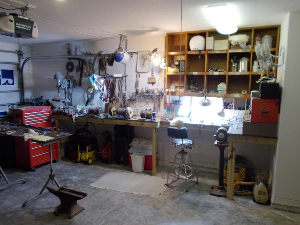

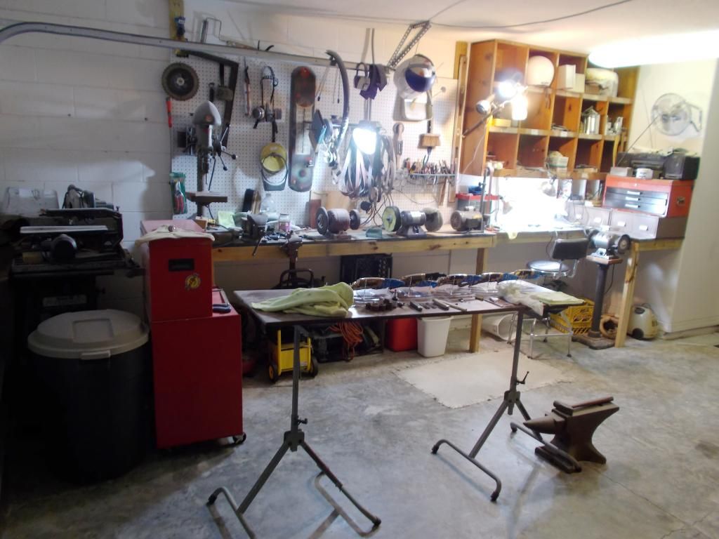

Here are a few pictures of where I play with my Buck knives;

I finished eight knives today, but am only posting the first five to keep these in order. This first set of five is the same first set of five in a couple pictures earlier in this thread….post #1 and post #15
The only thing not done to them are the pins. I'll decide which ones to pin when I get all of them done.
Top knife is worm groove.
Next is Impala jigged buffalo horn.
Third is camel bone.
Fourth is smooth buffalo horn.
Fifth is another worm groove.
