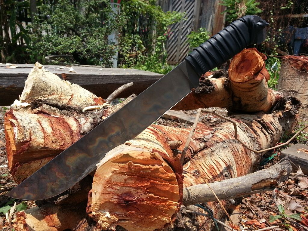

3 Weak ago I made a machete out of CPM-3V with very expensive HT protocol. The toughness and edge holding is excellent but I start to feel regret now because I realize that proper HT 5160 will do 80% of it performace at 1/5 price... The overall design and geometry are just far more importance than steel type.
Those color on the blade are made by quenching 1980F steel in 500F molten salt.
You are right about the 5160 toughness. But the 3v blade can be ground much thinner. And the thin edge makes it easy to sharpen. Your blade looks very much like a 3v blade I bought here from a knifemaker. Yours doesn't seem to be ground quite as thin. Mine was sold as a "kitchen knife/light machete but I can tell you it chops very well. The thin stock and grind makes it a very light, fast knife. I have bent/waved the edge by hitting rock(inadvertently) and whacking a small pencil sized dead oak branch.
You need to use your knife and get familiar with 3v. It is a huge improvement IMO over 5160 or 1095 and some, not all, of your customers will be happy to pay the difference. And, from what I understand, it's not a pain in the ass to grind either.

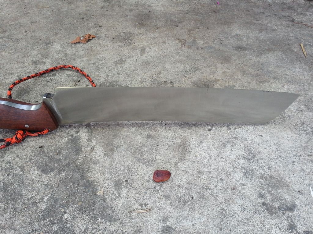

This is not really a Machete since I designed it to be a hybrid light chopper too. The blade spine is 0.17" thick with almost 2" width. Therefore if the edge was ground thinner it would be very difficult to pull it out from the wood when chopping.
You are right about 3V blade could be ground thinner than any stainless and might be a bit better than 5160 but it wouldn't be that superior compare to the proper HT low alloy carbon steel which has reputation of excellent edge durability like 52100 or CruForgeV.
This cutting competition blade made out of Bohler's R100 equivalence to AISI 52100. I consider this as a very thin edge combined with this type of geometry/design is a very good test of HT quality.
If you want a steel that hold super thin edge then better to stick with CPM-M4 or Vanadis4E. You can HT it to higher hardness without sacrificing much toughness. That why it popular among cutting competition blades.
