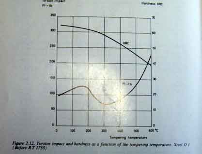

...One damn temper/impact strength chart for 1095 (and the 10xx series) and this wouldn't be a discussion anymore...
Does this help?
It's un-notched charpy and shows >50 ft.lbs (~70 J) at ~56Rc which is the common final rockwell of 1095 'survival knives' like ESEE and Kabar and Ontario.
Crucible's C-notch Charpy values for O1 are ~40 J, and I would not be surprised if the values are similar for other 1%C tool steels.
http://www.crucibleservice.com/eselector/prodbyapp/tooldie/ketos.html
CPM-3V at higher hardness (but lower %C) can achieve 113 J, S7 can reach 165 J. That would make 1095 at 56Rc "brittle" :p
Generally, torsional toughness will show details like that big embrittlement region while Charpy will not at the carbon levels in cutlery steel.

It depends whether you consider Charpy accurate for really hard steels or not. Aside from reading that before, I think there might be something to it because the torsional impact values feature that enormous dip between 400 and 600°F that accounts for TME. If you look at the O1 chart I just posted, the torsional impact curve is higher than 1095's.
And you'll note that the Crucible link doesn't say "40" anywhere. It has a blank at 55-57 Hrc because that is the middle of the TME range, and they probably didn't bother to test it, or didn't want to confuse anything with that number. O1 probably shouldn't be used below 60 Hrc for reasons that included TME.
If you look at all the charts in 1095 and O1's wheelhouse - higher hardnesses, you'll note that both charpy and torsional values are higher for O1. At 350°F temper, both steels produce about 63 Hrc and O1 has a charpy of 28 ft/lbs and a torsion of 125. 1095's number are 24 and 114. At 55 Hrc both of their torsion numbers drop to 70.
This may seem like hand waving, so I'll let the numbers speak and let people draw their own conclusions about how accurate Charpy graphs are and what TME is and does.
