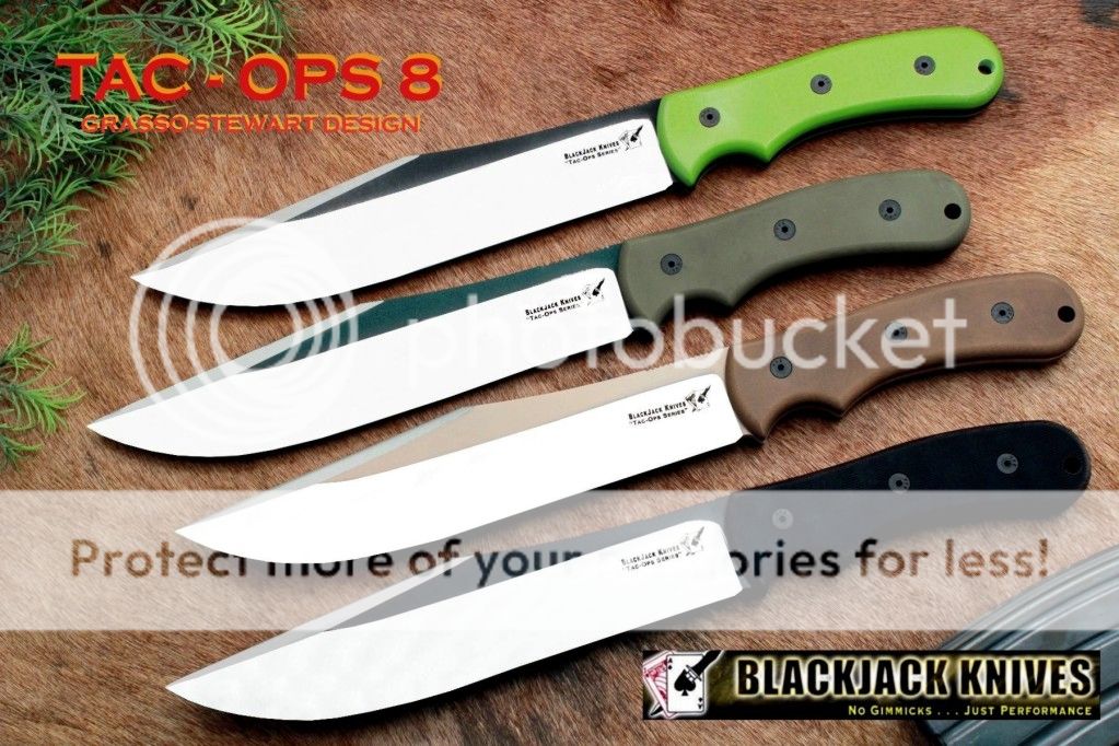

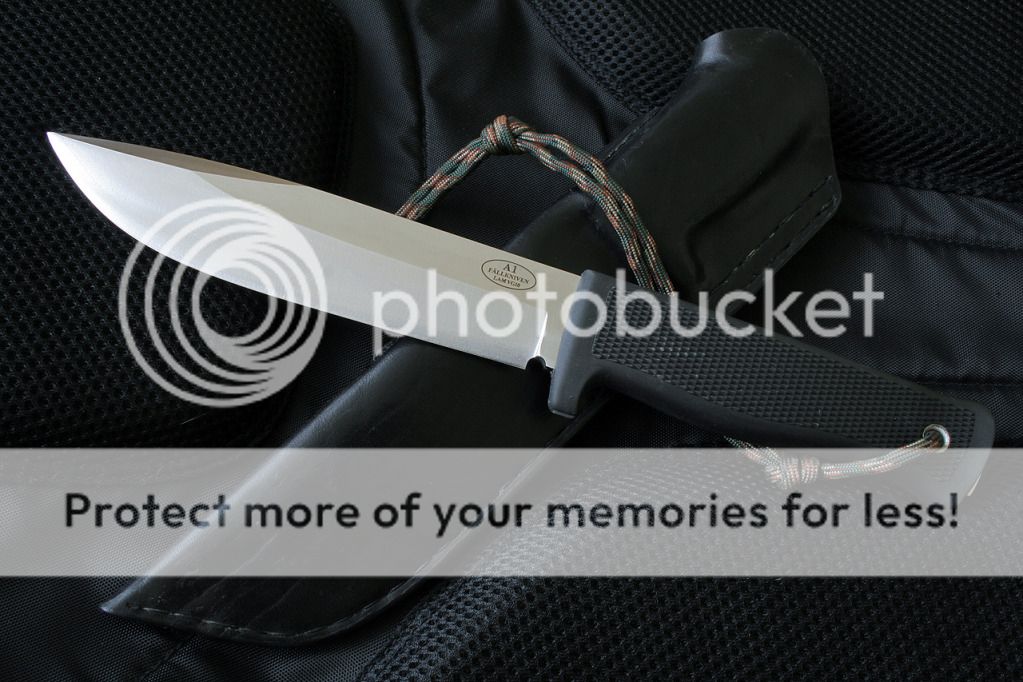

If you look for something on a large side but still very functional consider
Falkniven A1
or Tac Ops 8
