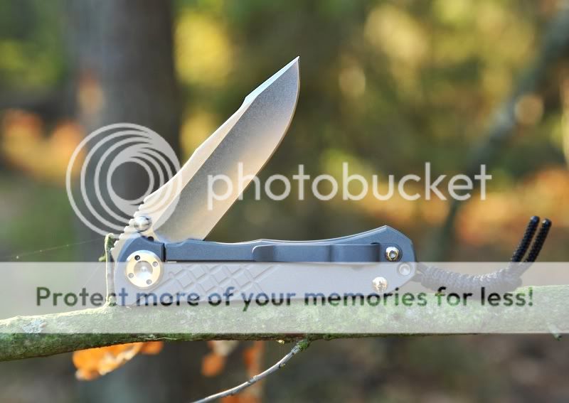

Piter, good trick on the improvised takedown tool!:thumbup: Made one last night and took my Umnumzaan apart to check it out. Went ahead and cleaned it up and then applied miltec lube as that is all I'm using now. Put it back together and this is not one where you can tighten down the pivot all the way, like you can with the Sebbie and it's bushing. The pivot is a big one though which should improve the opening action and the strength. In fact it looks to be the size of my Strider AR's pivots. I did notice that CRK used loctite on the pivot screw, but I didn't use any when I put it back together, though I did make it a little bit tighter, but not much. I'm going to see if the screw begins to back out before using any loctite, but I figure it will stay put where I put it.:D:D Just a great knife!!:thumbup::thumbup:

My idea is to grind the sharpened clip off :p if only I could decide if I actually like it or not. I'm undecided. It just puzzles me why a sharp edge would be protruding from the back of the knife when closed. Though admittedly I haven't cut myself or more importantly, cut the pocket off my favorite pair of old jeans yet :p
Is there any blade play? If you tighten the pivot screw, does the action get tougher and tougher? If you loosen the pivot, does blade play develop?

pbubsy, did you get my email? If so, how did it work out? To answer your question about the pivot Django. As far as I can tell, if you completely tighten the pivot screw the blade will not open. That being the case, I assume, if you leave the pivot loose you will be able to get some blade play.

I got to handle one the other day while fitting her up for a sheath,
the pivot is quite a bit larger than the end of the knife, more so than
the Sebenza, but as pointed out, it is one sturdy knife! well, both are actually,
but the nod goes to this new boy on the block for sure, also I like the longer
blade's straight edge with the curve coming closer to the tip.
My only nit pic would be the sharp swedge on the tip, I often press down on the
back of a knife for cutting through some material and that would be a bummer
to slide onto that!
for example, two weeks ago I was installing some of our equipment and had to cut
a section of 4 conductor power cable, thick stuff, pulled out my Swiss Army Tool
and had to press down HARD on the spine of the knife to push cut through the cable,
which it did, but if it was the 'Zaan I could have been in a pinch...
If I did get one, I'd be rounding that rascal off for safety sake pretty quick, others
for Tactical reasons may want it to be more edgey, that's fine, but for me I would
find it to be a danger...
