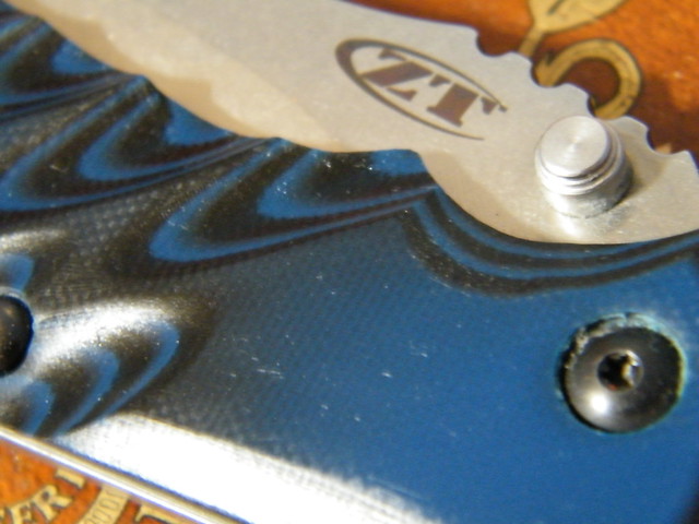

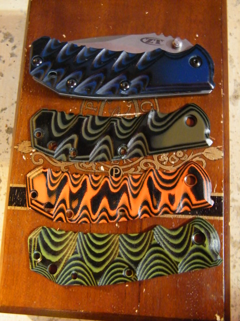

Did several 0550 scales this weekend...trying out a new technique...I guess you can call it "the fade". Its a combination of my faux bolster pattern, with an Anso bottom, however the top color (blue) fades slowly from black at the bottom to blue in the bolster....I'd be lying if I said this was easy....I have one in green/black too:-)
was a busy weekend, lots of colors for the 0550!
Began with the toxic jumbo anso....the orange/black was a spare piece that I tried my first fading & contouring on....from there I went to the green/black. My initial plan was to just have grooces for each of my fingers...from there i added some on the opposite side to off-set it...the fade came natrually, as I was creating the faux bolster, I just experimented with a few different files & grades of sandpaper. The blue/black was last, putting the different things together...They are still a little shiny from final cleaning...hope you like color:-)
P.S. I'll be posting a youtube video featuring them tonight!

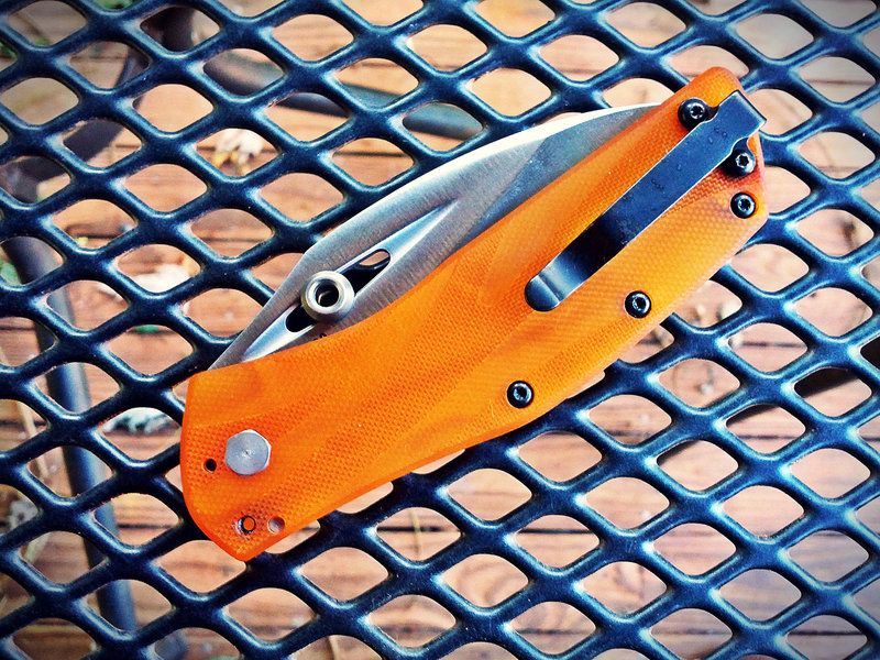

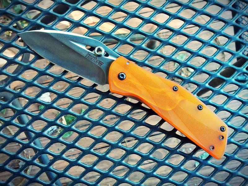

So In the spirit of this thread. Had an idea while looking around for presents for the guys this year. I was looking at the select fires and seen they were 3 and 3/8" blades. I remembered the blur also has a 3 and 3/8" blade! I was wondering if it would be possible to put a blur blade in the select fire? Like an s30v blem or something. I have a blur but not a select fire yet. If anyone has both try and take a look to see if it might work minus the detent
