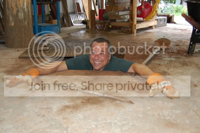

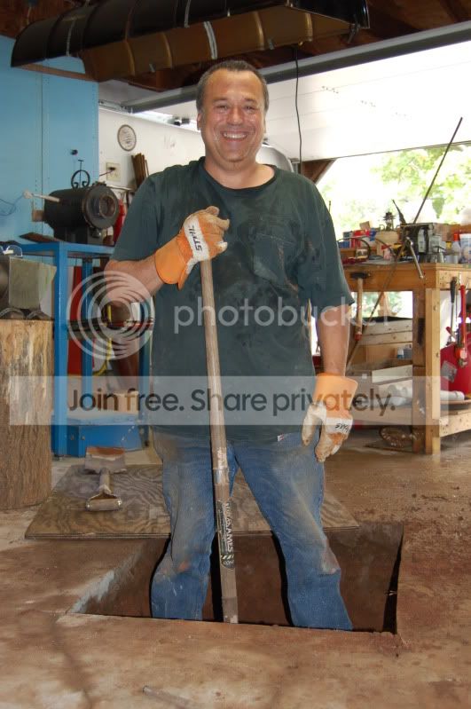

Well I dug the footing for the hammer. I just couldn't remember if it was suppose to be 18" or 18':D
Not only that, you did it twice! Funny guy! Make sure you put a few drops of blood in the concrete mix. Never hurts to make an offering to the shop gods.
That's a purty hammer dave, I want to see it after it gets all dirty. Congrats, you look like you are already having lots of fun with it and you ain't turned it on yet.

I have seen these 25s run just fine on regular garage floor concrete. Why the extra footer? I'm getting a 25 in a few weeks and would love to hear your thoughts concerning the "specs" as listed by little giant. Unlike you, I can't cut my floor to make a footer.
Deloid - "Just fine" isn't optimal. The mass of a heavy foundation block under the hammer keeps it rigid, and allows the hammer to actually use most of the energy flying around when you're running it.
If anything other than the moving parts are moving, while the hammer is being used, it should have a better foundation.
Dave is doing this right :)
And it's right in Little Giant's specs, FWIW :)

I have seen 25's just on standard 4" floors that worked fine. I have seen several that were on the prescribed heavy block and they would work circles around the ones just on a floor.
My 100 is on a giant timber "float" that is all bolted together, and then bolted to the floor. It is very inefficient as compared to one like Don Hanson's 100's which are footed properly. Of course it's amplified with a 100 simply due to mass in motion.
I think the timber idea would work pretty well for a 25 though, if you cannot cut a hole in your floor (which I can't currently do either :o).

Yeah, a 25 is a pretty small hammer. The OP has the 'correct' approach, but you could float that little guy on a platform and be fine.
I've been running a 50 on a platform --- a 3/4 inch steel plate over horse-trailer mat (3/4 inch rubber), over 5/8 plywood. Works quite satisfactorily, though a dedicated foundation would be optimal!:)
