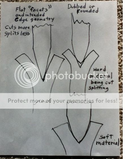

Its not that convex edges are better or that flat edges are better, its that the majority of people can produce convex edges. Its not the case when trying to produce a "flat" edge. Few if anyone can produce a "flat" edge without a control system, no one I know. If its free hand its convex.
Regards, Fred
Done properly, both edge mechanics will work fine. Blanket statements to the contrary are formed by a limited understanding and poor sample groups.
The major advantages are that when compared to a V bevel with same cutting angle, there is less meat behind the edge when all the other dimensions are the same (spine thickness, width). The creation of a convex from a V bevel is a reductive action, you remove steel from behind the edge, not round the edge over and leave the sides the same.
They don't penetrate with more wedging but less, hence back to the felling axe vs splitting wedge analogy. Also backed up by CATRA testing to some extent in terms of longevity, a test that tends to favor thinner geometry over other factors such as edge finish.
On a sample of tools ground from thin stock one would likely not notice any real difference between the two for regular cutting tasks, only on chopping jobs involving ballistic immersion cuts with a lot of force are you going to readily feel a difference.
If you're noticing a real failure of the convex edge, the final edge approach is too broad. Arguments that industrial tooling is all flat ground are also somewhat baseless as most of these have multiple bevel and relief facets that mechanically are somewhere between a convex and a two facet V bevel anyway. From an industrial standpoint, there are specialty shops that will repeatably make a cutting tool with smooth convex approach to the cutting edge though this is not as common.

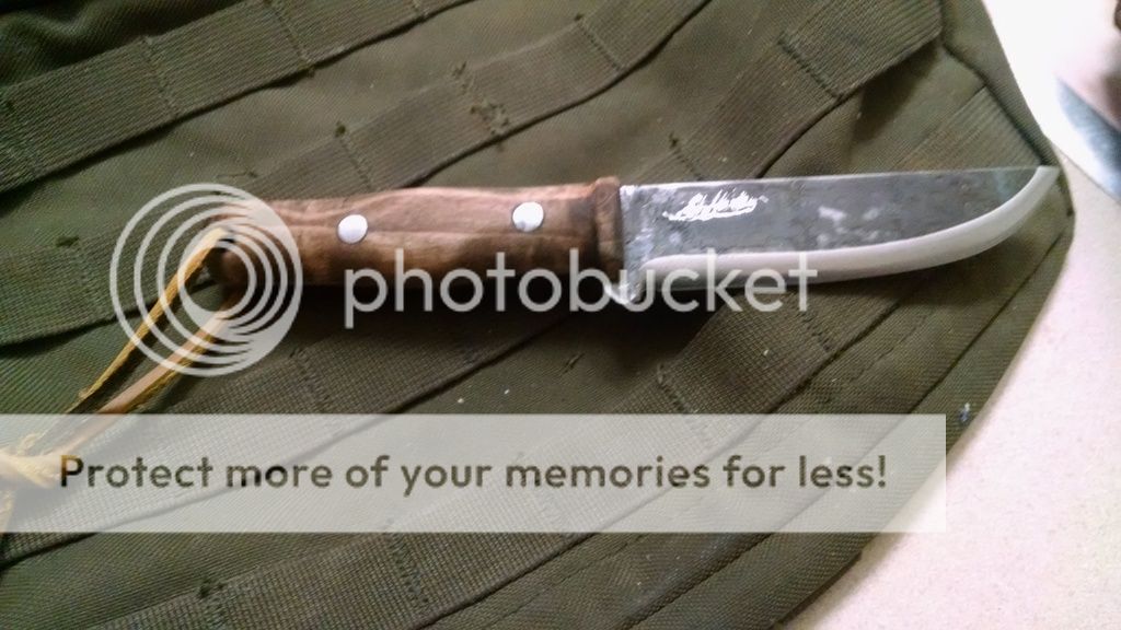

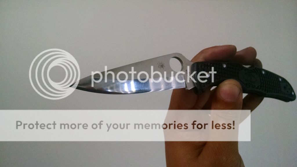

I finally had the courage to take my convex Bark River PSK to my Spyderco Ultrafine ceramic stone. I wasn't trying to reprofile it with a 'V', not this time. I tried hitting the shoulders a little and made sure to apex the edge to take some tiny chips off the Elmax edge. The ultrafine ceramic takes steel off so slowly so there was some room for error. This was just a minor touch-up run before stropping with green compound. It cuts well now and has a smooth transition into what looks like a mirror-polished secondary bevel.

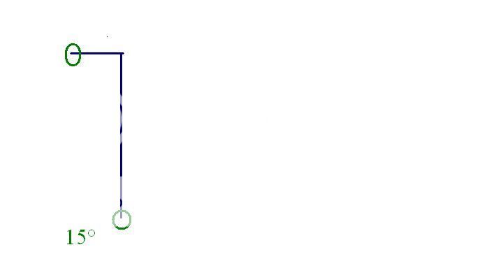

Fred, I'll give it one more try. The diagram shows 1/2 of a blade cross-section. We hold the spine width to a constant, the distance from spine to edge as a constant, and the angle of the edge as best it can be measured to a constant. The original blue line represents the boundaries of our V bevel. The ochre line is the region I ground down to make my convex, and the red line is now the new "gothic arch" of my profile.
You could grind another flat from the top point of the arch, but where it meets the edge it will have to be more acute, only the last tens of microns are available to meet the new facet. Even if you could squeak it in, a few passes on a stone and the upper and lower facet intersections will be gone yet the final angle value will remain the same (and less mass yet again as a result).
Only if you convert the flat primary/cutting facets to a FFG originating at the spine (morphing it from a quadrilateral to a triangle), will I be unable to ground the intersection into a curve. This will also greatly shrink the cutting edge angle.
Anywhere there is an intersection of two straight lines on a polygon (no matter the degree until it becomes a straight line), the two lines can be joined by an arch that will reduce the overall surface area, yet retain the orientation of the lines to either side = less mass on a 3D item while the degree value between the two stays the same. It is always a reduction in area. If you don't care about the final cutting angle, then yes, the FFG will have less mass, but this also violates the three constants we started out with.

...The diagram shows 1/2 of a blade cross-section. We hold the spine width to a constant, the distance from spine to edge as a constant, and the angle of the edge as best it can be measured to a constant
... if you convert the flat primary/cutting facets to a FFG originating at the spine (morphing it from a quadrilateral to a triangle)...
This is where HH has so much trouble, recognizing that the "spine to edge" distance is irrelevant to the geometry of the bevel. The bevel geometry is from the edge to the base of the bevel, not the spine of the knife which could as easily be larger than 12" or smaller than 12 microns. By basing his argument on that distance, he is equating a pentagon with a triangle, not recommended. He knows his argument is wrong because he is forced to admit that an FFG blade proves it so - one cannot "convex" such a blade to be thinner than it already is without changing the bevel height and/or base thickness, although one CAN "concave" it thinner via a hollow grind.
What HH is saying is NOT that convex is thinner than flat, but that if you have a blade with a "shoulder" between two bevels, he can cut another bevel or set of them (a bevel being a physical property with a precise width that starts at one point and ends at another) in place of that shoulder. The bevel he adds would of course be thinner if he cut it flat between those two points. But the point he is trying to make is NOT that convex edges are thinner, they are demonstrably NOT, but rather that a thick blade can be back-beveled with a convex profile that is thinner than its previous profile. This is so.
