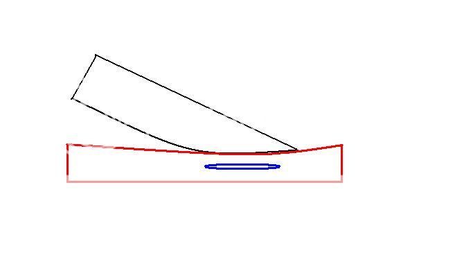

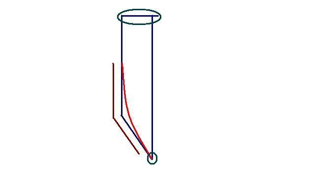

Are you still comparing two blades with equal near-apex angles? (as in your drawing below)
The way I see it, the V-bevel has a larger contact area with the strop than the convex bevel at the terminal sharpening angle. So, in fact, the pressure is higher on the strop for the same downward force on a convex bevel than for a V-bevel.
Here's the principle behind convex and stropping - is the same as if you angle the shoulder back into the leather on a V bevel though it still work more reliably working against a curve, you don't elevate the spine to just hit the apex. The ellipse shows where the pressure spikes. Used with a black/white compound in combination as many convex mfgs recommend, it concentrates stock removal at the hump, where it needs to stay thinned out for overall geometry to remain constant. Over time it will still be necessary to thin this out, but the strop will maintain it for a long time without appreciable rounding at the apex.

I can see where you are going with the round the edge off the apex thing but
Would you be so kind as to correct the drawing ?

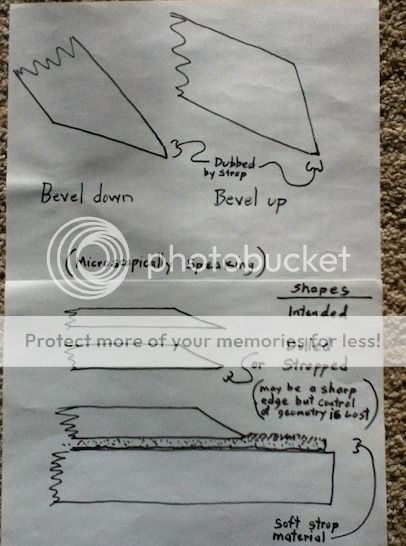

And finally since you mentioned stropping here is one of my non agreeable, or is it disagreeable illustrations. Note it is the best case scenario for stopping, no convex and no small bevel and we still have geometry destroying destruction to that wonderful edge.
Yuck, I can't watch . . .
For a hard strop on the finished side of the leather that is an exaggeration but the majority of woodworkers they use the store bought carver's strop, rough side up, on a plane blade or joinery chisel.
Not good.
As far as knives . . . when I make a ten degree per side angle or a fifteen, you know, for cutting cars in half and stuff. I don't want mister strop coming along and messing with that angle and turning it into, oh I don't know, twenty or thirty degrees per side after a a few misguided sessions on the strop to "touch up the edge" which never really works all that great anyway compared with just sharpening the dang edge with a couple of stones at my desired angle.
PS: those Japanese blades are on the order of 64 hardness . . .how many here can say that about our little girly man pocket knives ?
My issue with your earlier convex drawing is the convex example is notably rounded at he edge and the pics aren't clear enough to show side to material interaction with the V or convex.
No argument when it comes to woodworking with one exception. If the strop surface is hard enough there will be little or no appreciable rounding of the edge - in the order of what one would experience sharpening freehand on a hard stone on the bevel side, and on the flat side no more than what one would get with a muddy 1k-1200 grit JIS. If you bury it on a leather strop, or use it over too long a time, you'll have trouble, but again I don't ever use leather for a strop unless its bare leather for a final few passes. Even then I prefer a linen paper over a hard surface.

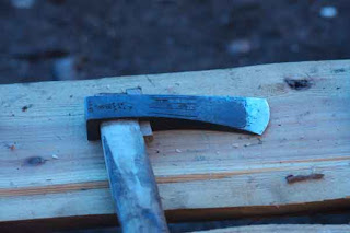

Here is an image of a traditional Japanese felling axe - they DO know a thing or two...
