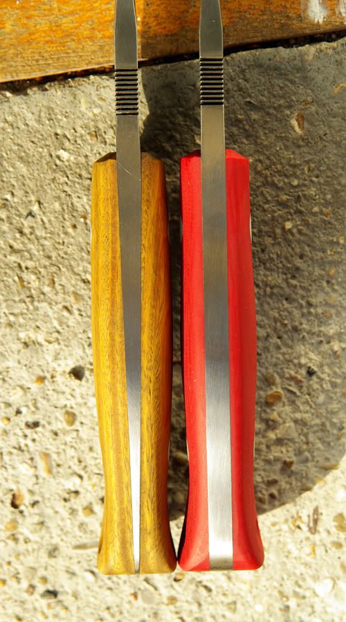

First some pics that show more detail of the knives ..
More later on..

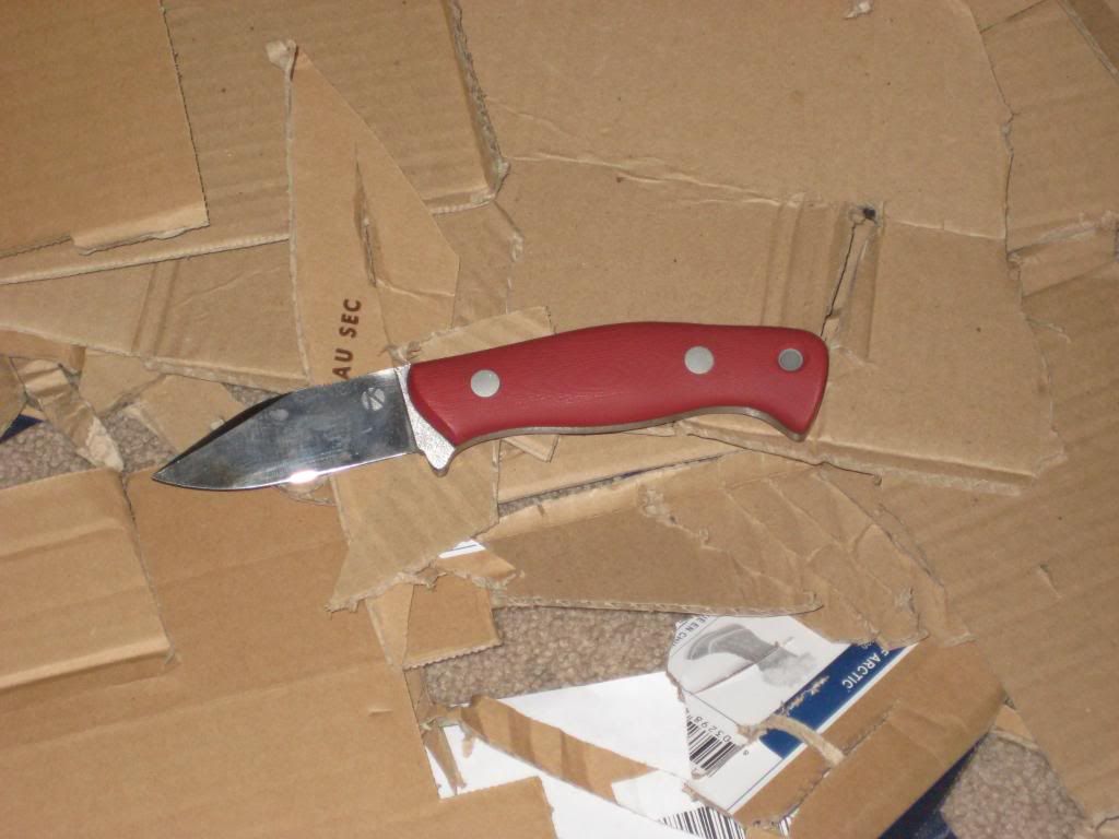

I immediately put it to work breaking down a cardboard box (quite thick cardboard) I made hundreds of cuts (once I had hit the edge with the strop, it made short work of slicing).
This pic is about 1/2 way through all the slicing I did. Needless to say the wife told me to clean up the mess.

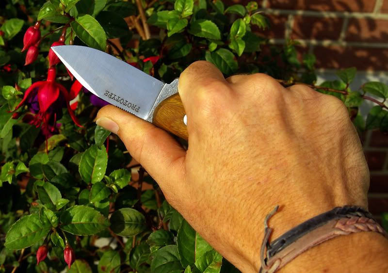

Some in hand pics

Cut the cardboard well, a bit of binding because of the thickness of the blade, but once sharpened on the strop really quickly, it shaved off slices quite well.

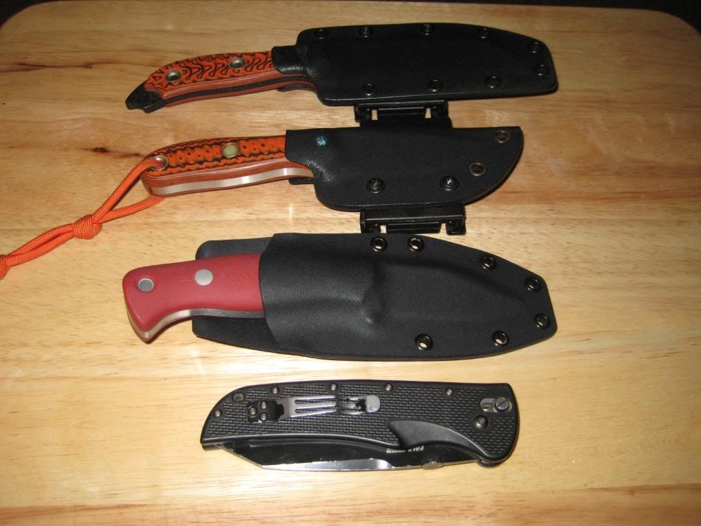

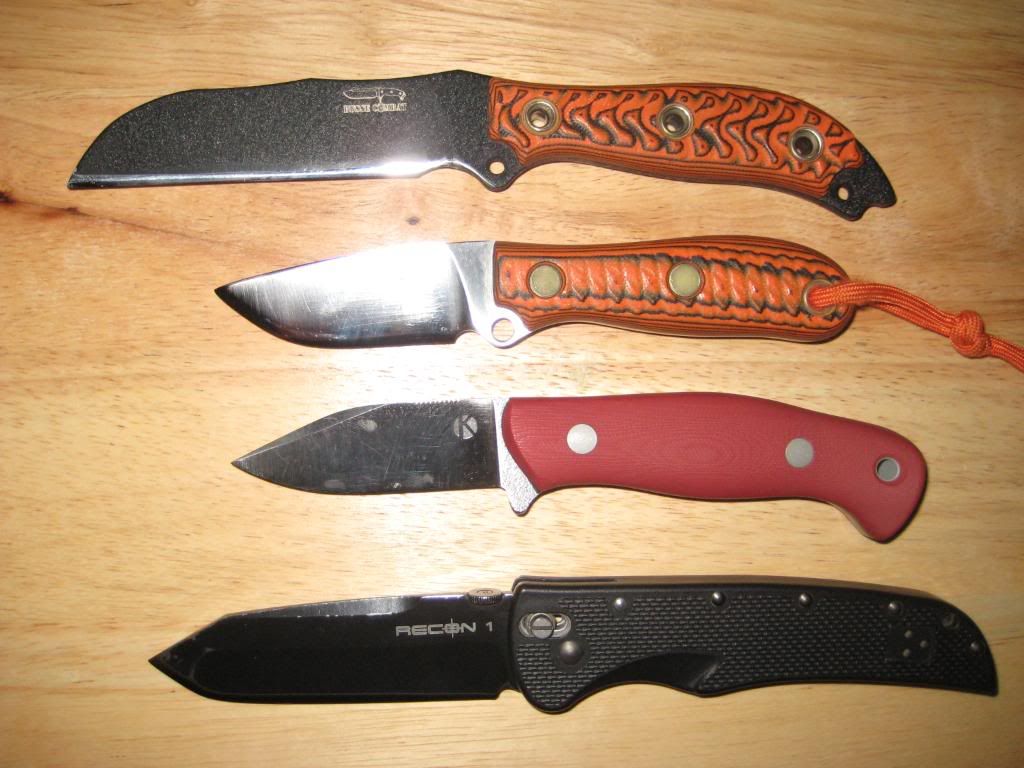

Here are a few comparison pics to show what I normally carry in about this size range (1 longer thinner FB, one the same length blade, but shorter handle, which is .22 thick blade, and one folder that I used to carry every day)
On the belt. Carries very comfortable this way. I normally use a tech lock carry.
One thing, with this sheath, it hangs a bit low for the shirt to cover. I wore it this way to the mall tonight with the wife and kid, and had my slightly longer zip up hoodie which covered it.

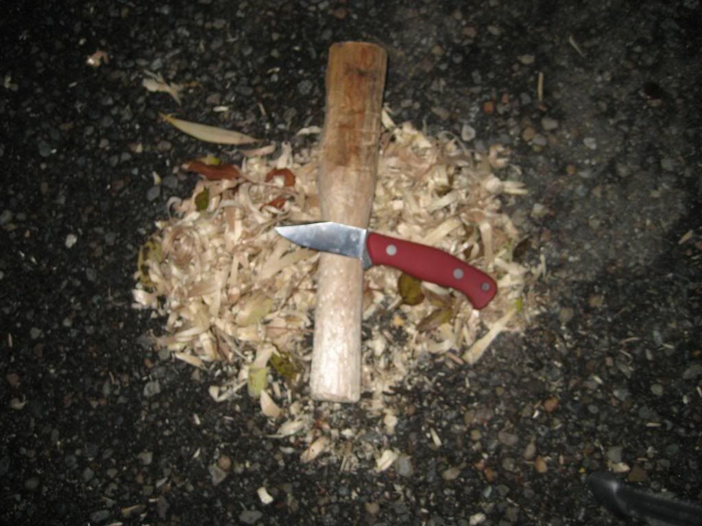

After I got home from the mall, I spent about an hour in the garage shaving a baton, making a pile of shavings. This thing makes a great whittler. Absolutely no wrist fatigue, and no hot spots. With other knives, you get the sore wrist, and it becomes uncomfortable very quick. I felt like I could whittle all day without any problems. Very great feel in the hand, and great leverage with the full handle. Felt perfect for this. The blade geometry make for very very fine shavings easily (think great feather/fuzz sticks). The blade geometry combined with the perfect handle shape also allowed for deep, big shavings with equal ease.
Some quick batoning. I have to admit, I was sure the tip was going to just fall right off with the lightest tap. I was careful with not hitting the tip, but after a while I was a bit more confident. This is not a hardwood, but the knife worked well for the size.
