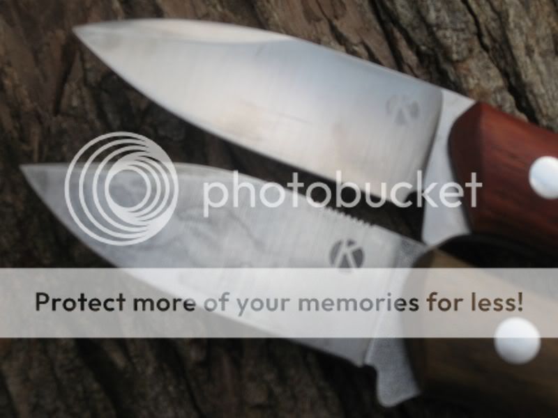

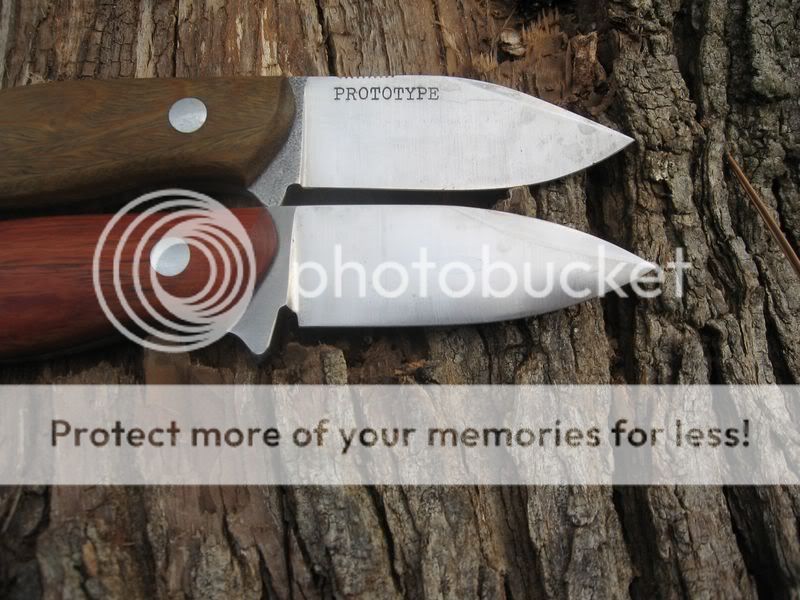

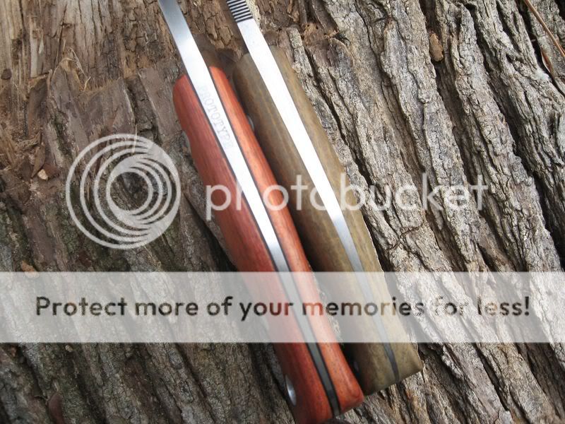

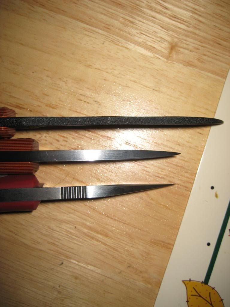

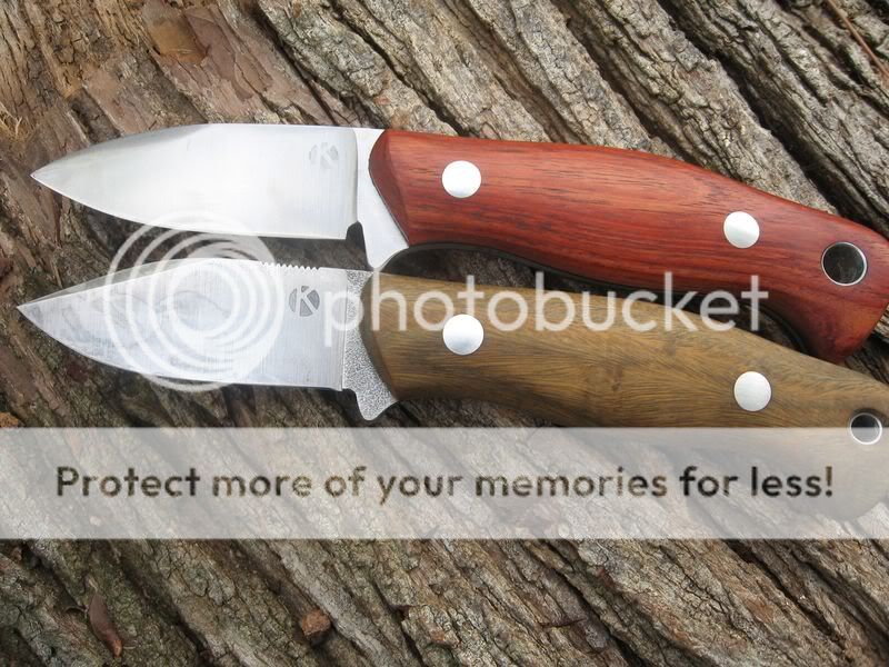

I received the Verawood passaround knife today from Martin. I will show a few comparison pics of it and V3 which i was lucky enough to score earlier. There are several subtle differences although I like them both so far.
The blade on the passaround knife is about 1/16th wider than V3.:thumbup::thumbup:
The handle on V3 is about 1/16th wider than the passaround knife. V3 also has liners.:D
The Verawood knife does not have a grinders notch either. :thumbup:

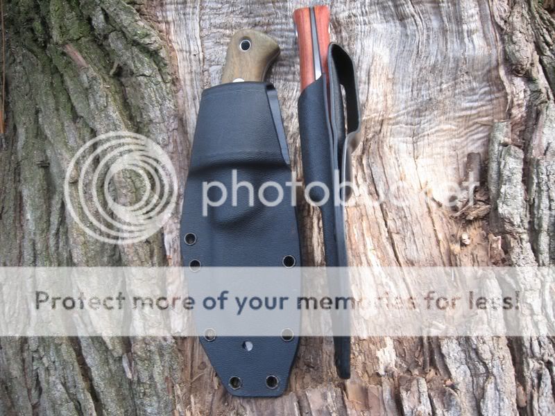

One of the best attributes of these EDCs is Dan's sheath. It is thin enough to just slide in a pocket when a belt knife isnt appropriate.
I will have more pics and comparisons later.

Yes, I have moved away from the "sharpening choil" on the blade. On an EDC....you want to be able to "glide" through materials...and not have any hang-ups. Don't get me wrong...I like the little choils on other knives...and even mostly on this one. But I do agree it is better without it.
I am liking the kydex loop sheath more and more each day....:D

I definitely like the bladeshape of the red knife more.

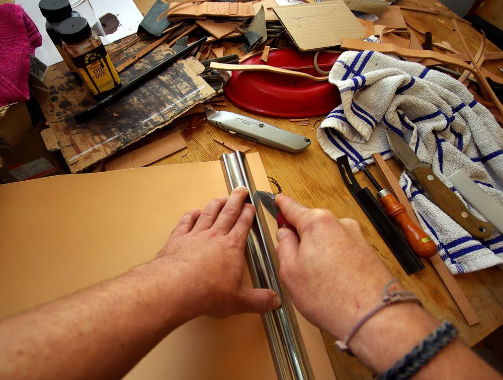

I carried the knives one after another for a whole week and used them during tasks I usually do with my leatherman, my sebbie, my hobbyknife, or my ‘knife of the day’ (think Bushie, Fällkniven NL-5, F-1, Hairy Carry or Bravo-1) This means cutting tiewraps. Cutting sheets of colorgel, as used in the lighting industrie. Cut parts of my lunch (including a hot dog with mustard and ketchup, which quickly formed a nice patina), cut open some boxes and packages, work with leather and kydex. Cutting sticks in the woods, poking coins out of crooked slots etc.
-Cutting cardboard was a breeze. It wedged in denser (dense is the word) types of cardboard thoo.

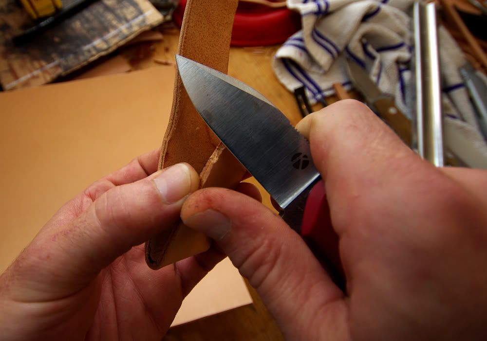

-tiewraps snapped open in a breeze. The tip was fine enough, and the edge thin enough to cut them very efficiently. No wriggling or prying needed. (I had pics of these!). Need to be carefull tho, as the edge is one to be carefull with to keep it in shape.

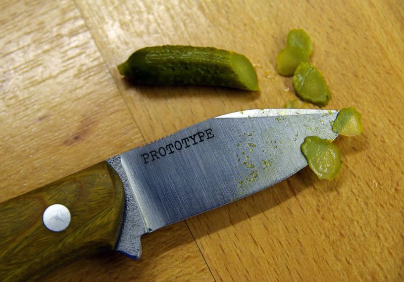

-Buttering a sandwich, and cutting the ingredients felt never so comfortable and inspiring to eat more.

Are very nice and will do the job well, but I do think you’ll have to invest in a decent rivetpress Dan. Split rivets are not.. euhh.. worthy?
Personally I’s like a sheath with a thinner profile, and a clip maybe, which I could comfortable slip in any of my pockets.

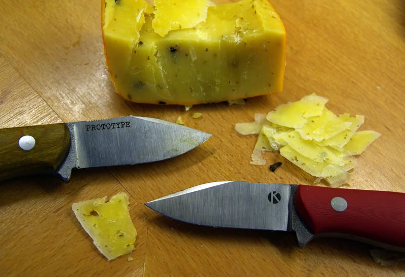

Cutting Old Cheese is hard, as the edge tends to dig in and wedge to a halt
Carefull shavings are very well possible though.. Yummy!
The fine tip (The tip IS fine Dan. It’s as fine as my Leek ;-)) cuts like a Hobbyknife, but so much more comfortable. Here’s where more edgeholding would be a pro.
It’s with the finer work where the Red one is more comfortable.

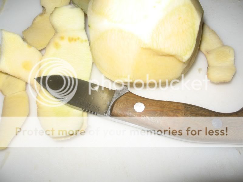

If you live in the south you have to be familiar with rutebagas,not sure about the rest of the country. My wife always call for me to peel and cut them up for her. They can be tough.:mad: I am always scared to use a very thin chefs knife and usually resort to a boneing knife.

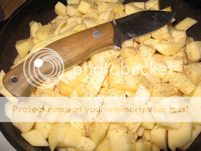

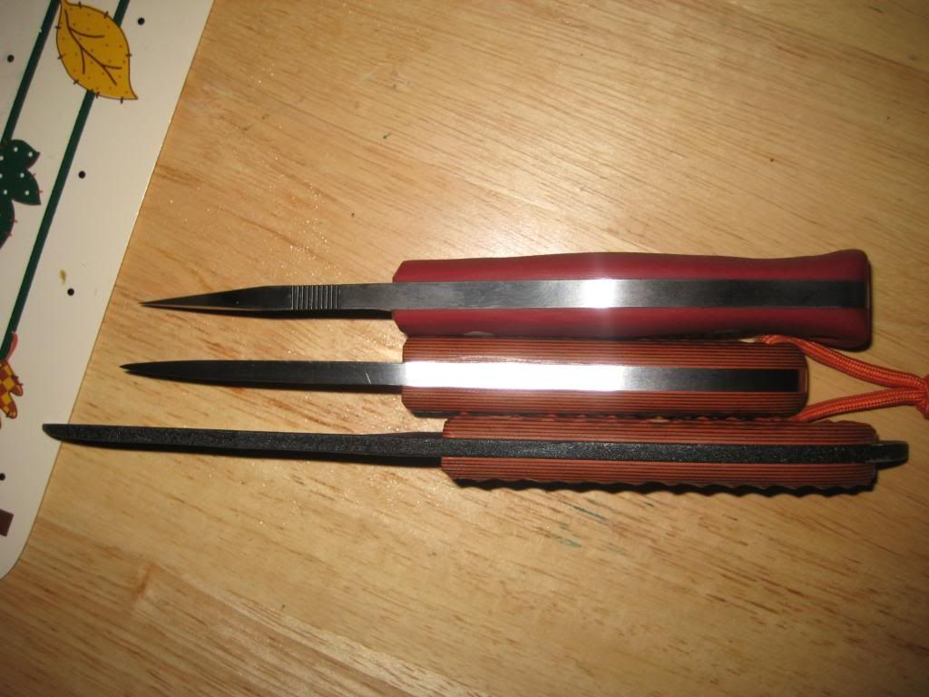

Enter the Koster EDC proto!!:) It naturally could have been a little longer for this task but other than that it was a champ. The handle was extremely comfortable and enabled me to put a lot more force into the cuts than a chefs knife.:thumbup: The full flat grind didnt allow any pieces to stick to the blade. With the swedge on top this blade appears thin but it isnt. The EDC cuts extremely well from the belly out to the tip which is very helpfull to me in the kitchen.:thumbup:
In my opinion this knife begs to be carried camping and used by the camp chef. I think Dan already tested V1 like that.

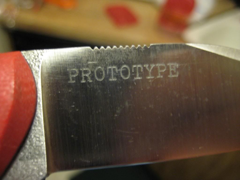

The jimping on the back of the blade was nice, Did not feel too sharp for the thumb. I would like to see the jimping stay where it is, but also add some more jimping behind it, ad some more further down.
The tip was super sharp and pointy. I really like the look of the swedge grind. I would maybe like to see the grind stop a little before the tip, just to leave a bit more meat. I must say that the thinner tip was really helpful for piercing, and poking stuff.

If the tip breaks...I'll reconsider the grind...but for now..I really like how it tapers..nothing worse (imho) than a thick knife that cuts like a wedge, instead of a razor.
