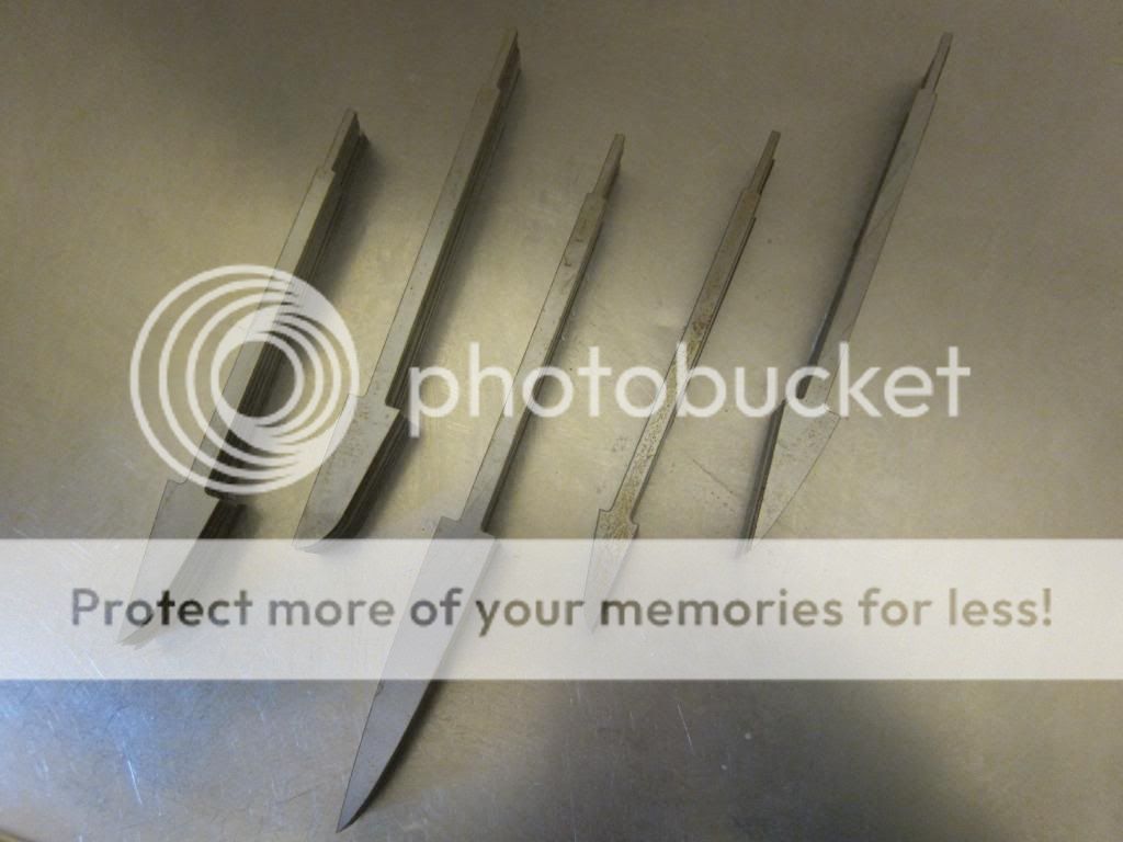

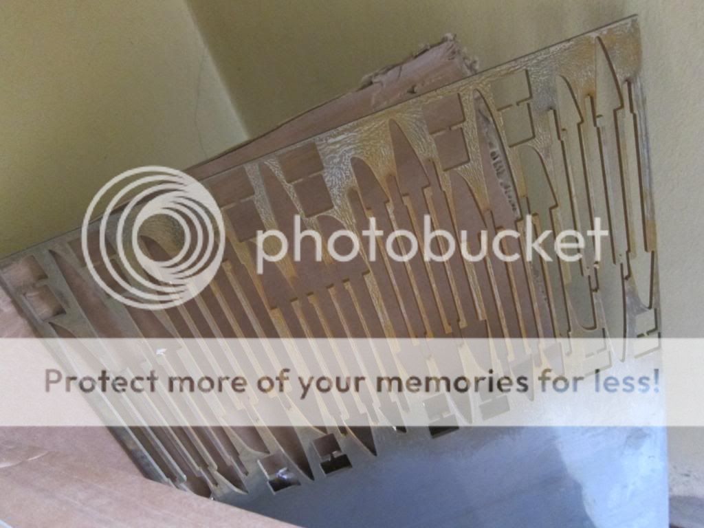

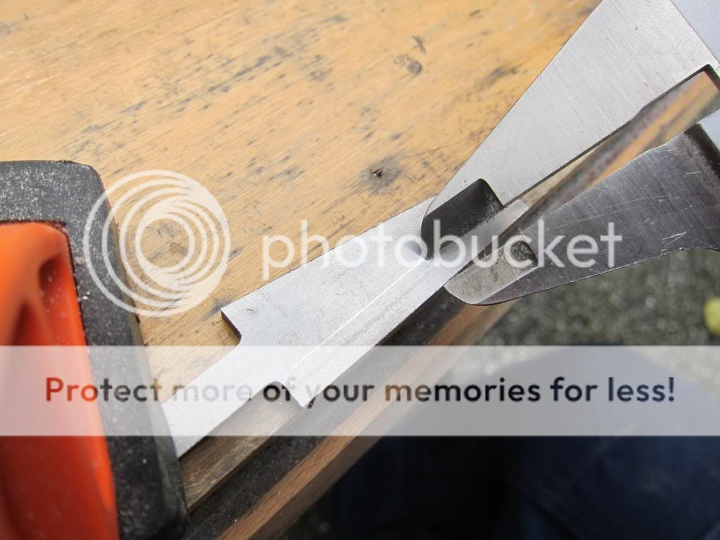

That is pretty tight nesting in your layout. Are you going to use a water jet to cut out your blanks?
The water-jet guy is going to fit them as tight as possible. How tight it will be i don't know. :)

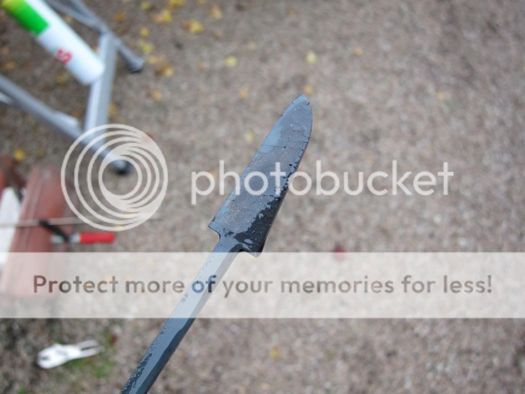

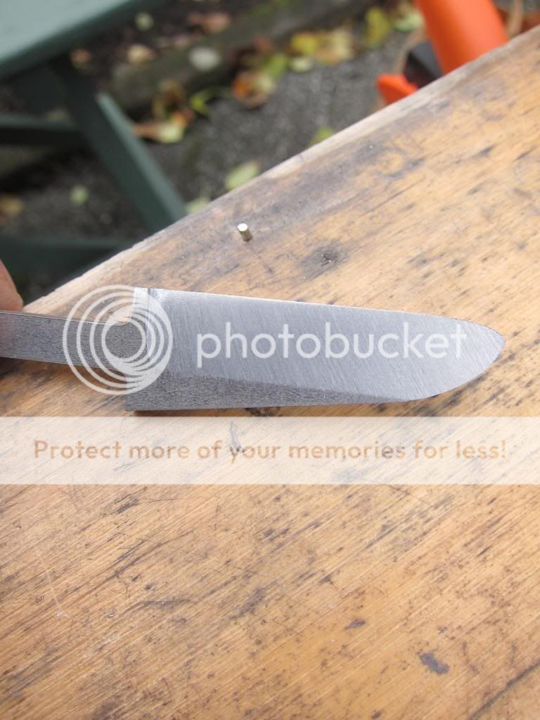

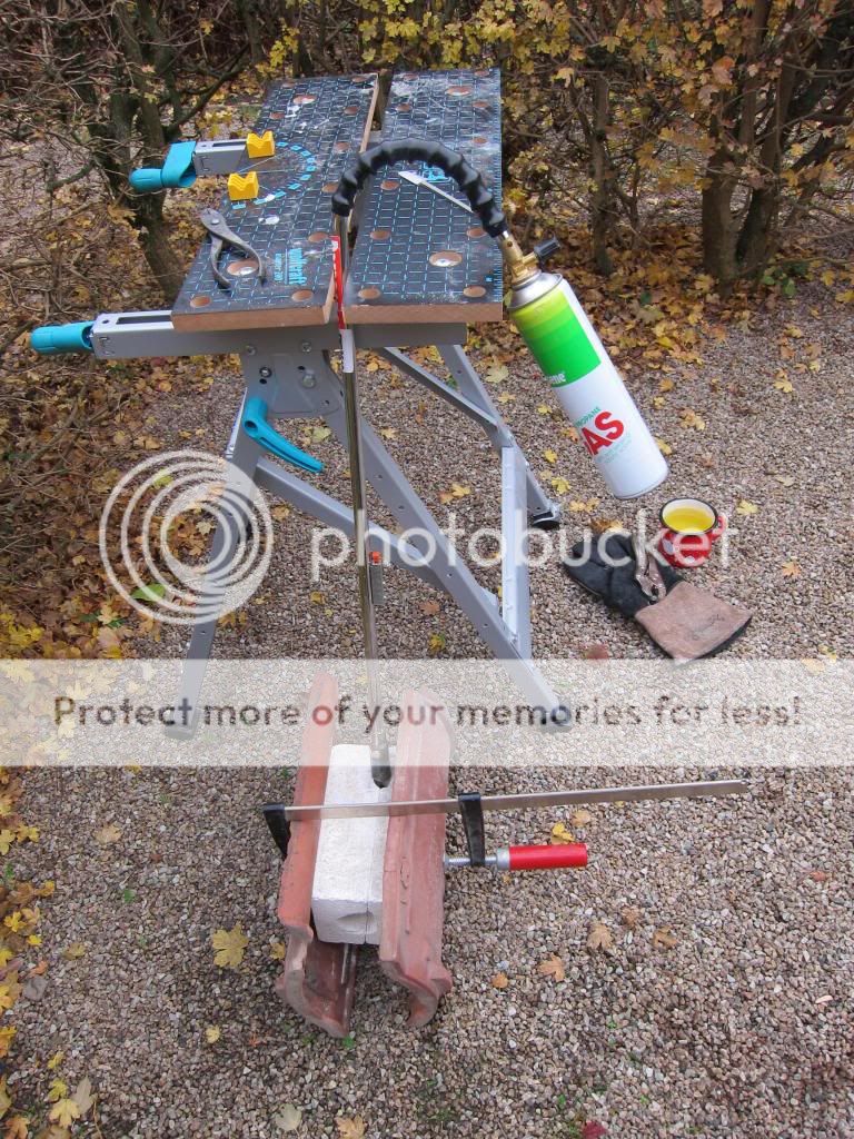

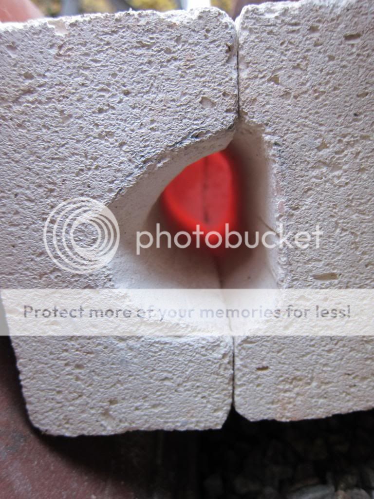

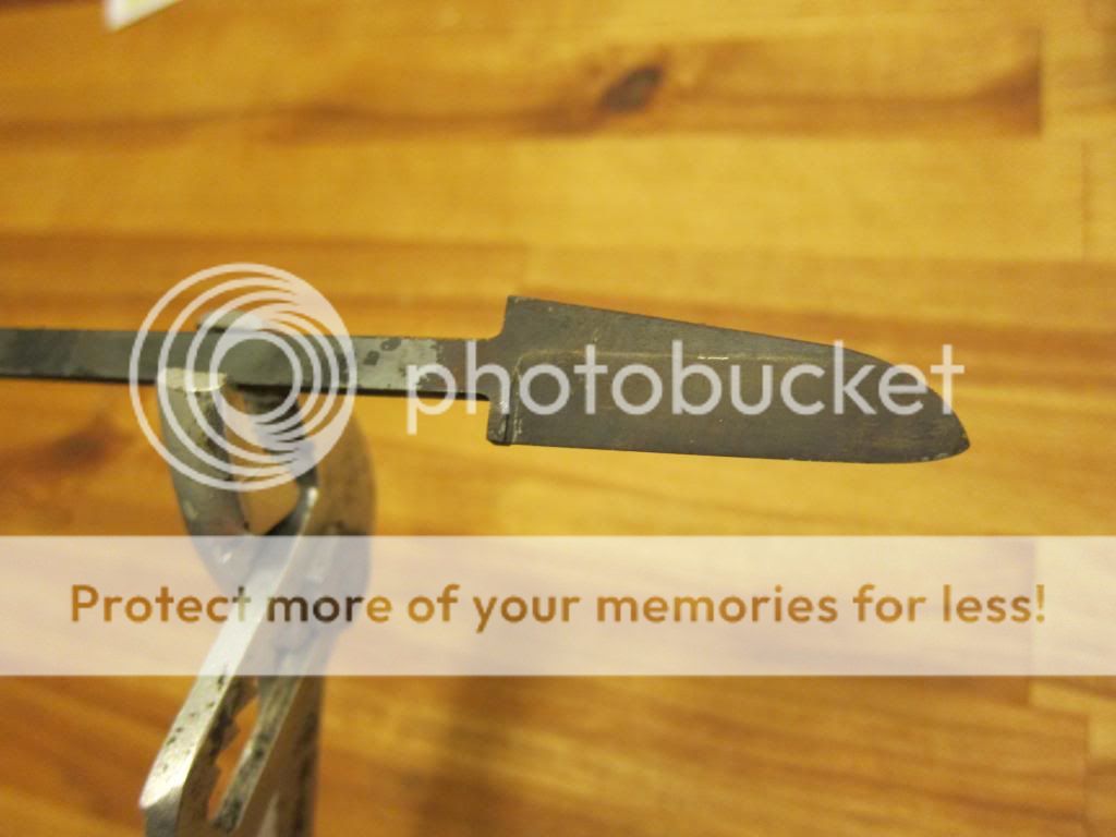

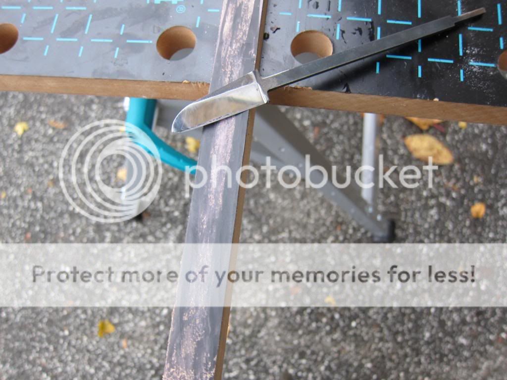

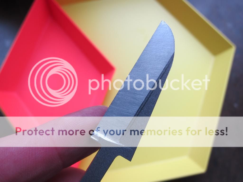

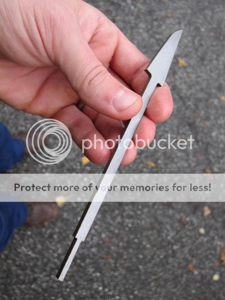

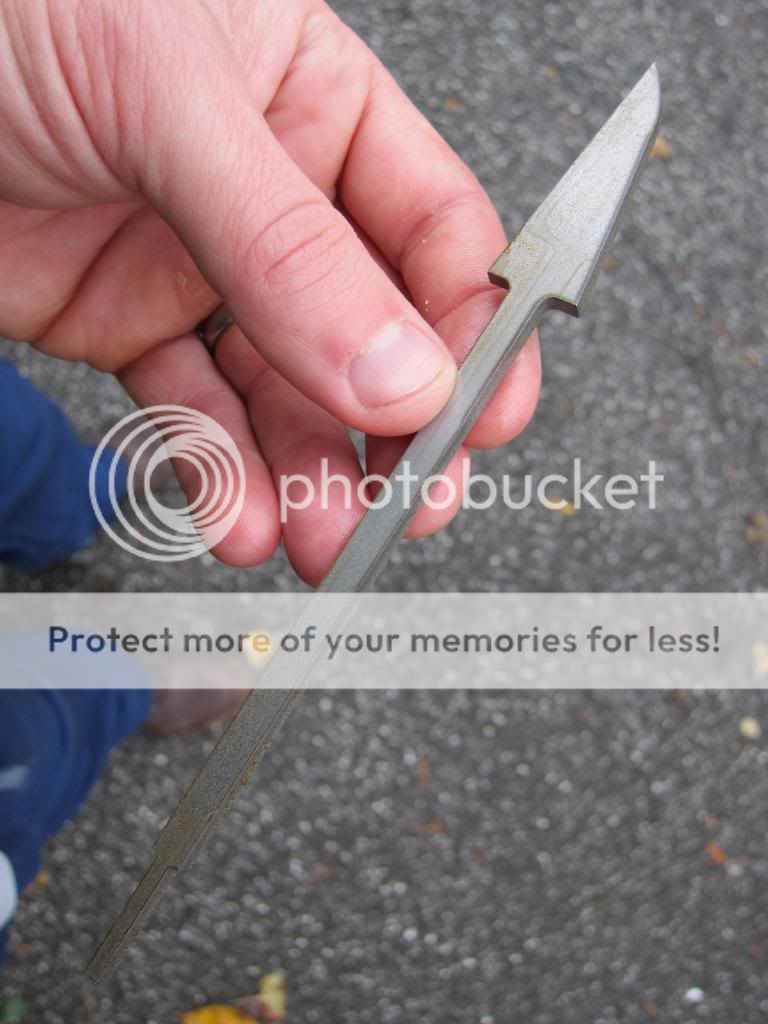

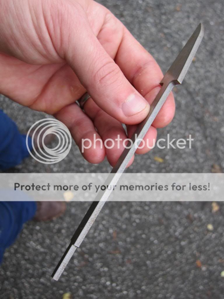

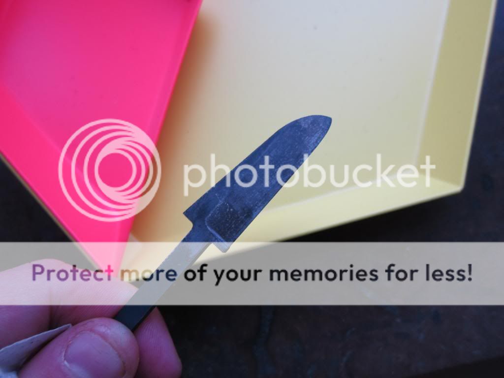

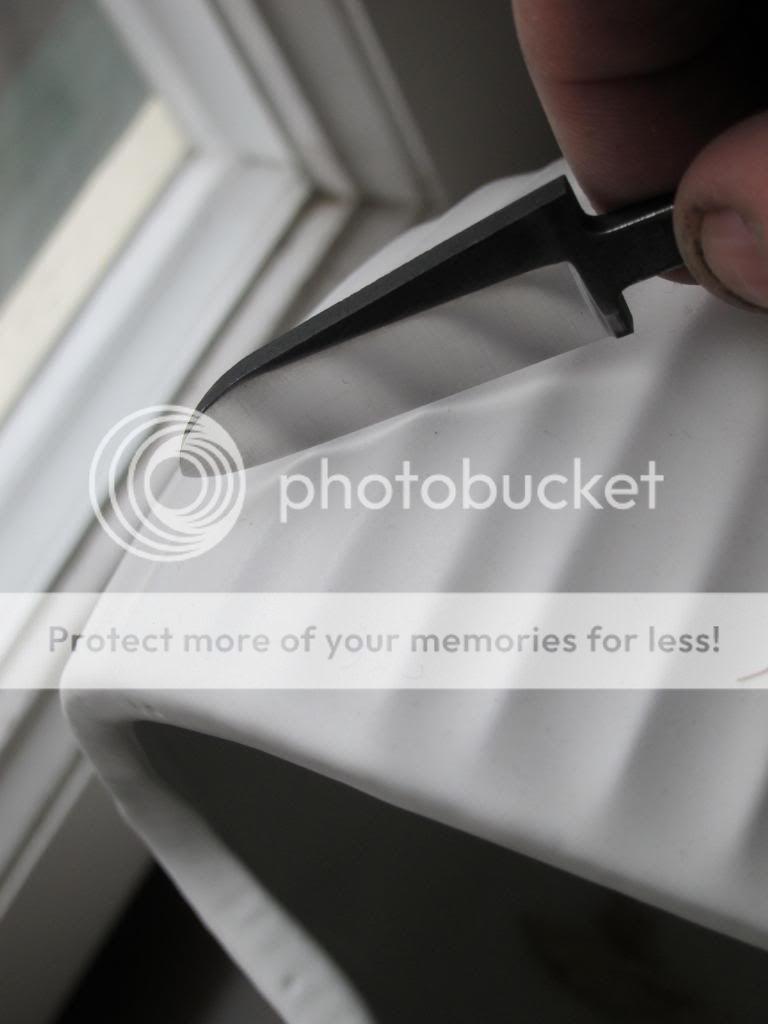

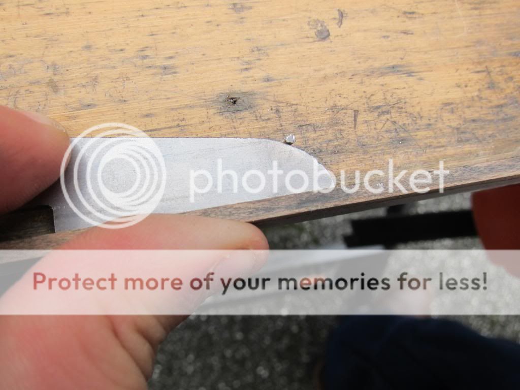

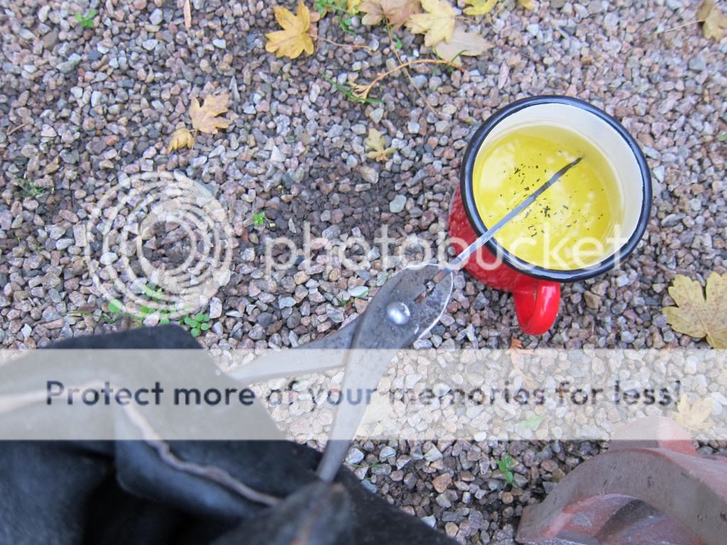

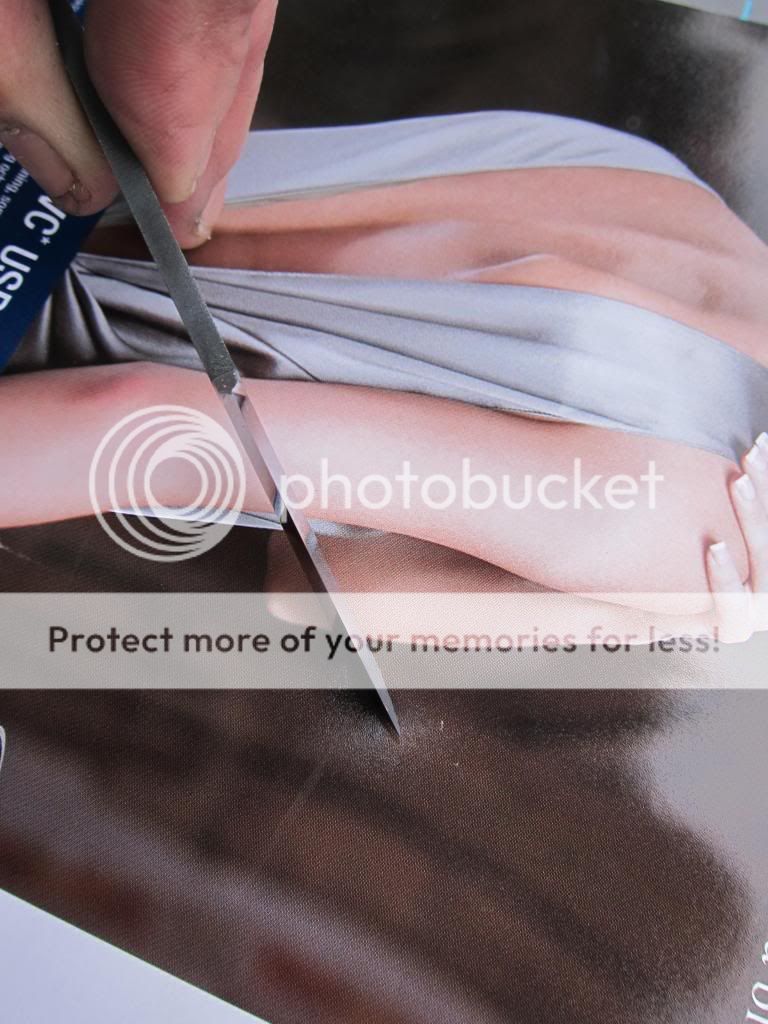

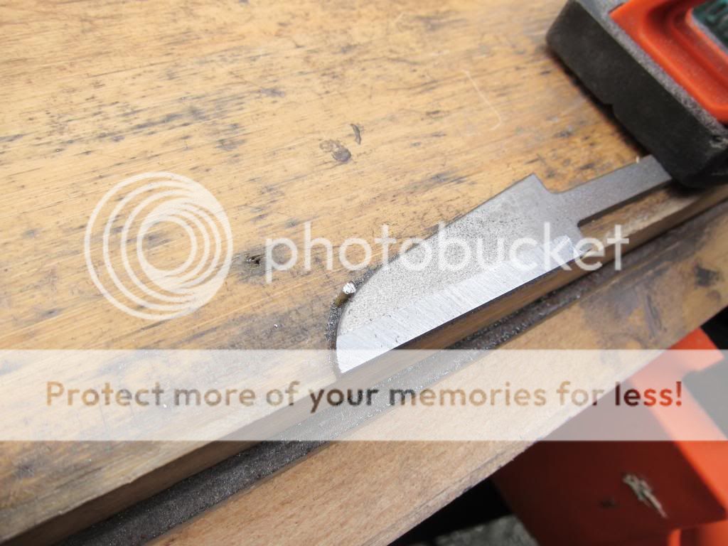

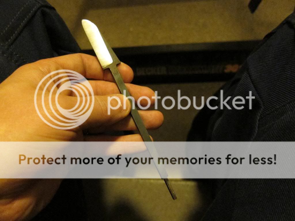

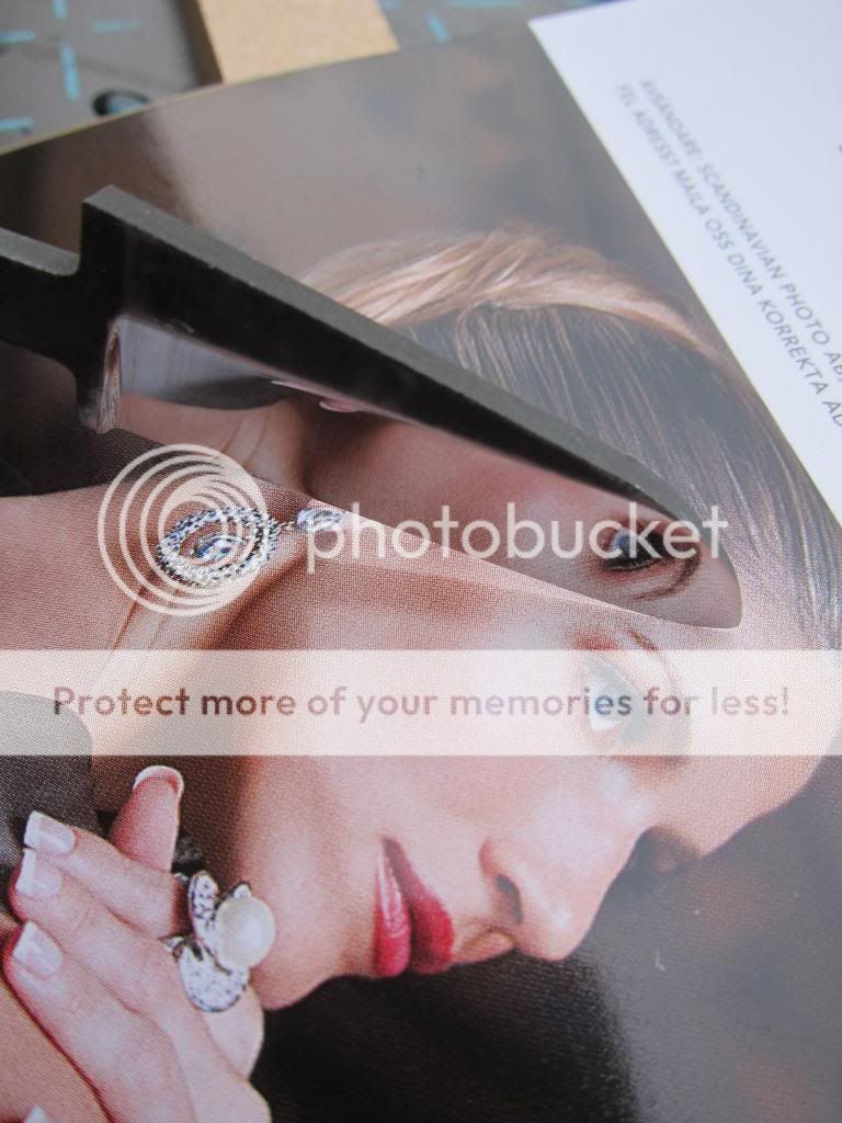

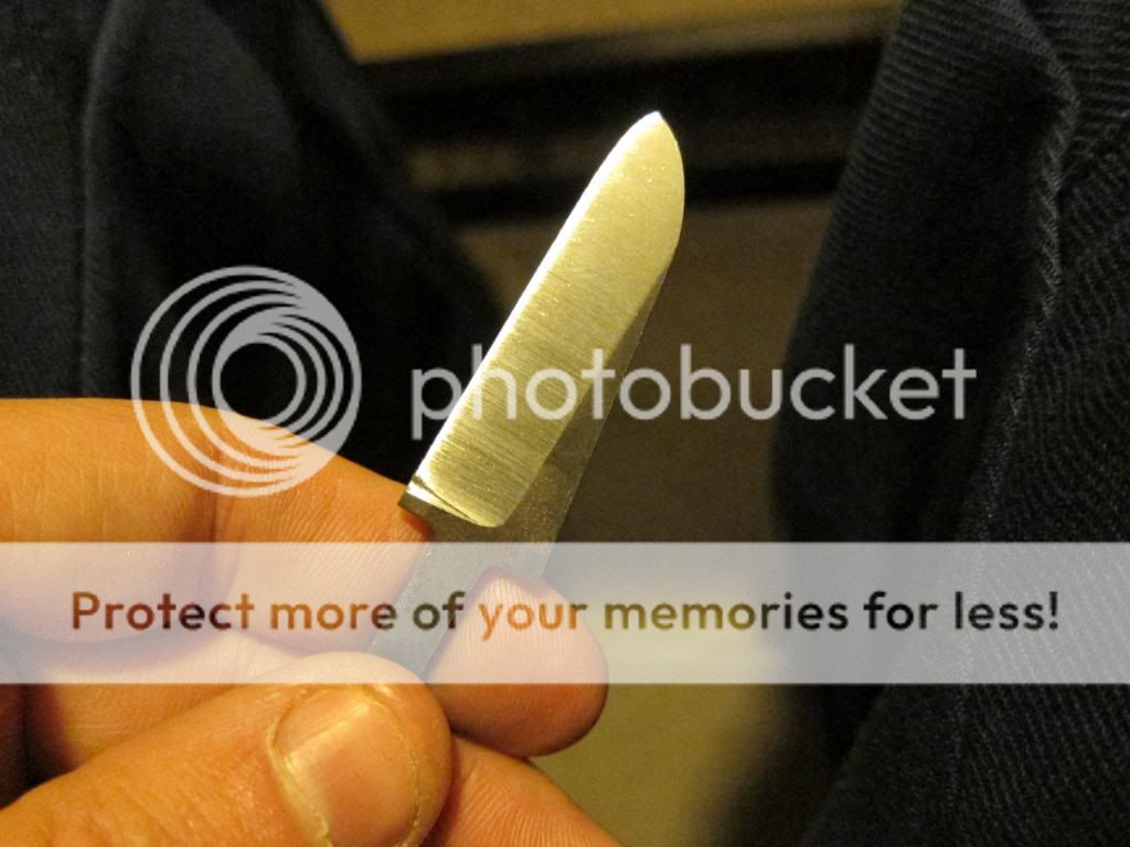

My fist back yard heat treated knife is shaving. The fingers are a bit stiff from being wet all day in the Swedish November weather but I'm happy.
Note

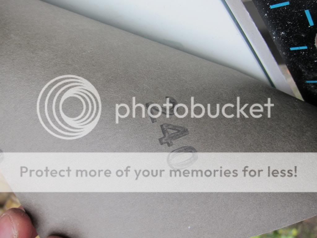

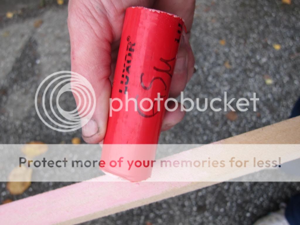

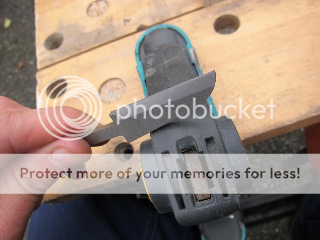

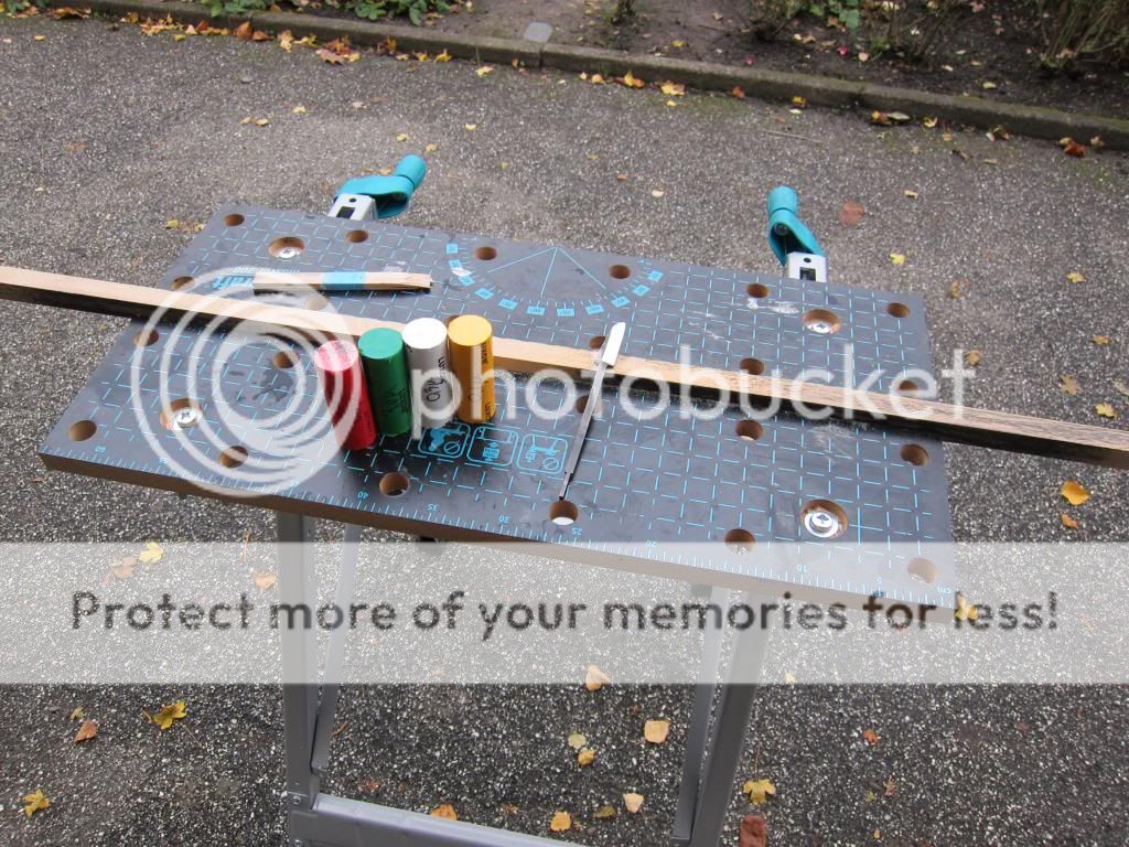

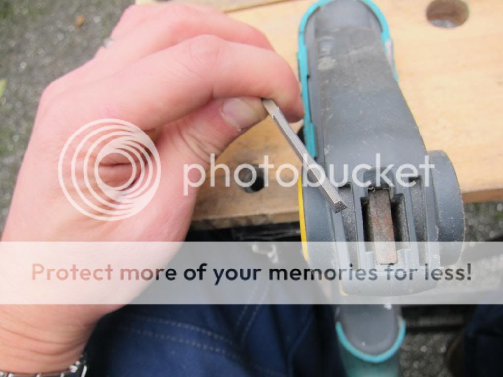

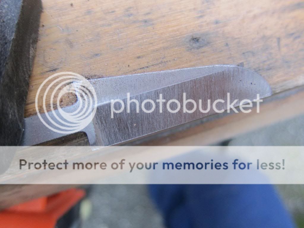

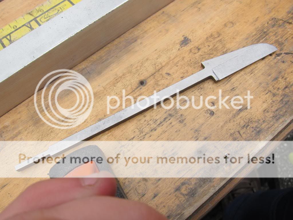

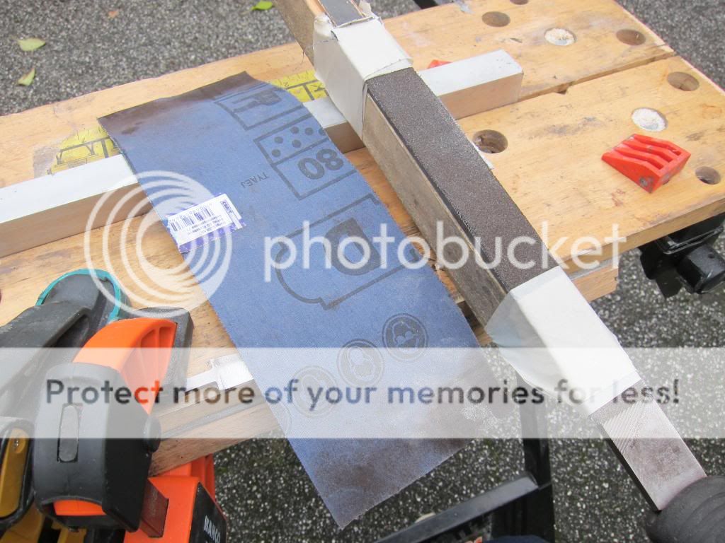

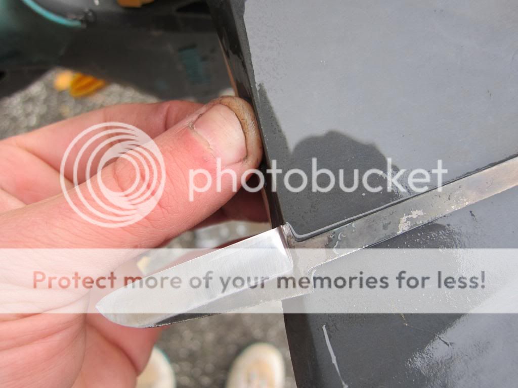

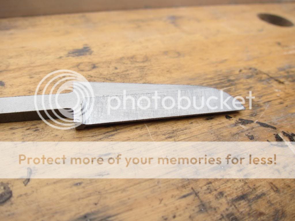

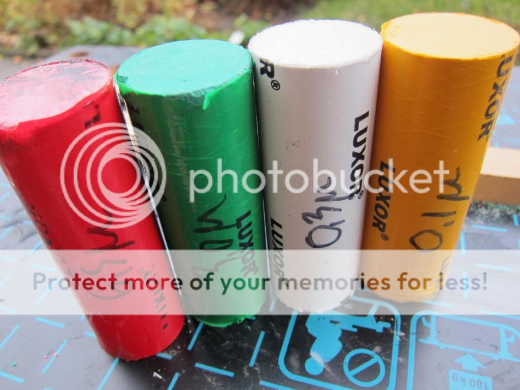

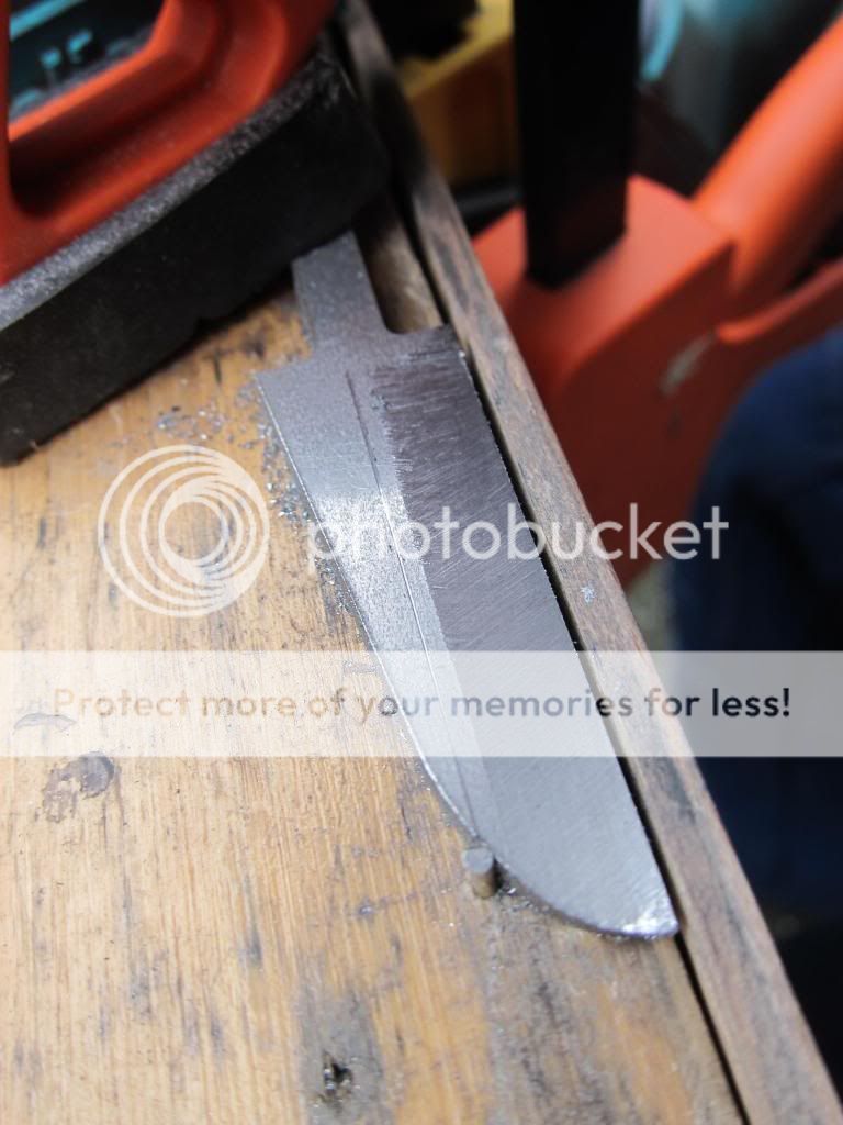

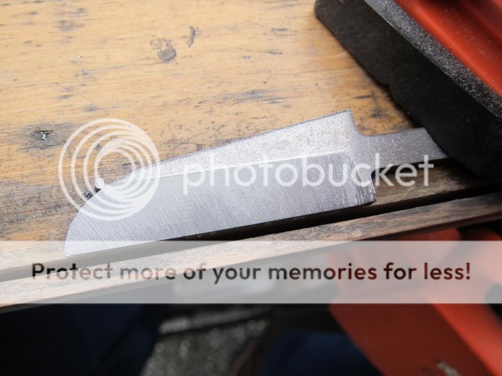

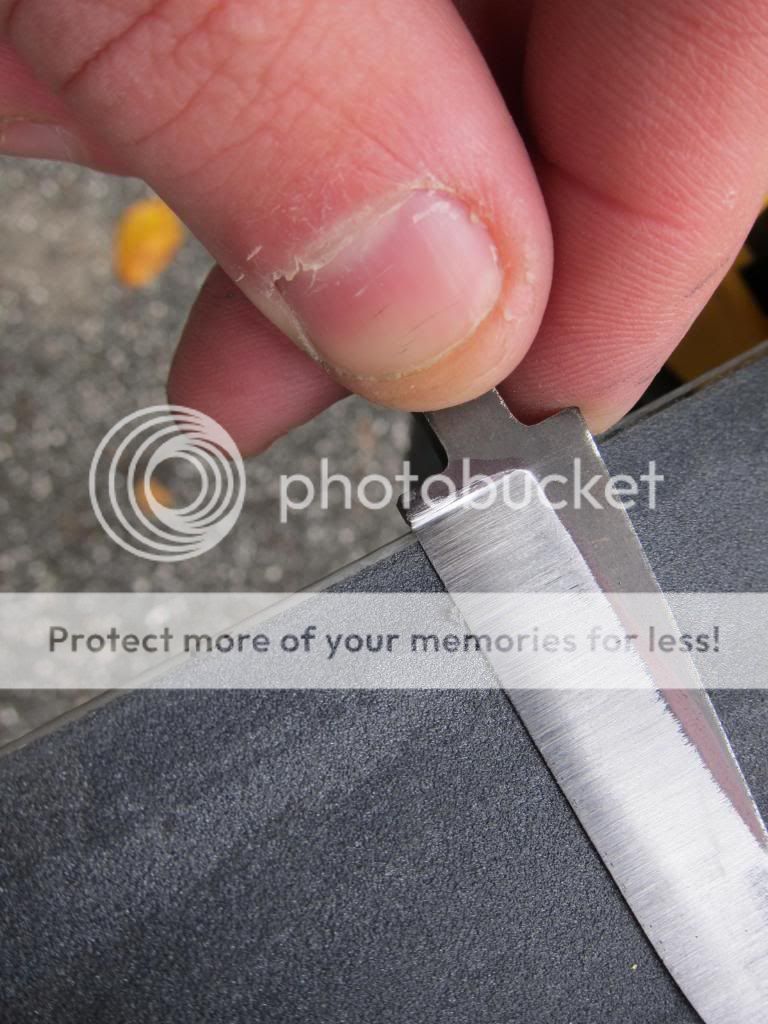

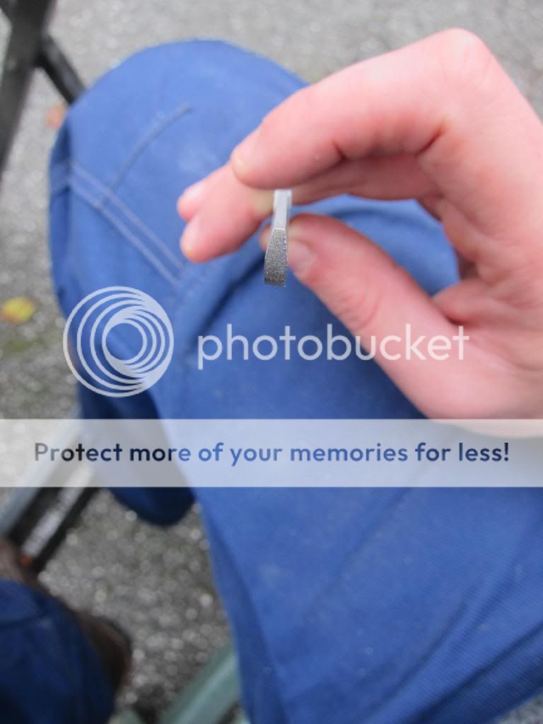

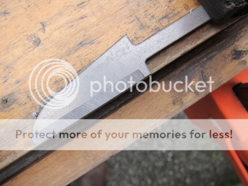

I user 240, 400, 600, 1200 paper on glass, and then polishing compound on a mdf stick. I think that a thin leather on the mdf would have been better but it worked.
Very interesting thread. I always appreciate how crisp, focused and to the point your photos are. They really tell the story. Nice little knife.
