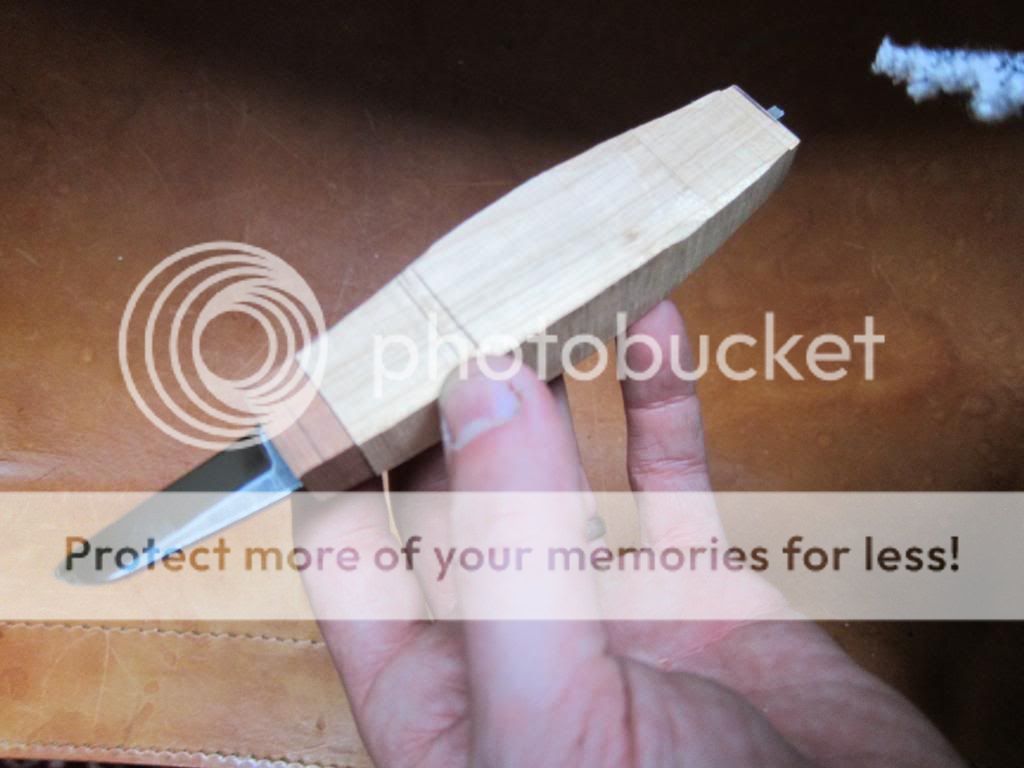

Have you played with any handle ideas yet?

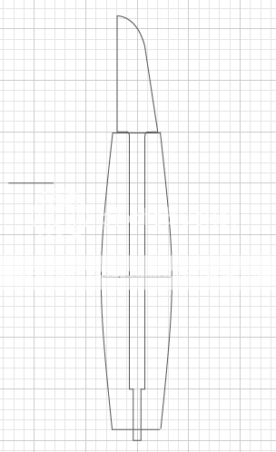

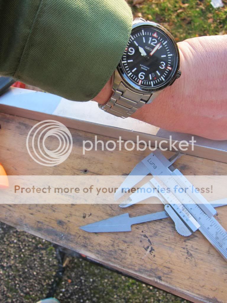

I'm thinking about a long barrel shape. I have a prototype handel that I have been fine tuning for a year. It´s
Length 115mm
Hight middle "side view" 26,5mm
Hight ends "side view" 18,5mm
Width middle "top down view" 22mm
Width ends "top down view" 12,5mm

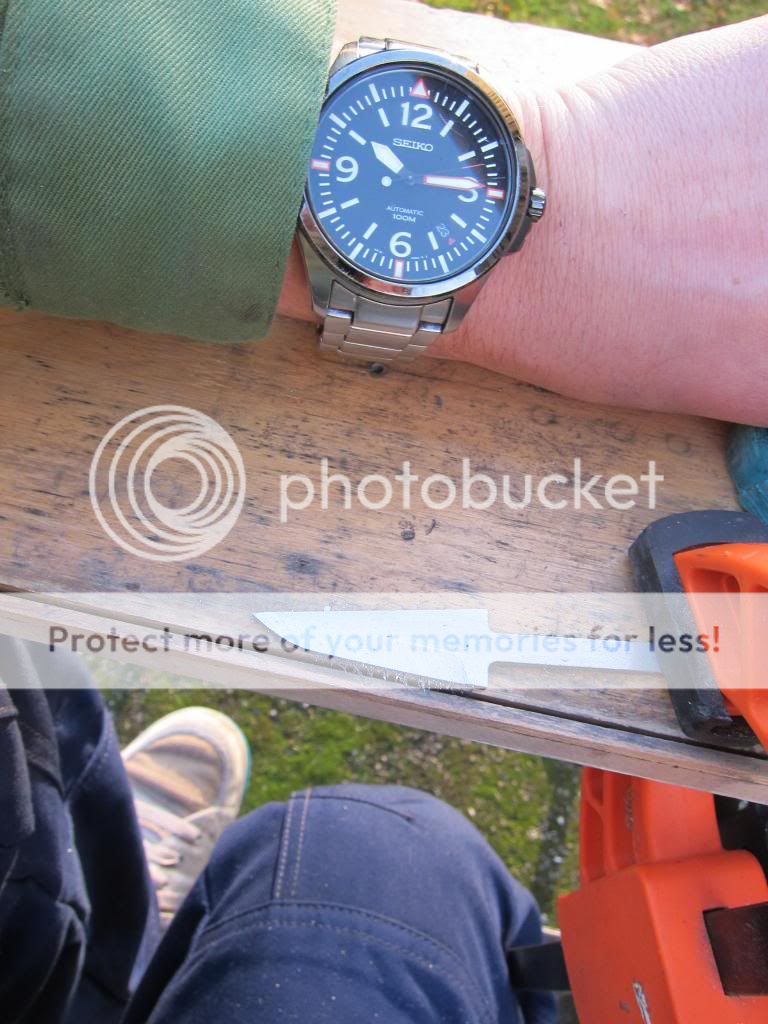

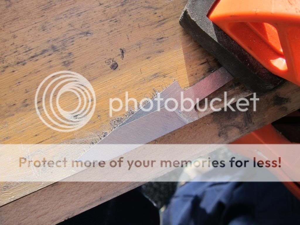

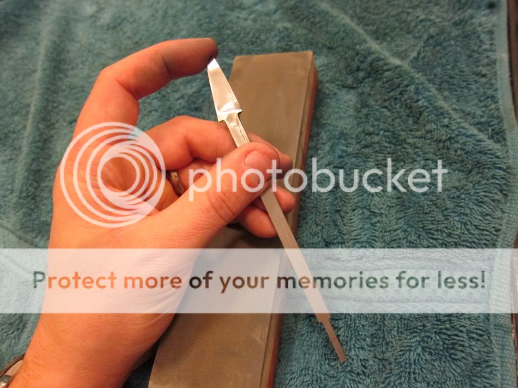

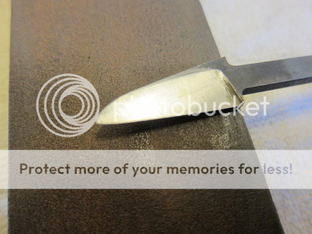

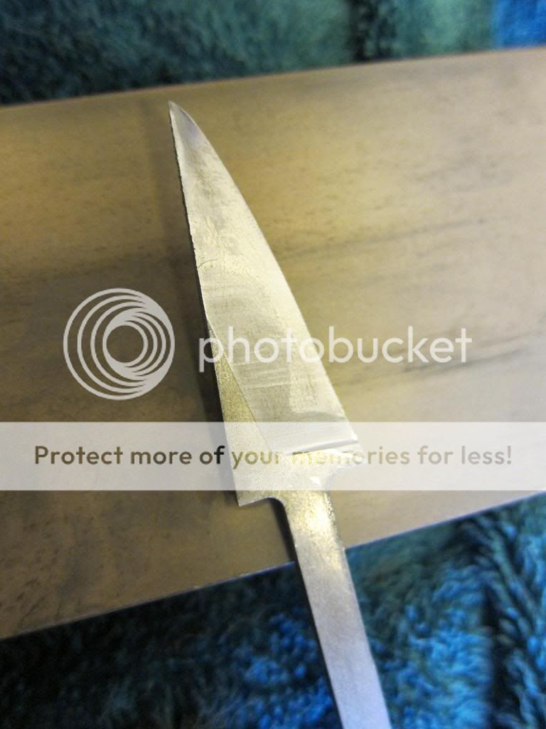

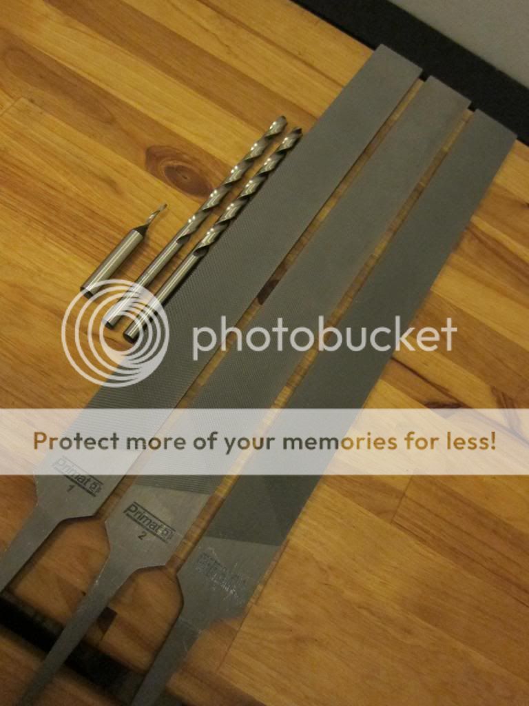

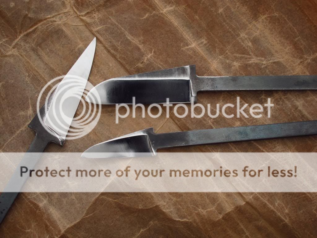

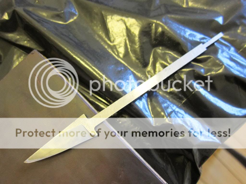

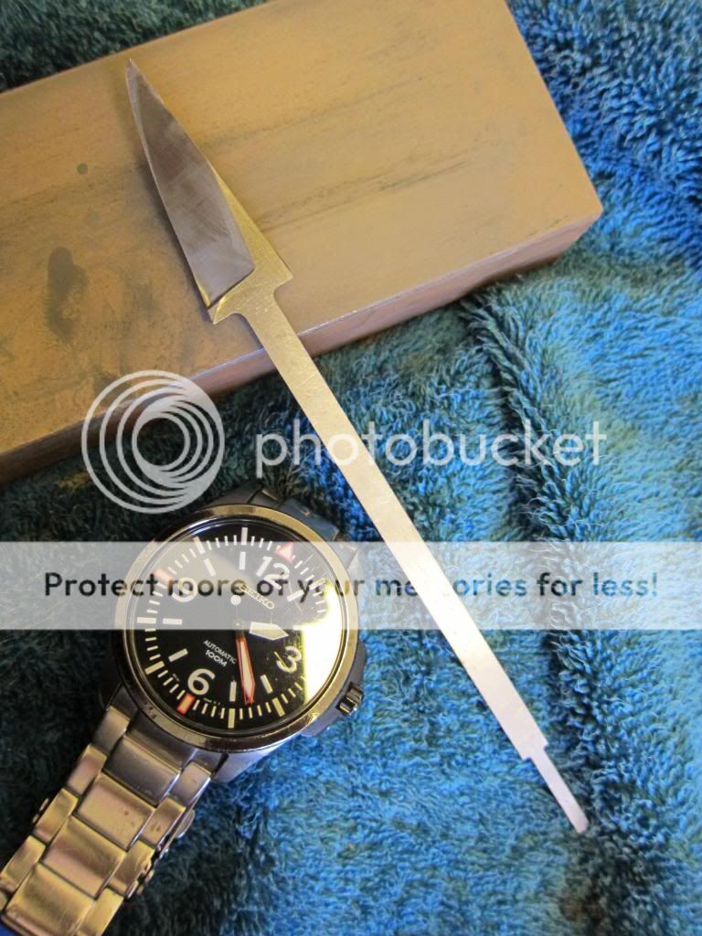

This is a test knife. Got some things right and some things wrong. I lost the shape of the edge but i got a nice ricaso. I think the file water-stone combination could work with a set of files coarse to fine to reduce the the work load on the stones.

The handle in the diagram above seems smaller than what would fit on the shaft a couple of photos up. Not sure if I'd want to have one with a larger handle or something smaller that I could carry around more often. Both options would be good though.
Thanks for the input! :) I'm thinking about using a full size handle even for the smallest blade shape.

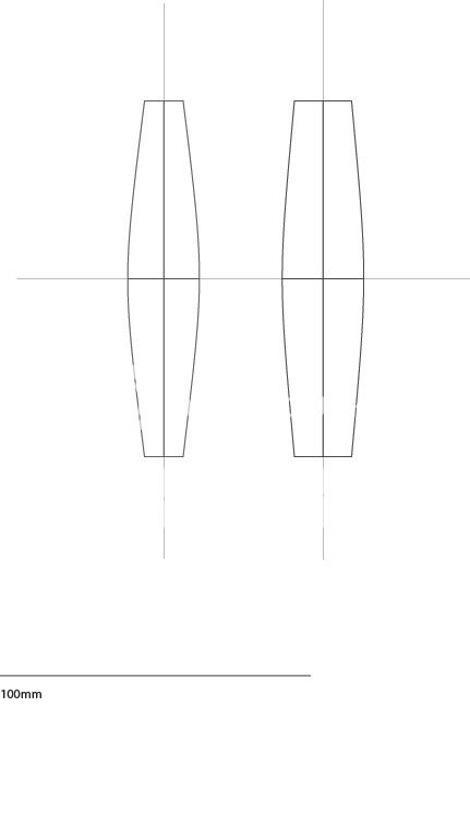

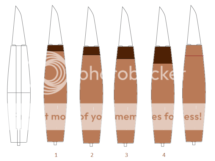

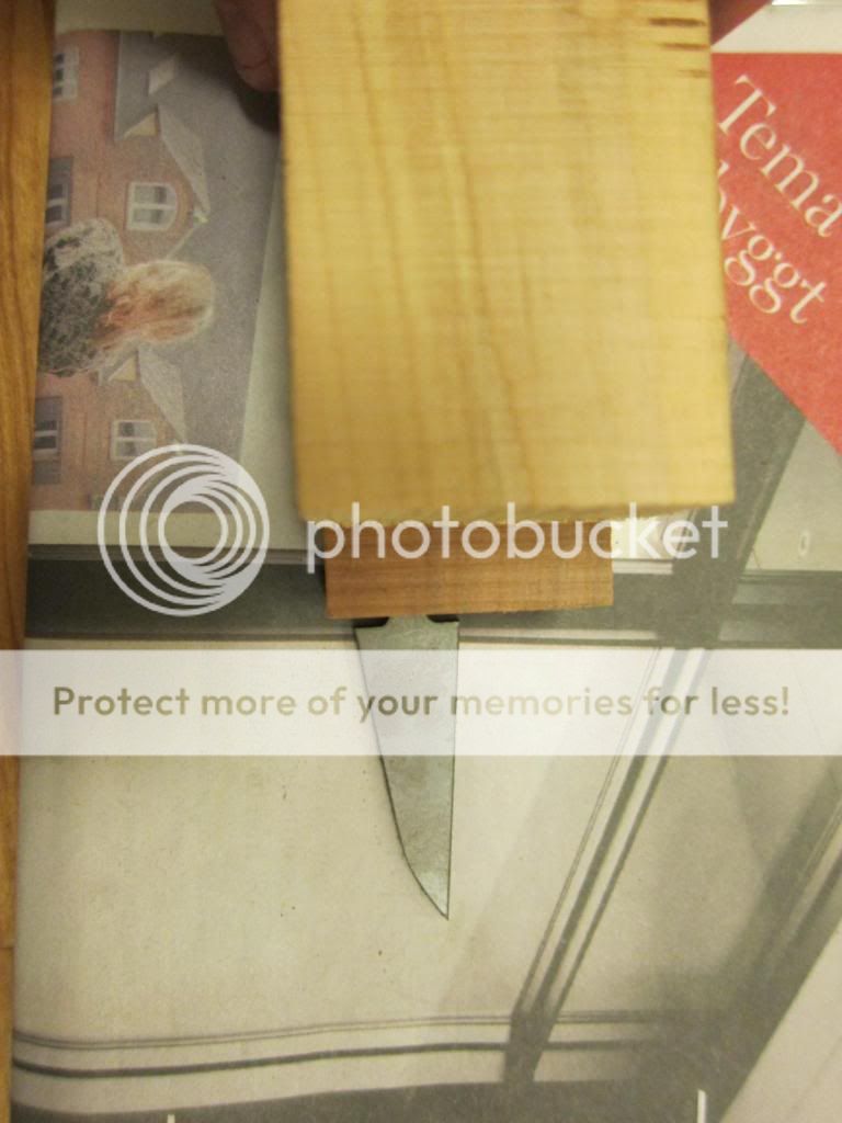

Right now I'm thinking about the proportions of the wooden bolster. Does any design seem more harmonious?

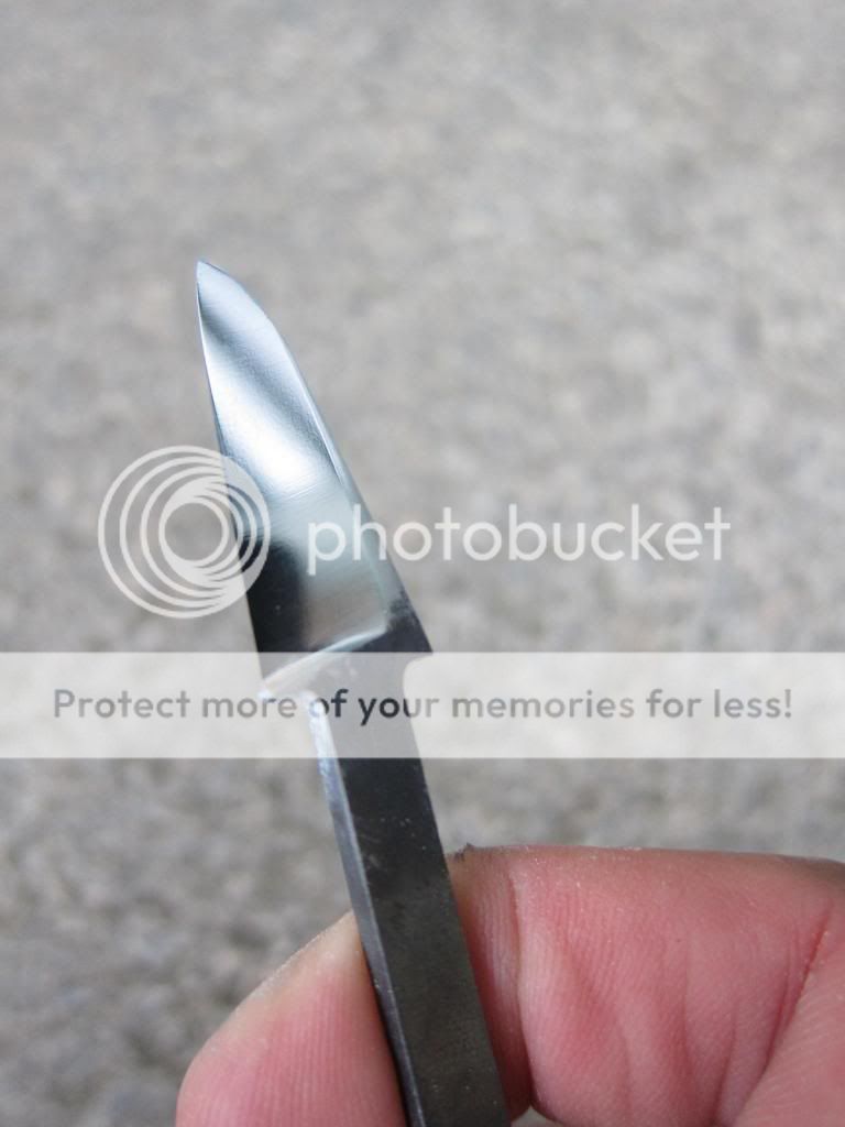

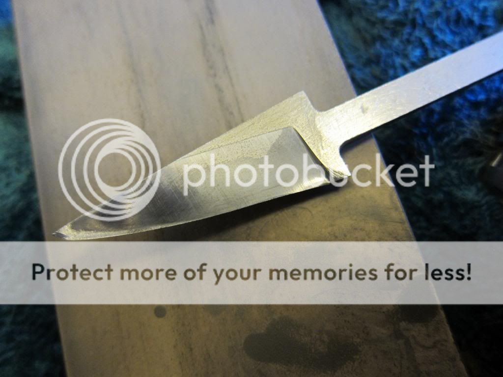

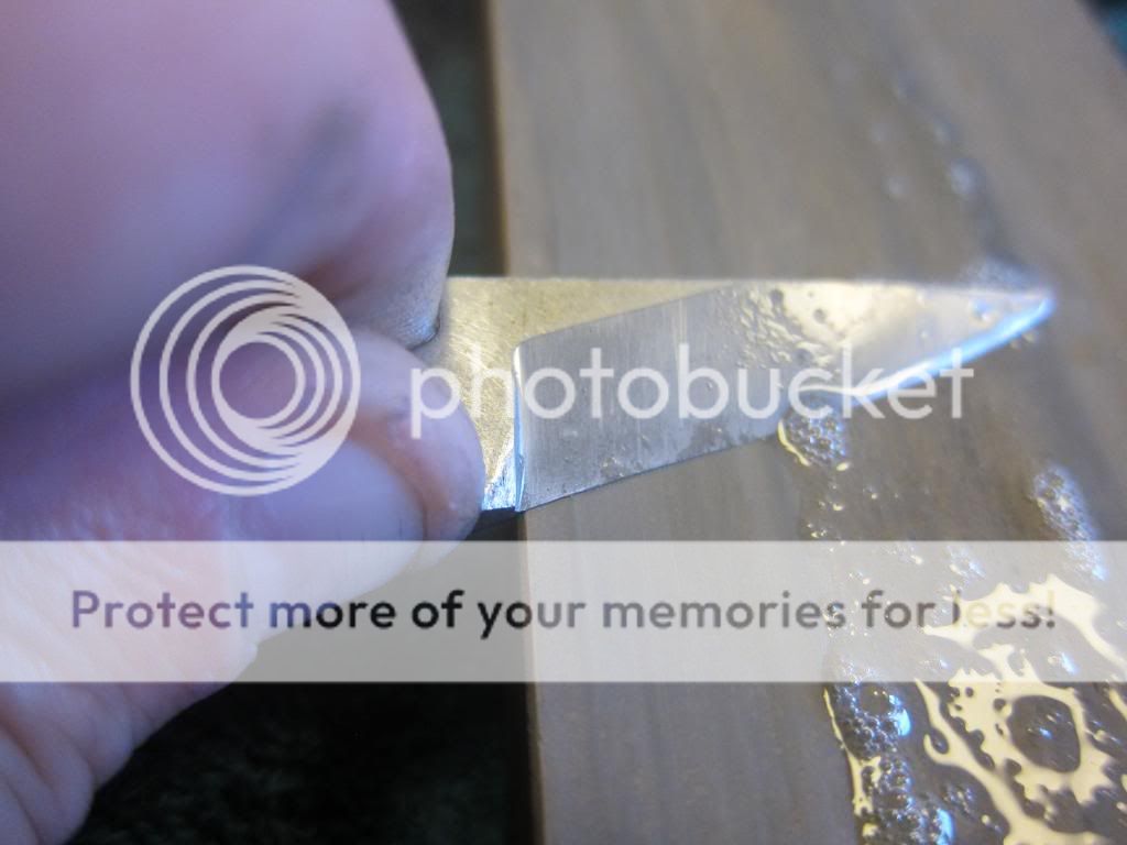

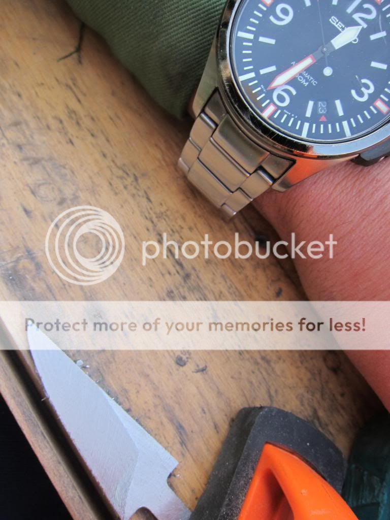

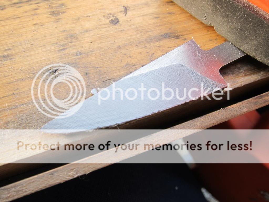

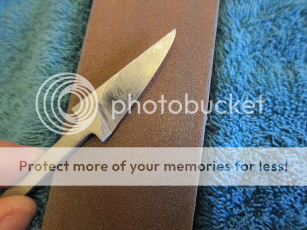

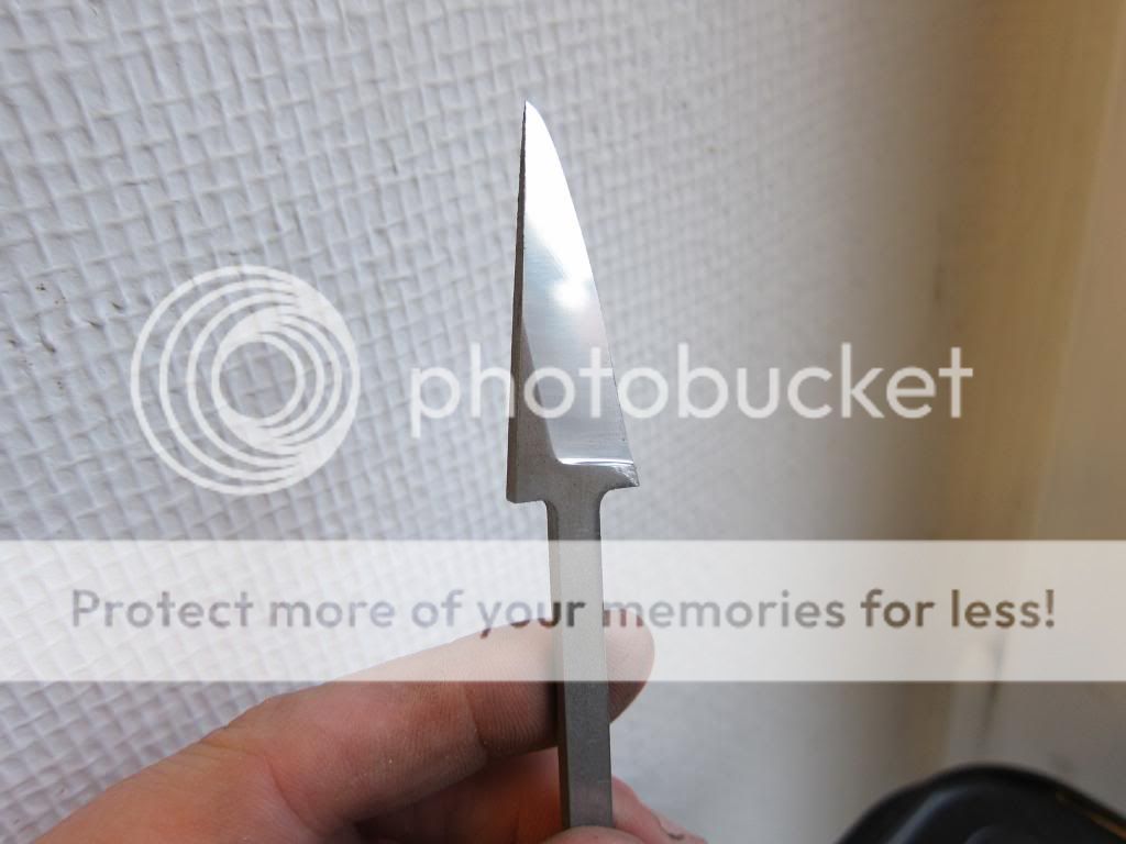

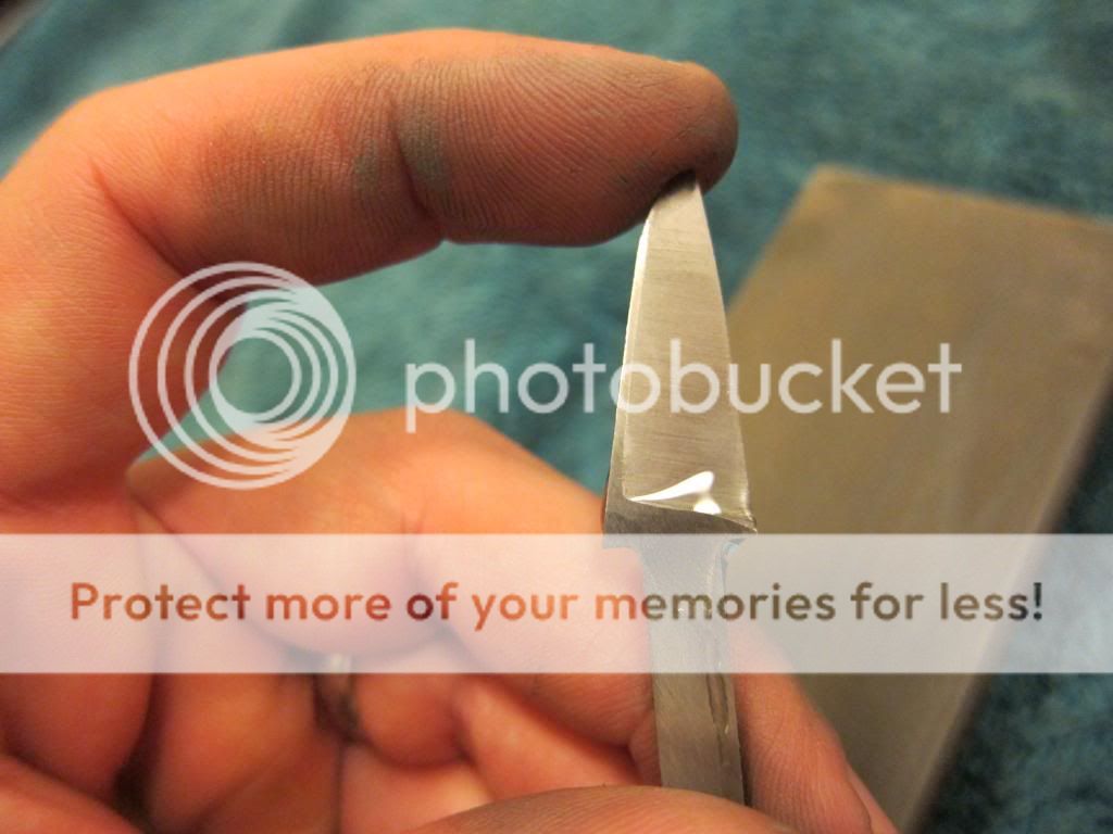

Today I had planed to start fitting the handles but it did not feel right. It felt like I was pushing forward not being quit done sharpening. The smallest sheep foot had a flat spot in front of the ricaso and the two larger blades had a some what uneven finish.

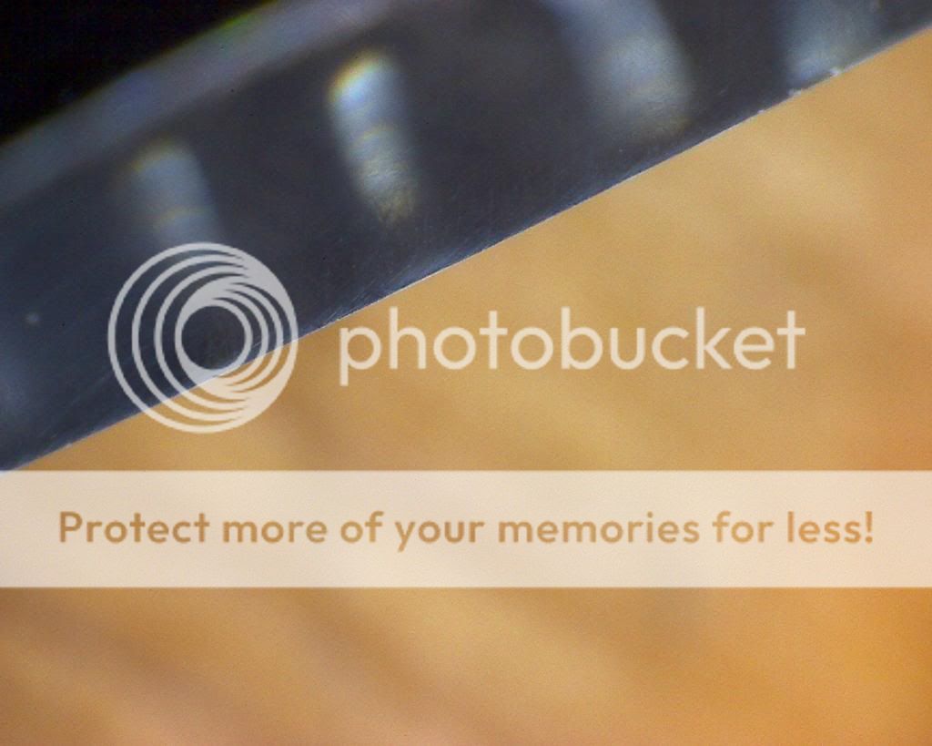

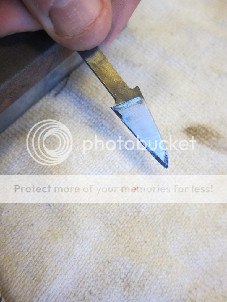

Ink showing the hard to reach spot.
Finally got it.

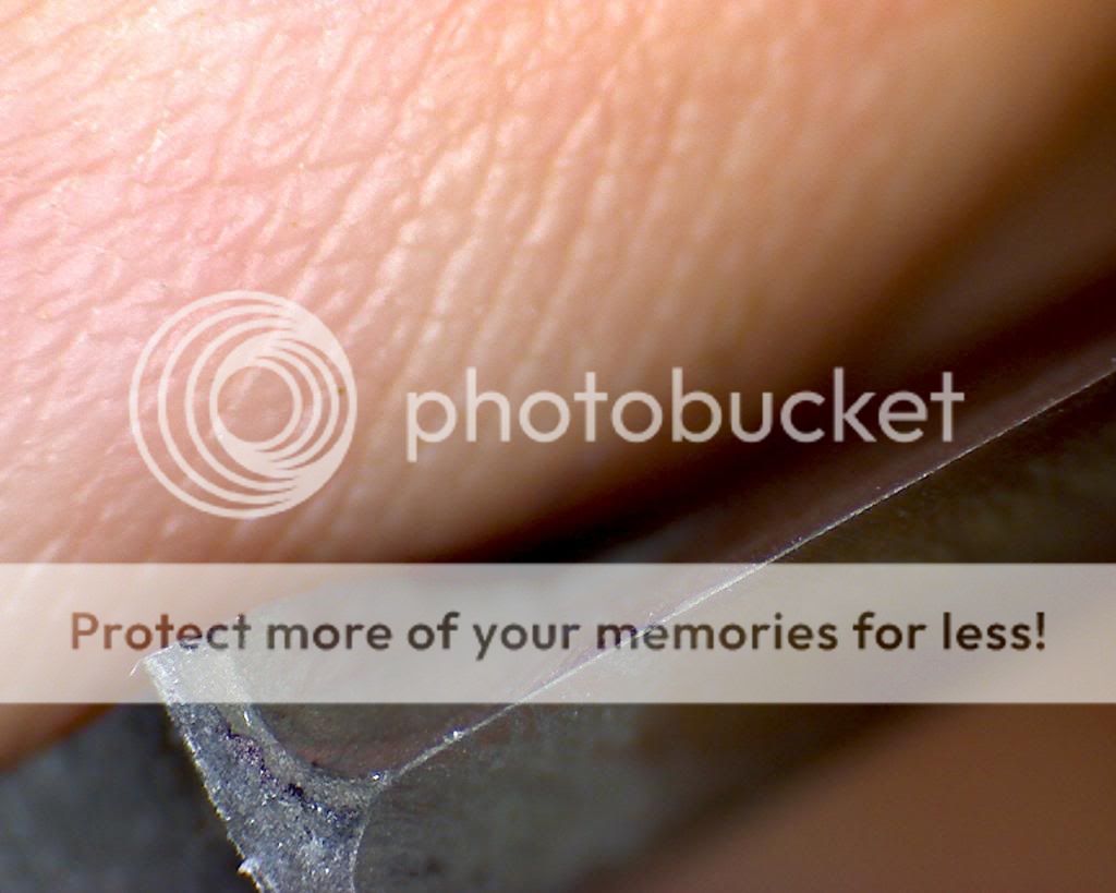

I used 800 an 6000 grit water stones an autosol polish on a leather strop today.
These are test blades so i will stop here.

The votes for the thickness of the bolster is in.
#1 one vote
#2 three votes
#3 no votes
#4 one vote
#2 is 10mm bolster on a 115mm handle is the winner. :)

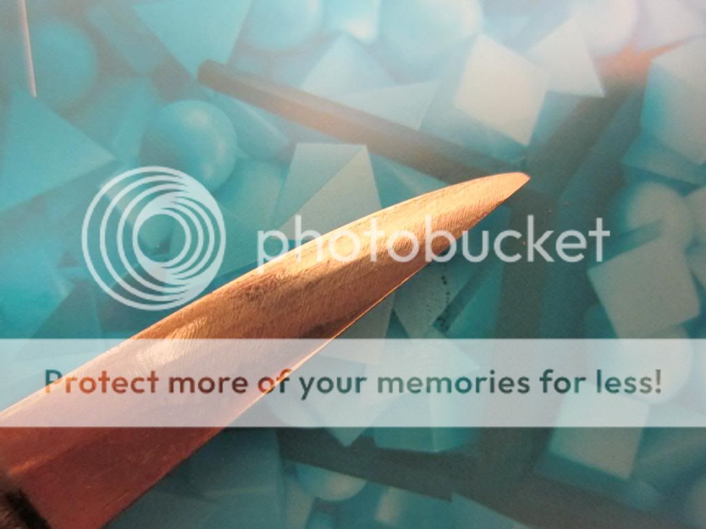

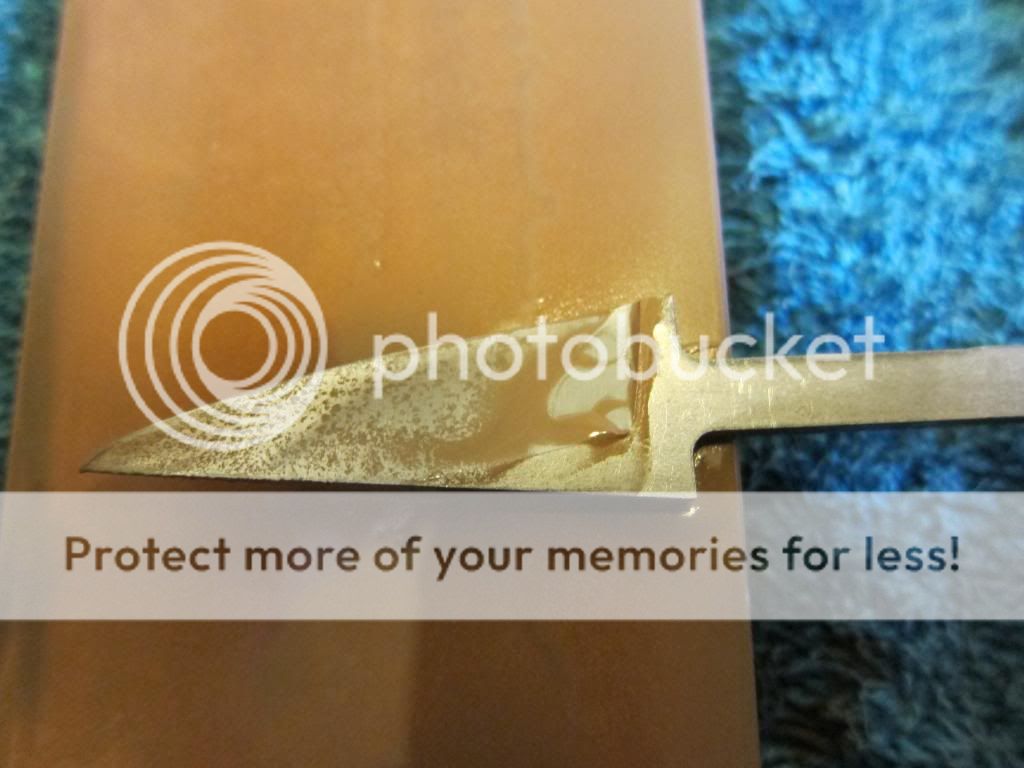

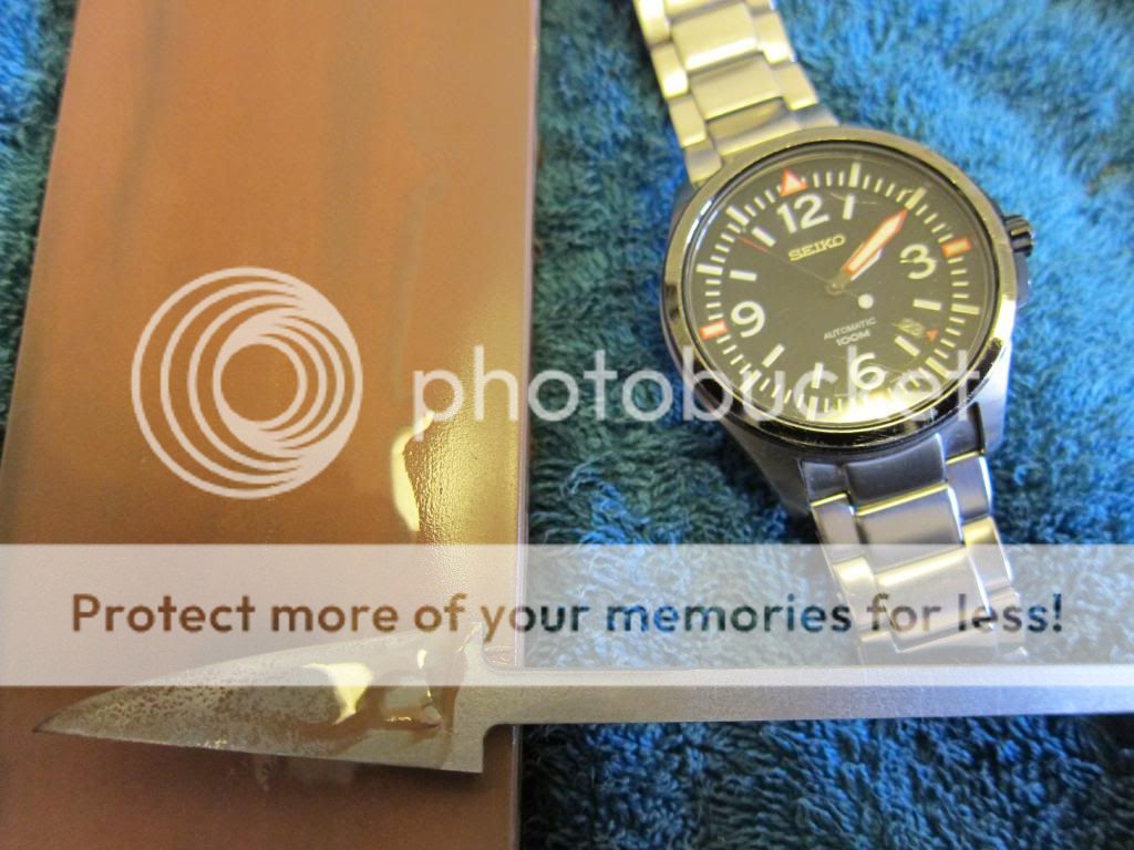

An experiment, fine file straight to coarse polishing compound. Its just an experiment but it looks kind of cool.

For the bolster, I think 4 looks similar to the wooden handled Mora knives, though 3 seems a little better to me. Then again, 1 could be cool. Probably would just say "surprise me" if I got one, too many choices!
The pic right above is promising. Seems like a fun/useful knife for the detail work.
