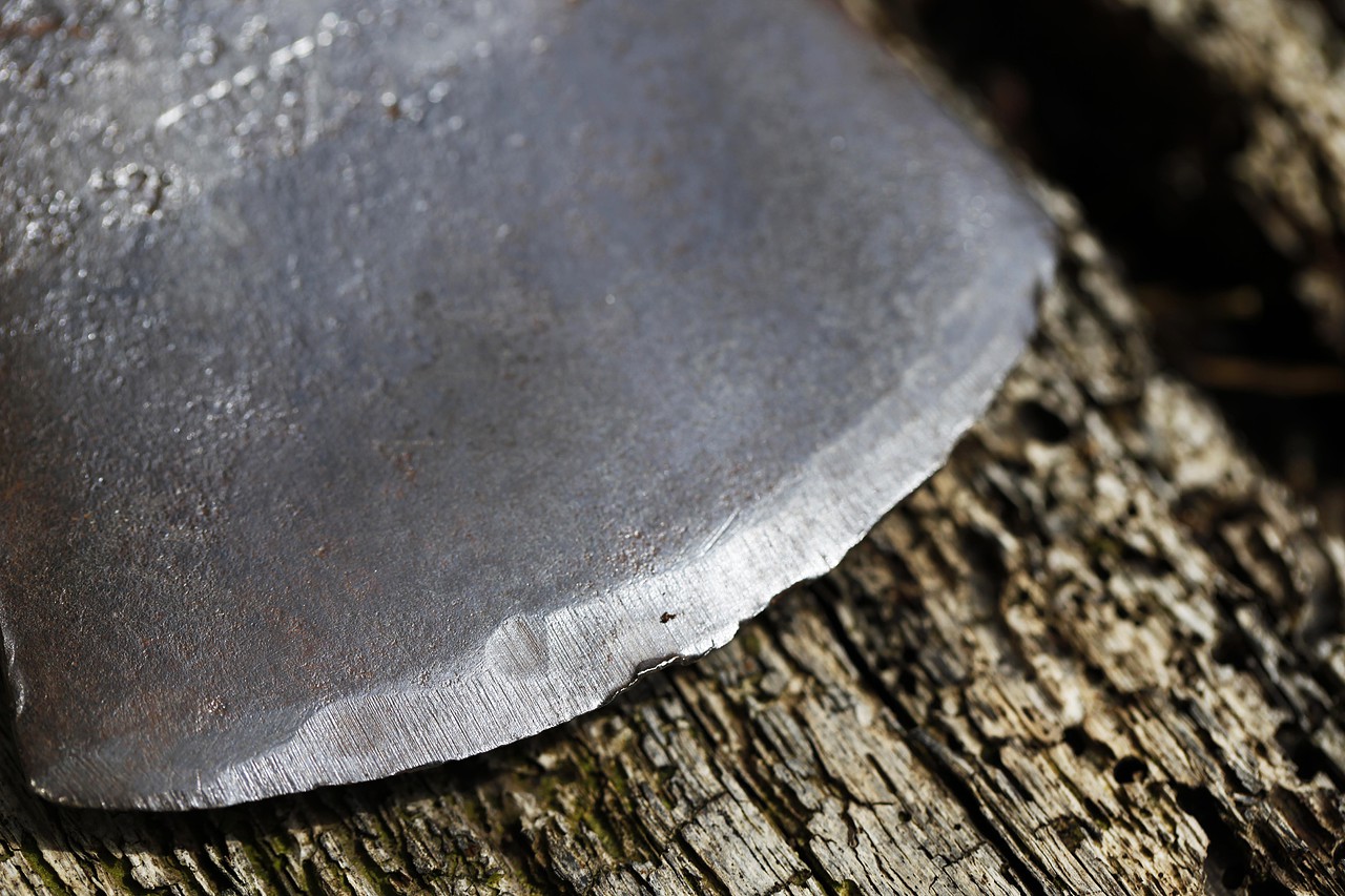

Nope, but it has to be tempered with 10XX steel, I wold suspect. CT says that the do not harden the eye on their Velvicut axes, but they may be able to have them hard enough from a little bit of "air hardening" because of the chromium content. This picture shows what a shallow harding steel like W2 looks like when you anneal it. That blade was a hair under 3/16 at the ricasso and all of those bends were done by hand with the blade in a regular bench vice. with no cheater bar used. ;)
It's not hard to temper back an eye.

Old North American made axes (U.S. & Canada) tended to be made with bits of higher carbon steel than current makers use (both U.S. and Swedish makers). The increased carbon makes a blade or bit more hardenable - -i.e. it will quench to a higher RC hardness - and also tougher, giving it more wear resistance.
In the hardening and tempering process steel is first quenched to a very high hardness - often too hard (brittle) for the final tool. It is subsequently tempered - reheated - to remove some of the brittleness and add toughness. The higher the heat used in the tempering process the more hardness is lost but the more toughness is gained.
Generally speaking, higher carbon steels retain more wear resistance than lower carbon steels when both are tempered back to the same RC hardness. So there is an advantage to using higher carbon steels in an axe bit - increased wear resistance.
Current Gransfors Bruk axes are made will a steel very similar to 1055 steel - containing .55% carbon - on the lower end of what are considered high carbon steels. Vintage N.A. axes were commonly made with bit of higher carbon content. For many years the U.S Forest Service specified that axes would be made from "fully killed plain carbon AISI/SAE steel containing 0.72 to 0.93 percent carbon". It was known that this higher carbon steel produced better wear resistance than lower carbon steels. Agricultural steels like plow disks and harrows were similarly made from higher carbon steels like 1080 - .80% carbon for the same reason.
Bottom line, a top shelf vintage North American axe will be made with a higher carbon bit than current Swedish import axes and the vintage axe will have better edge retention and wear resistance.

The bit of that axe is as soft as iron, a friend of mine has had to heat treat it again. It's very usual to find refitted vintage axes nowadays, I don't like it. You can clean all the marks of the axe I have shown and you won't know your purchasing mistake till you try it in the wood.
If you want to find that type of quality in actually produced axes, the best you can do is to stick to old school axemakers. Council Tool is a good option, same as Jauregi or Mueller. I have seen the heat treatment in those companies, CT and Mueller in videos, and they use old school techniques. You won't find bad steels in the companies we are speaking about, proper heat treatment is more important than steel in an axe.
About steels, at same hardness higher carbon steel is not better. Between the most important qualities of an axe is its toughness, an axe at more or less at 55HRC and with more or less 0.5% of carbon is at the best point it can be for a general use. The same can be said about alloys, the less alloying elements you can give to a steel mantaining the desired quality, the best axe you are making. A clear example of this are the racing axes (I'm speaking about my experience, those used at Basque competitions and trainings), people tend to think their steel is a superalloy, this is not true. They tend to be medium tool steels with very well studied heat treatments, as an example their carbon variates but tends to be 0.6-0.65%.
