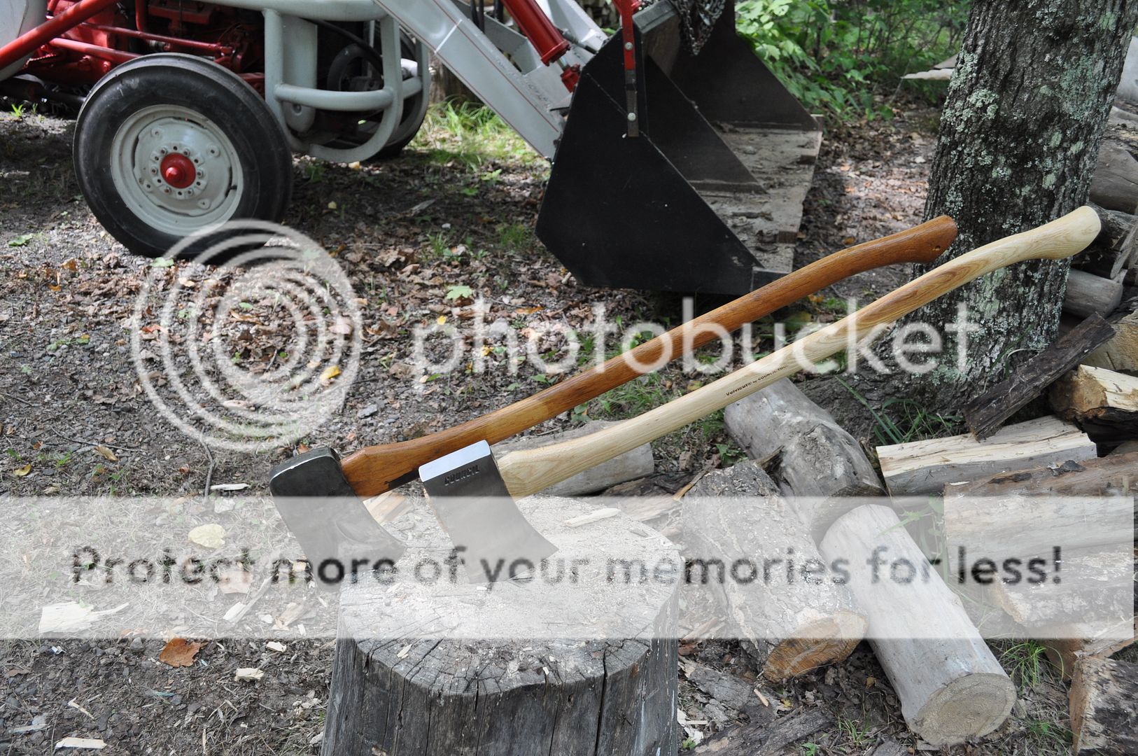

The Plumb seemed to have a slight edge on the CT.
[URL=http://s810.photobucket.com/user/doubleott/media/Council%20Velvicut%20Plumb%20Cedar/KellyPerfectvsCouncilVelicut006.jpg.html][/URL]

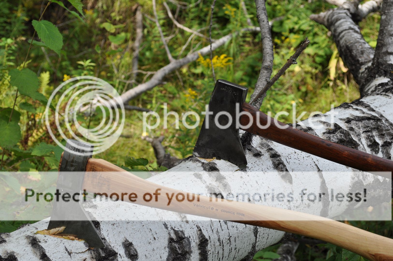

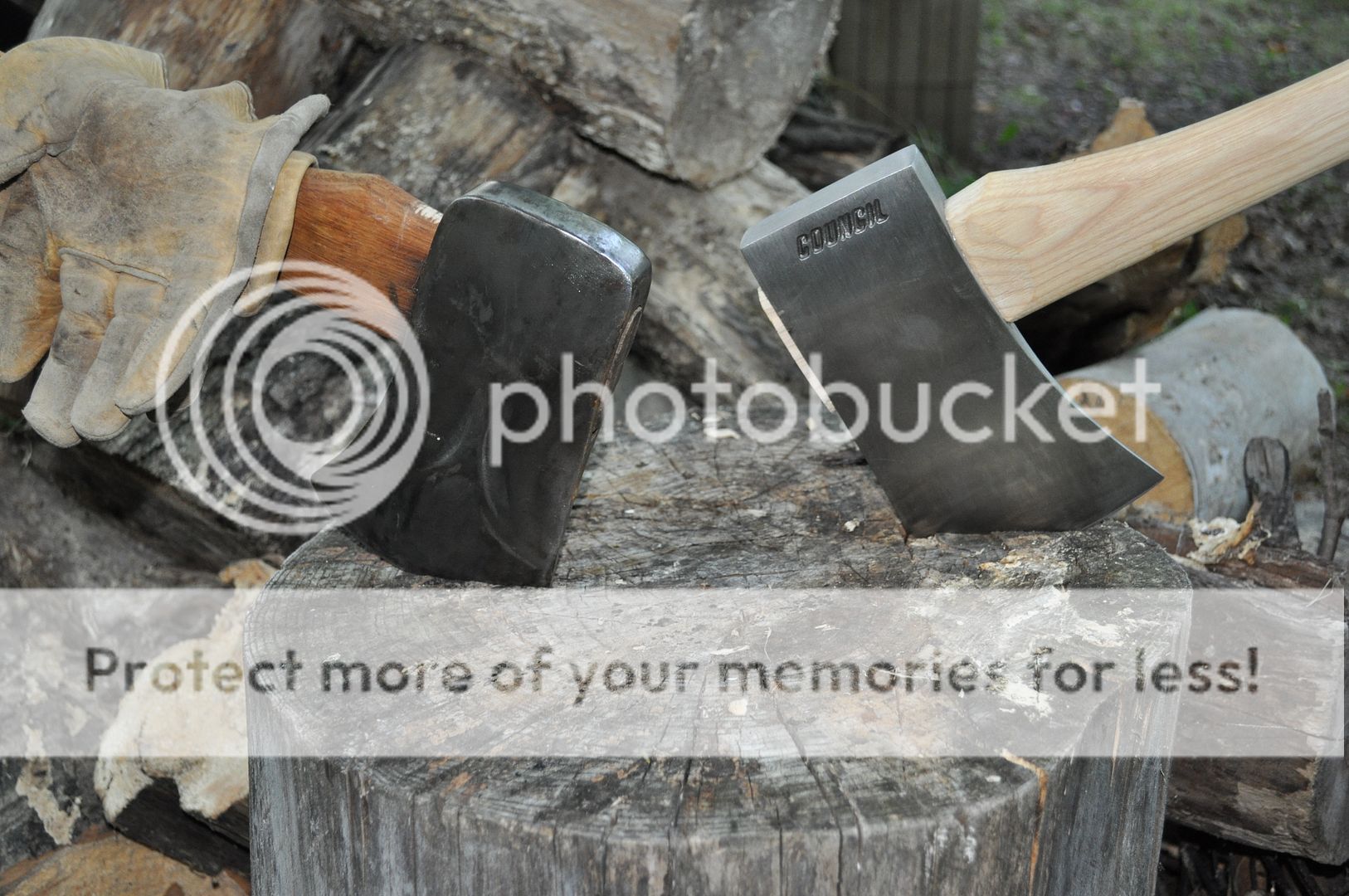

It was a draw splitting with a Kelly Prefect and a CT.
[URL=http://s810.photobucket.com/user/doubleott/media/Kelly%20Perfect%20vs%20Council%20Velvicut/KellyPerfectvsCouncilVelicut003.jpg.html][/URL]
[URL=http://s810.photobucket.com/user/doubleott/media/Kelly%20Perfect%20vs%20Council%20Velvicut/KellyPerfectvsCouncilVelicut010.jpg.html][/URL]
