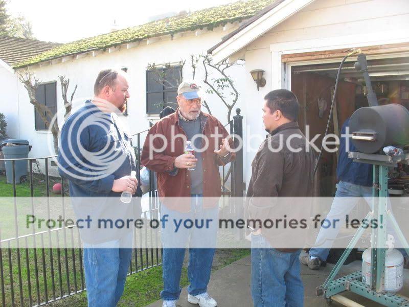

Mark Wohlend, Mike Vagnino and Ray Laconico sharing some tricks of the trade..

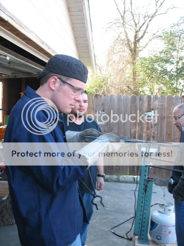

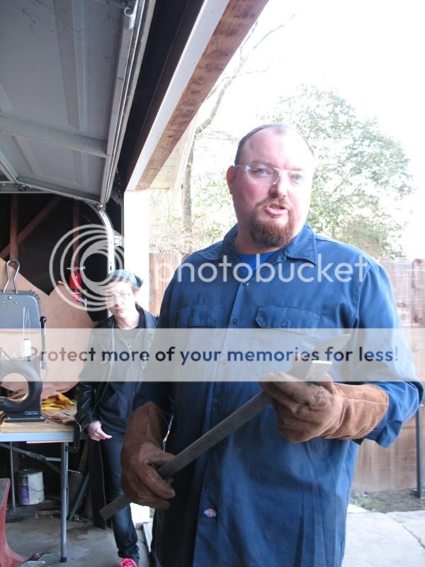

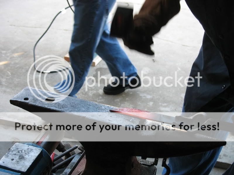

Mark at the forge..

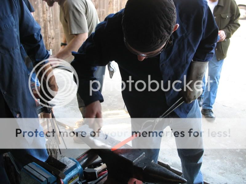

now Christians turn..

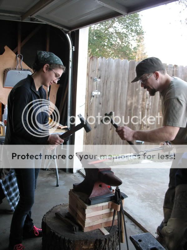

Cristof and Sierra hammering away..

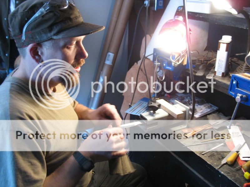

Christof sanding the colab. knife..

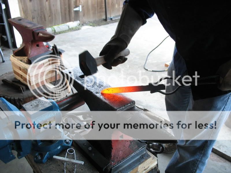

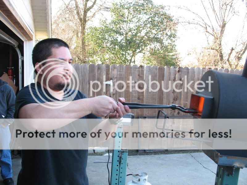

Ray doing some forging..

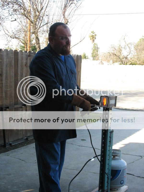

Mark hammering away again..

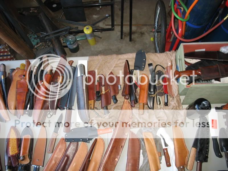

lots of knives to look at and drool over...:D

What is the small forge? Is there a link to making it? I would like to make a forge but I don't need one like the large one in your pictures. Thanks
It is a soft firebrick. Drill out the center all the way through, long ways. then drill a hole roughly center, to a little forward of center of the brick and as high as the bottom of the long ways hole. That's it!
The brick is real soft and easy to drill or dig out. I'd use an old spade bit, or you can even use a butter knife, I've done that.
The rest of it is just a stand to hold the brick and the propane torch, but you can accomplish that in a number of ways.
It's basically the one brick forge from Wayne Goddard's $50 knife shop book. I love the way it has been mounted, really kick butt.

Now I wonder if Freud would have something to say about the fact that Sierra was swinging a bigger hammer than Christof....just sayin'.

The small forge is based on Goddard's one brick forge. You can contant Wayne Goddard directly for the book, or find it on the web. If you Google the 50$ KnifeShop you can find lots of places to get it. I have forged for years using the one brick forge. It is great for blades up to 6 inches (I have done 12). Firebricks are very fragile so I welded up a steel frame out of some plate steel. The brick will slide in and out with the idea being the frame gives alot of support to the brick so it last longer and the brick is easily replaceable. I welded the frame to some other scrap steel to make a post and the two short 2 x6 complete the base. The propane tank sits on the 2 x 6's to make a counter weight.
