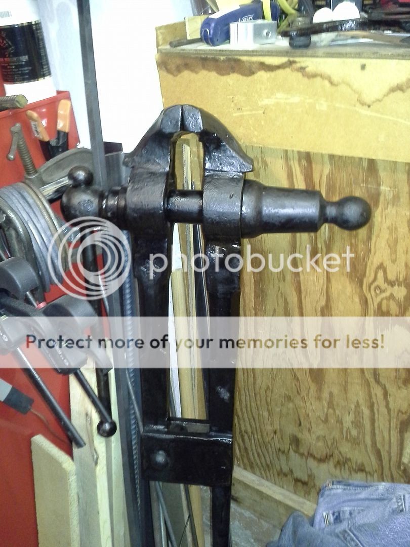

So, I drove out and met a guy about a post vice. Been wanting to find one that was usable yet not for what some of them are listed for. He ended up being a really good character and the vise ended up coming home with me. I think it was a worthwhile purchase and I'm really looking forward to setting it up either in my garage or maybe sinking a post of sorts outside. Somehow I think it's going inside because I plan to use it as much as I have time to - and my covered area outside is limited.
Thanks again for the advice on what to inspect  especially Square_peg and jblyttle for putting it in laymans terms. I mentioned this thing in the It followed me home thread but I dont want to ruin that one so I just started another one.
Here is my initial take on it (using my new checklist):
The screw threads are unpitted, clean, and they look close to square.
The box doesn't seem to be damaged in any way or have any evidence of repair. The screw mates up easily on initial threading and stays tight. No real play in them until the screw is close to unthreaded. I assume that is part of the design so the jaws get enough relief close to being fully open. It does have the split style mounting brackets.
The spring is different than I've seen in pictures/old ads but honestly, I've only seen 3 in person (this makes 4) and pictures we all have access to. It could already be a leaf spring or mal-adjusted but it certainly seems pinned tight in there but the retention tenon does have a little wear on it like I would expect from removing and reinstalling  tool marks. Maybe that is what they looked like when they went out  dont know. The jaw readily "wants" to open upon release and it tracks the screw tightly. It is actually very, very smooth.
The donut doesn't have any functional issues but Im not sure I'm looking at the original donut. Is that what you are describing as an automotive throw-out bearing?
The foot isn't abused:
The jaws are about 4 5/8".
It is marked with a 60 as weight. It is painted black but it does have one visible makers mark.
This picture is terrible to make out the marking under the paint  even with chalk. Without stripping the paint off of it I can only see more of it tilted just right in the light. It weighs 60lbs so I gave up trying to wrangle it into position.
Warren Tool & Forge Co., Quikwerk line of implements and tools.
Check the screw. The threads should have square corners - or at least nearly square, and no pitting.
The 'box', the part that receives the screw should be undamaged.
	The spring should function lively - though it's not a big deal for a blacksmith to replace a spring - prybars make decent replacements.
	The donut is the bearing between the crank and the body of the vise. It should be smooth not pitted. A pitted donut will seize up the vise. A pitted donut can be replaced with an automotive throw-out bearing. The throw-out bearings work nice and smooth.
