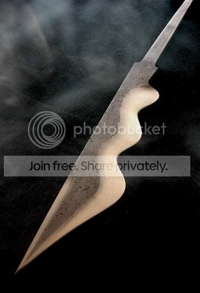

Here's my first blade for 2008.

Forge a stream along a straight edge
Clean it up with file and hand.......

what kind of grind is it? Flat?

It's slightly convex,... but not the type that I could get with a belt grinder! Ha Ha Ha
The darker flat surface shows the hammer finished texture.

I thought about doing a clay quench line, but decided I didn't want any artificial lines distracting from the forms and flow of it.
I ended up doing a full quench and tempering it down real good, with some extra on the tang.
I had to use some special rounded stones to hone it with. I'm sure before it's over, it'll taste a bit of my blood! Ha Ha Ha :)
